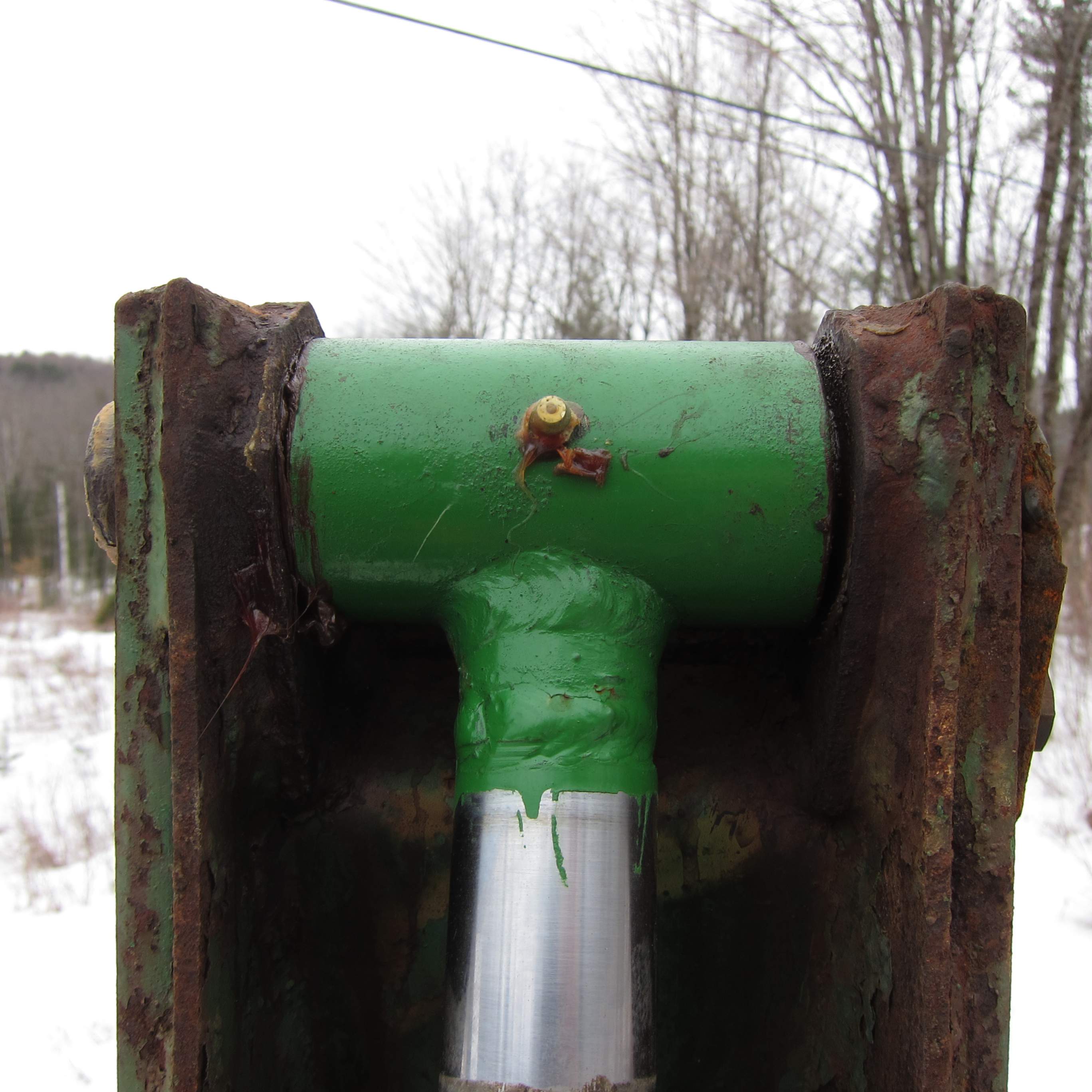

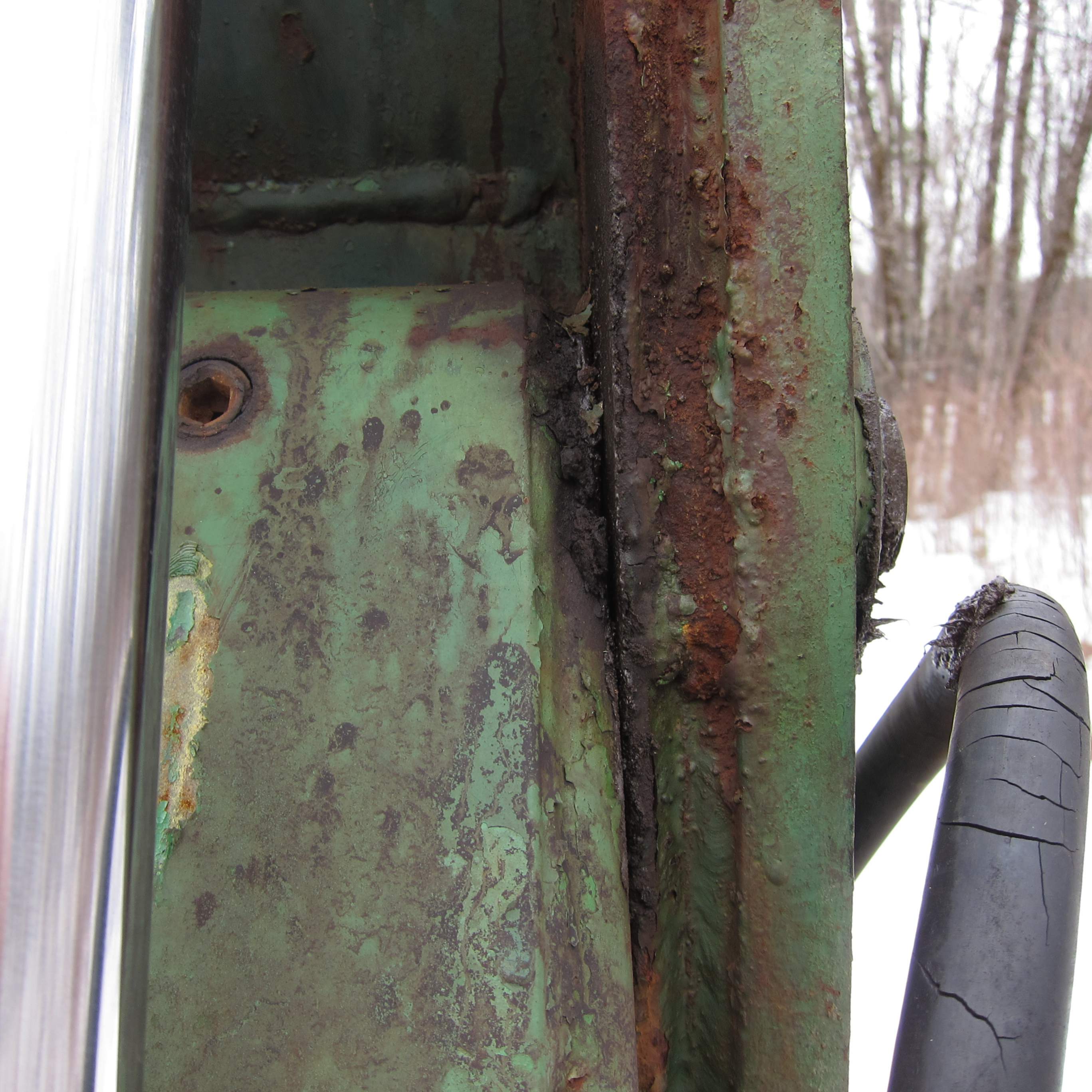

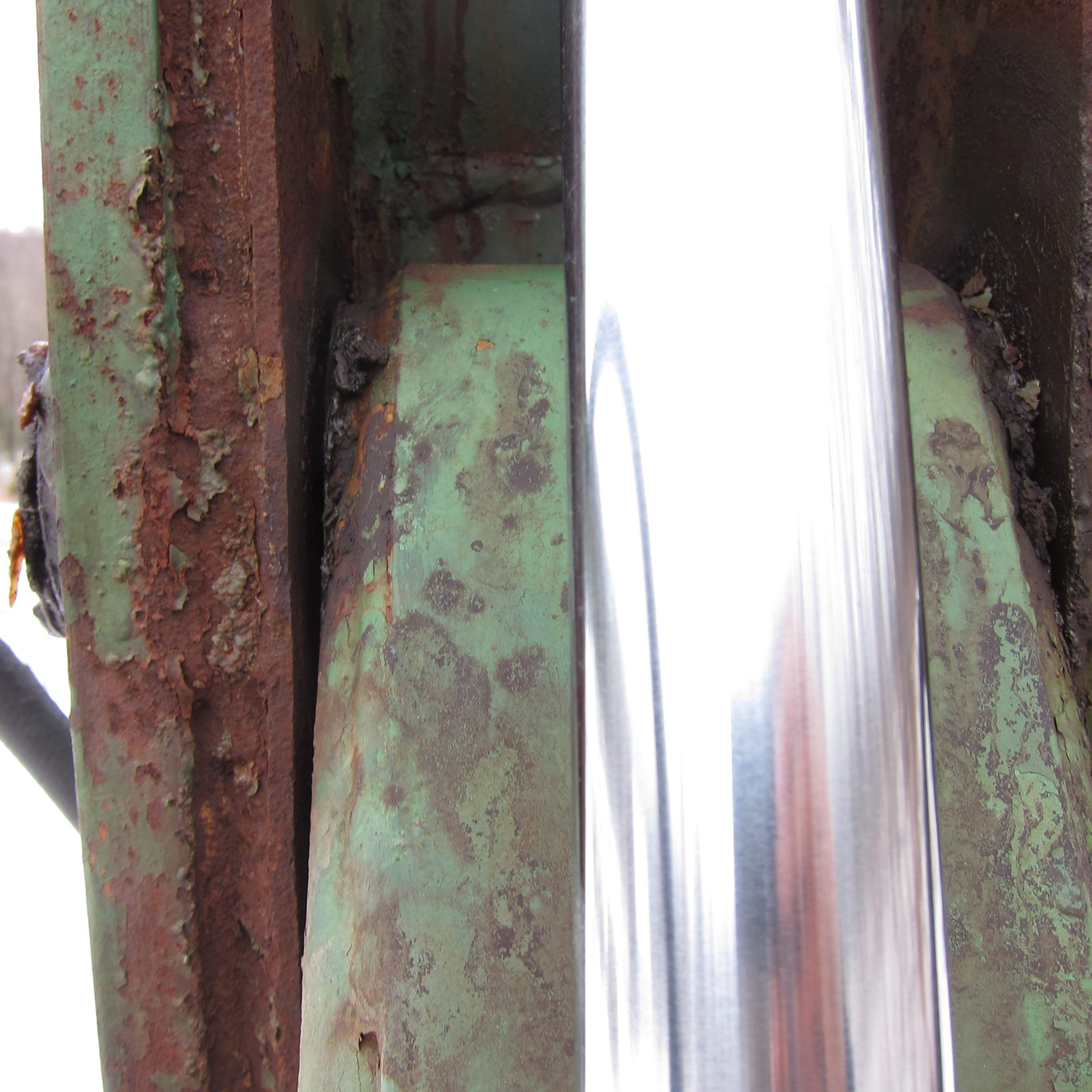

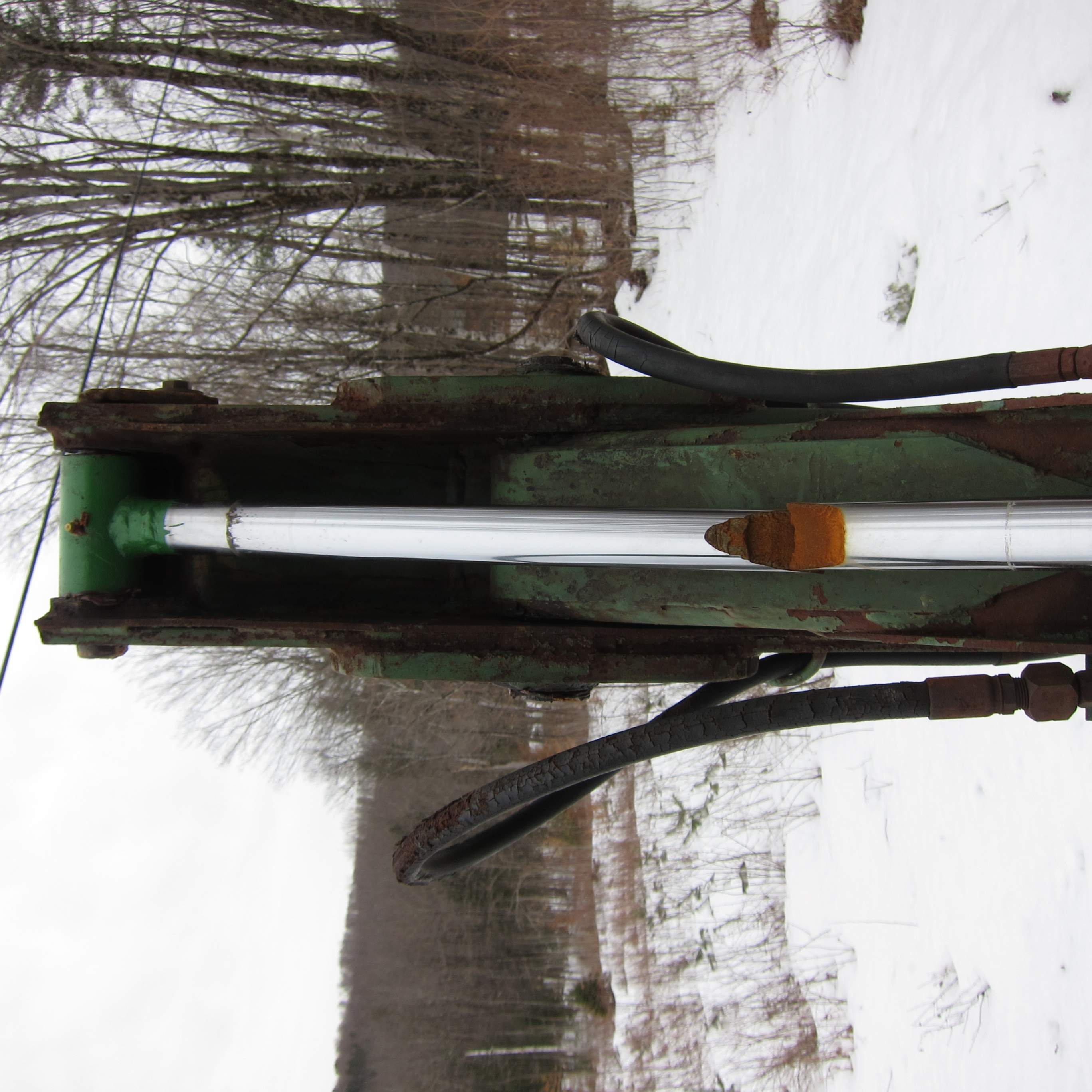

I checked the dipper arm and nothing seems to be awry as far as a bend in the frame, but the head of the dipper does look a bit askew. Only had this tractor a year and am still getting to know it, and what is permissible as far as play, tolerances, etc. And this is my first tractor, period! So here are some photos, hopefully you can see what I'm talking about. The head of the dipper piston rod looks a bit cocked in relation to frame on the dipperstick, and on either side of the (broken) piston you can see that there is more of a gap between the left side of the dipperstick and the boom than on the right side of the dipperstick to the boom. Perhaps the head of the dipperstick got bent, or maybe the pin that holds the dipper to the boom? or is that not a failure point? not the best light for pictures today, i'll try again when the sun comes out.

What does the other end of the dipper cylinder look like. Does it have a ridged mount or can it flex around a through pin?
