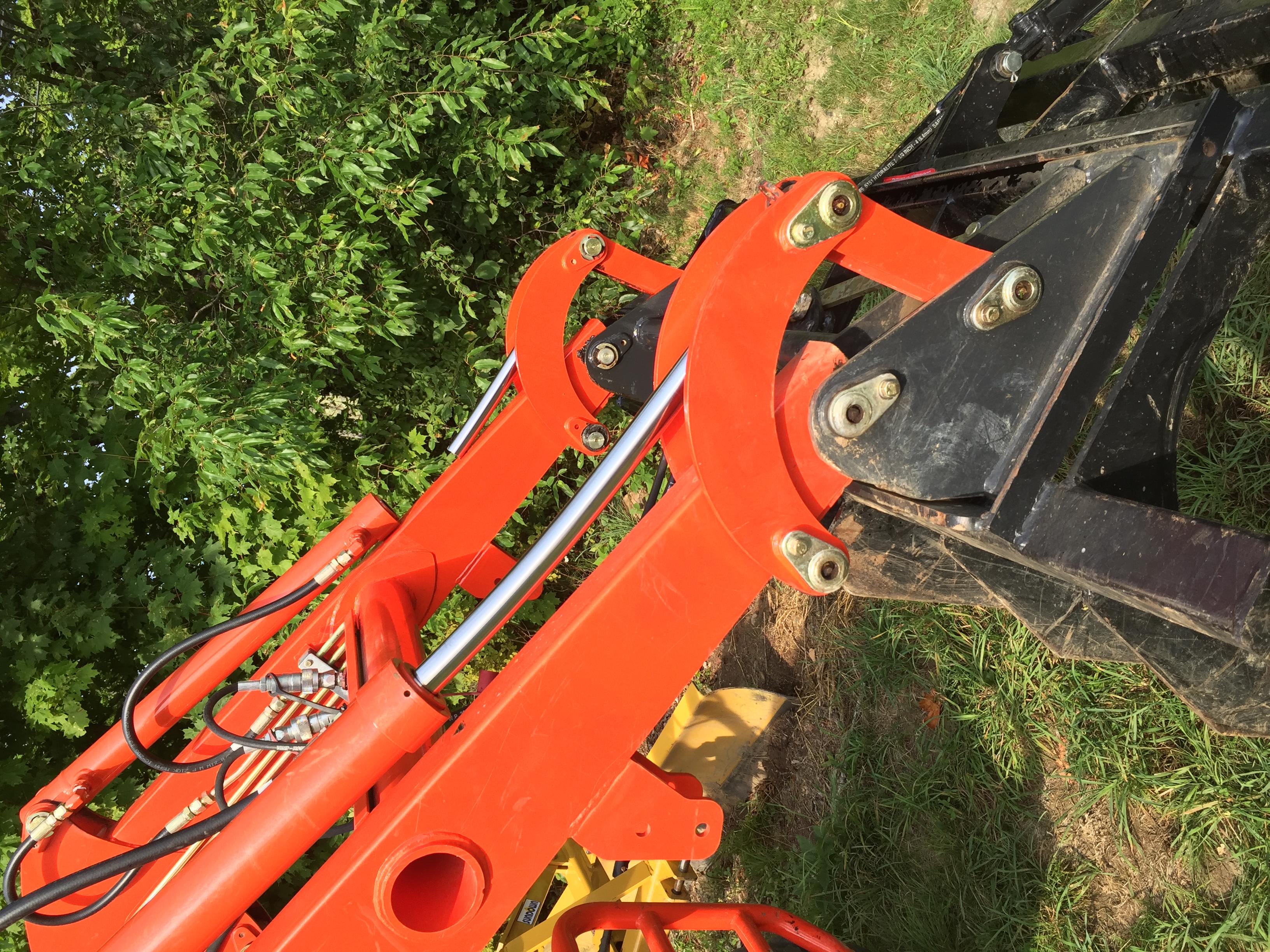

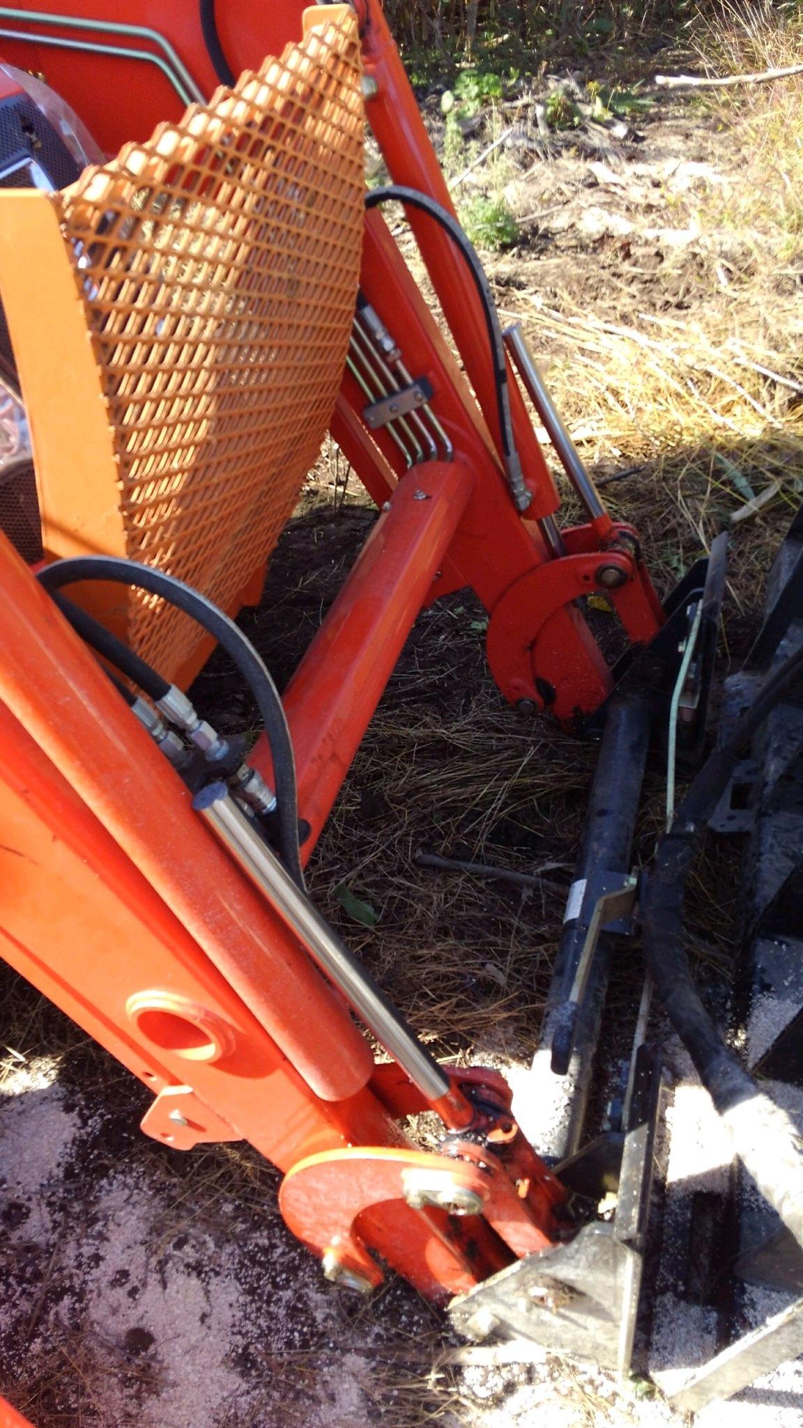

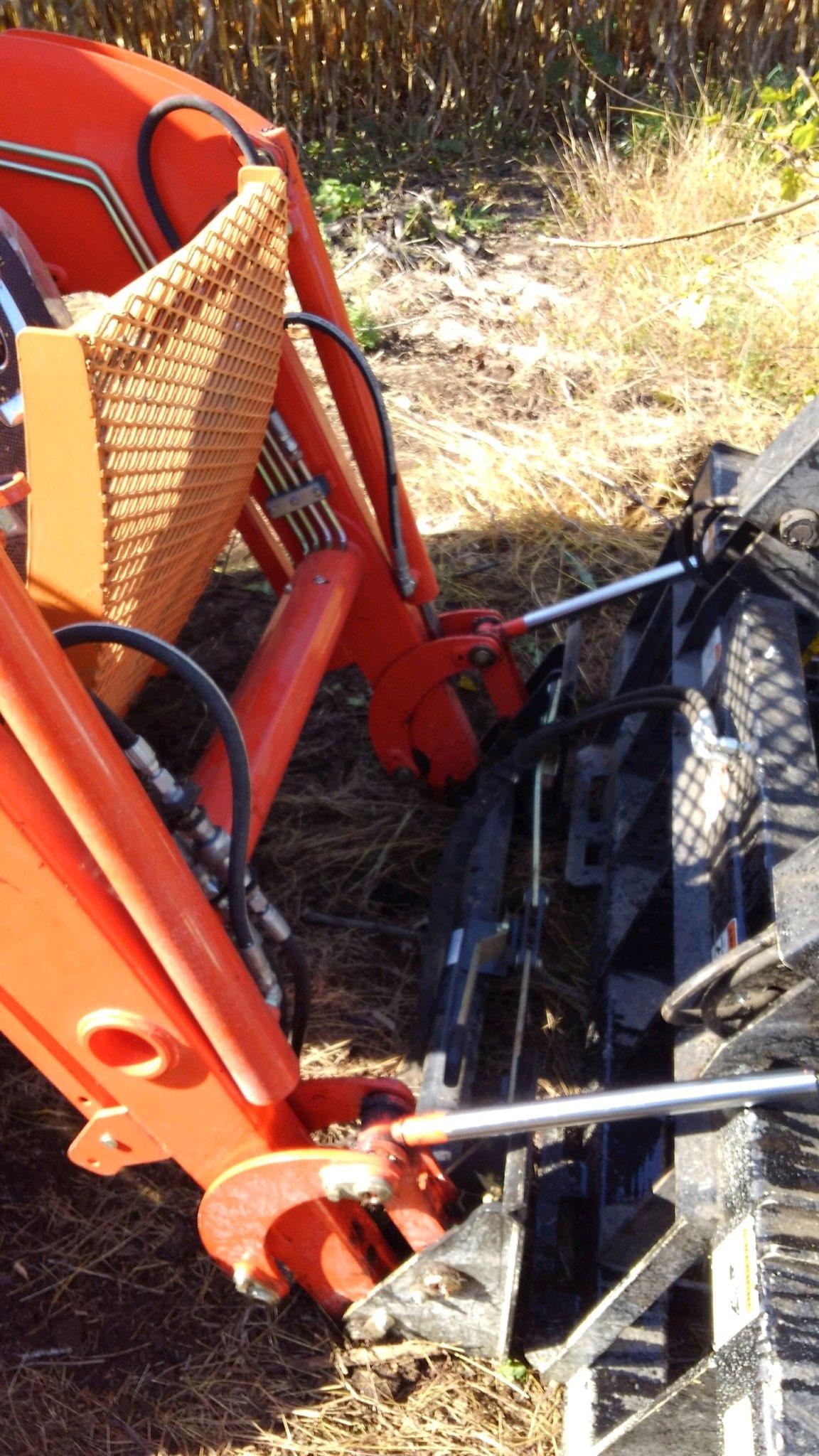

I had a buddy find the picture of my broken cylinders on his phone. I do have a picture of the pile but i have to find somebody that has that one since I do not. Check it out let me know what you guys think. Dealer though it was weird they both broke like that. Thanks
   / Broken Cylinder #2
looks like the threaded part broke off in the piston. picking up to much weight. Any HYD shop can replace the ram. No big deal really unless there is some damage inside the cylinder.
The HYD shop will need the broke end too so they can make a bushing for the bucket pin.

I would take the broken parts to a hydraulic shop, and ask them how they think this happened, and how to not have it happen again.
   / Broken Cylinder
The Reason why I was so upset about them breaking is because I was not doing any of the following things that where posted. I know you can't extened the bucket with the grappler down and drive forward. I also don't use the grappler for trying to gets roots out simply collecting brush. What happened was I drove forward into a small brush pile , hit the third function switch lifted up and all of a sudden I see hydro oil shooting everywhere. I get out to look and I don't see anybroken hose. I looked around some more, and then Seen the one cyclinder shaft broke. At this point I could see the weight all went over to the other cyclinder. I quickly got back into machine to slowly drop the loader to the ground, and bang the other cylinder let lose and everthing came crashing down. i can't even begin to tell you what a mess it made with the hydro oil spraying everywhere. The grappler weight is 585. If I recall I think it's made by Cleveland equipment. I think it's 68 or 72 wide. The only other attachment I for the front is the bucket that came with my machine. As for the back dragging I have a boxblade and a landplane for the rear that I usually will use when doing stone or dirt work. But I can see your point about using the front bucket and back dragging putting stress. Machine had I think 272 hours on it when this happen. I had a bobcat ct450 and never had this issues, but I do believe the loader was better. From what the dealer told me bobcat used there own loader and backhoe. The backhoe on the bobcat was way better then the one on my nx.
