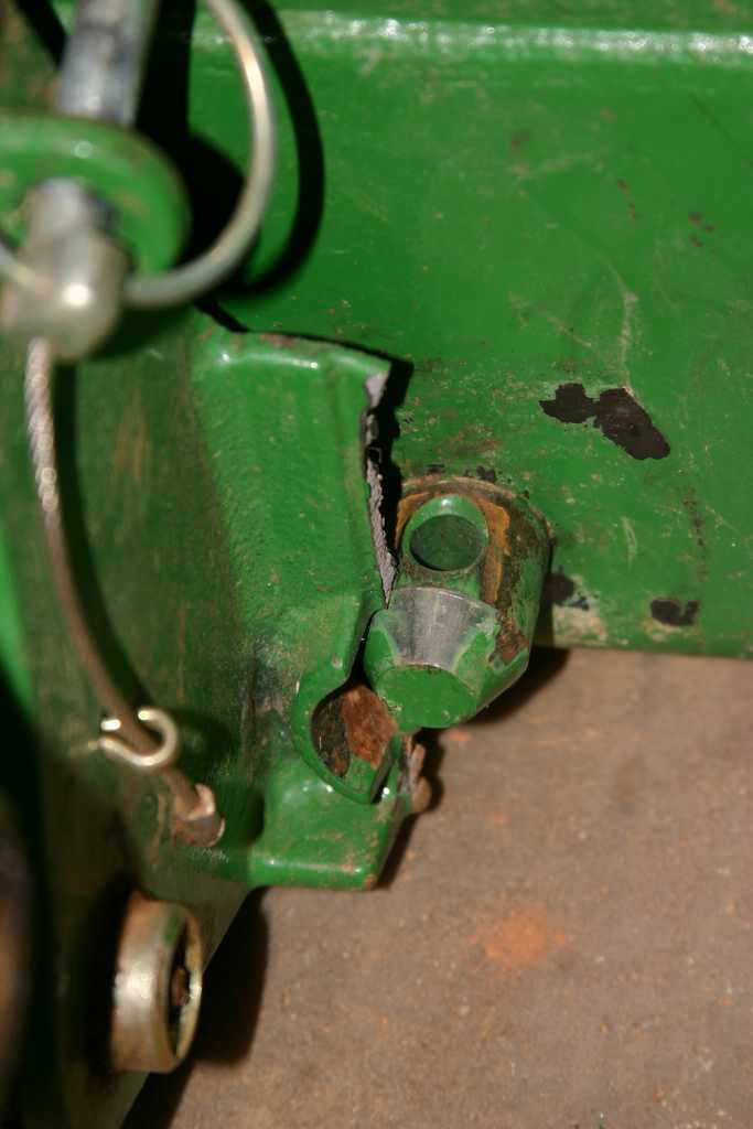

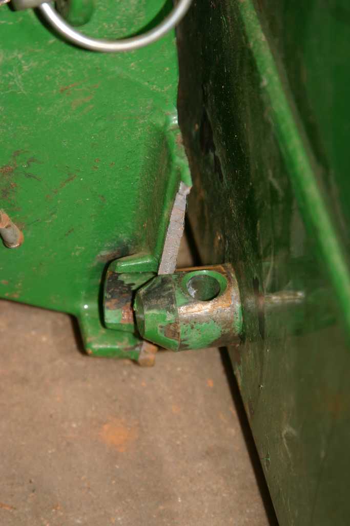

When I was reattaching my bucket after mowing last night I found that I had broken off one of my bucket attachment tabs. I run with the loader low for stability and visibility. I have occasionally brushed the ground when coming off or heading up my slope. I don't even remember hitting yesterday.
Anyone else have this happen? Possibility of a defect or poor design? See the attached pictures. The metal on the tab is VERY thin. Where it broke, the thickness is about 1/2 the diameter of the attachment pin hole.
I'll call the dealer today and see if I can get it handled under warrantee, but I'm not planing on running without the bucket attached any more. Guess I may have to invest in some front weights and take off the entire loader.

Wow! Bad news!
I have heard these things breaking before, because on the new "X" series loaders the entire Quick-Attach bracket is now a casting rather than built-up and welded. I think this was a very poor design on JD's part. Hopefully you can get this replaced under warrenty.
   / Broken bucket tab on 300CX loader #5
Unfortunately that part of the loader is cast steel which is fairly brittle . I wish that part was made from bar or plate. It would have bent instead of braking. All the X and CX loaders are now cast in some areas to save money.

I had a similar situation happen with my 300CX loader. The tab on the right side broke. I took pictures to show the dealer - what I found was rust INSIDE the break. It looks like you might have the newer casting, but mine was welded and broke on the weld.
Thankfully, I have a great dealer. They came out tha evening (at 7:30 after closing time). Took one look at it and said, yes, this has been a problem with others and we'll fix it. They got the part and sent a mechanic to the farm and replaced it. No charge at all to me.
Not sure how Deere handled it, but my dealer did the right thing.
I was hoping the problem was cured, until I saw your post.
   / Broken bucket tab on 300CX loader #10
There has been a Deere Tech update regarding these parts breaking, stating that production was changed and newer parts are 50% stronger. They state that if 1 side breaks, both sides are to be replaced. Let us know if the dealer doesn't have this info.. and I can give you the case number.
