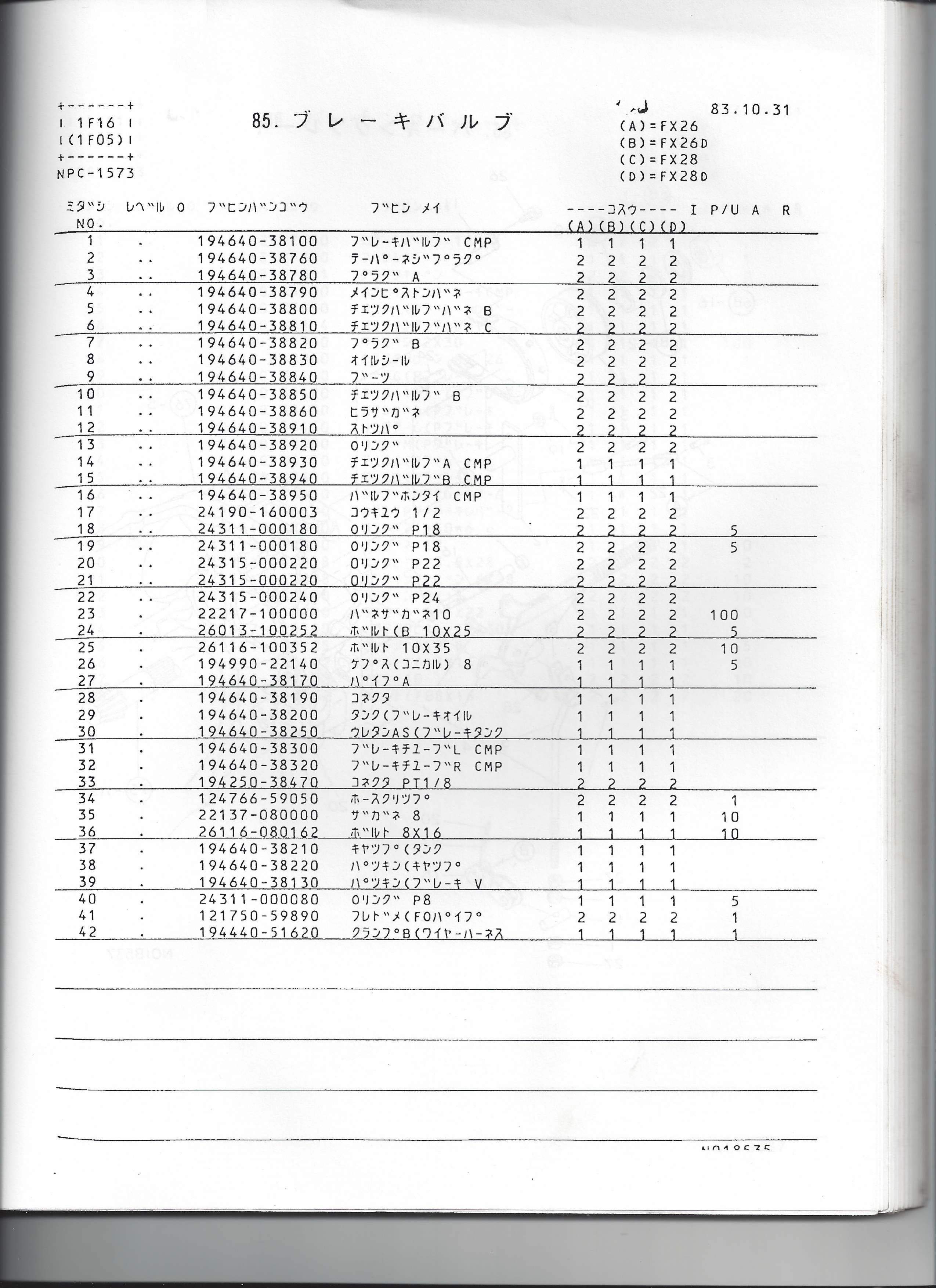

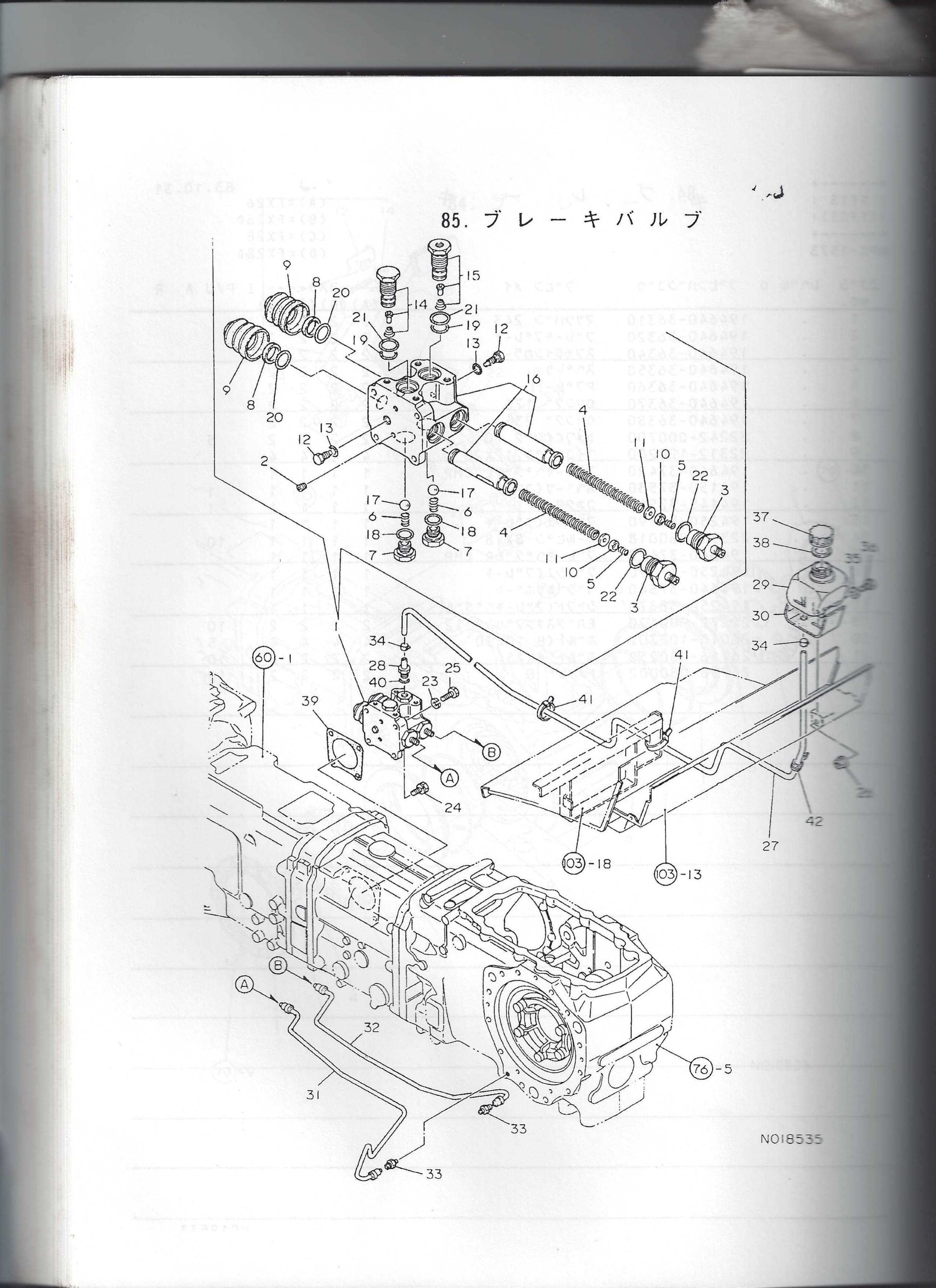

While removing brush we cought a brake line and broke the tube behind the nut fitting. I was hoping to reflare the line and put it back on. When I got it off it has a non flared end looking like an injector line. Has anyone had a line made or is this a dealer item?

I tried several hydraulic shops that make up tubing with no luck. Here are a few pictures of the line and a copy of the Yanmar parts manual pages. A friend who does hydraulic work said I may have to drill out the tubing from the end and braze in a new tube. Has anyone seen this type of hydraulic tubing end on other equipment? I called Hoye Tractor they were unable to locate a new line, I'm not too keen on a used line. The line is #32 in the manual

If Hoye couldn't find it. You may have to take your friend's advise & braze it up
   / broken brake line on FX26D Yanmar #5
Try contacting some of the importers that sell FX's, like Tullahoma Tractors They might have parts tractors?? Is there any chance of changing the fitting it attaches to ,to a flare fitting?
