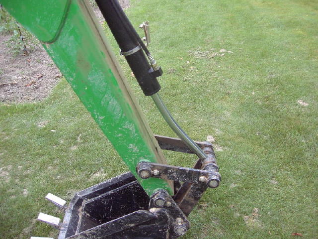

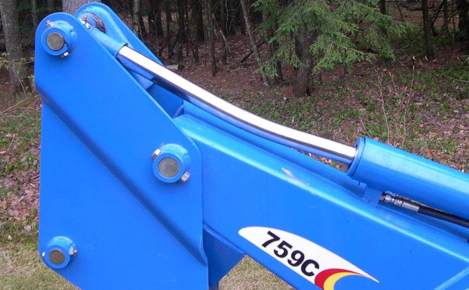

Digging out a stump and hydraulic fluid starts spraying out of the dipper cylinder. Looks like the cylinder bent into the frame and bent the frame and the cylinder. Shouldn't there be some kind of safety mechanism to make sure this does not happen? Anyone think this is covered by warranty?

I would have thought your relief valve would have popped?? Why it did not I am not sure unless you had a weak spot in there someplace. I don't know how old the system is but yes it should be covered under warranty if still in the warranty. Now a dealer may say abuse but if it is brand spanking new then he didn't set it up right.
All you can right now is call the dealer and see what he says.

It looks like you have a good warranty claim to me. The only way you could cause that kind of problem by misuse is to drive the tractor while the dipper is extended and against an immovable object. The cylinder should never bend only from hydraulic pressure. I suspect your cylinder's ram is faulty or the pressure is adjusted too high. Bummer! /forums/images/graemlins/tongue.gif

Why the dealer? Dealers do not assemble major backhoe components, nor do they assemble the control valve from a bag of spools and circuit reliefs. The dipper circuit may have a circuit relief valve to protect that circuit from being overloaded by another circuit that has superior leverage against it. The dealer should check the dipper circuit relief, if one exists, prior to completion of the repair.

I had a similar situation with my JD48 backhoe. I was digging a stump. As you can see from the attachment, the cylinder bent.
Although it was covered under warranty, the dealer maintained that it could not happen from the hydraulics, which it did. He replaced the cylinder and checked the relief valve. The relief valve was working properly.
