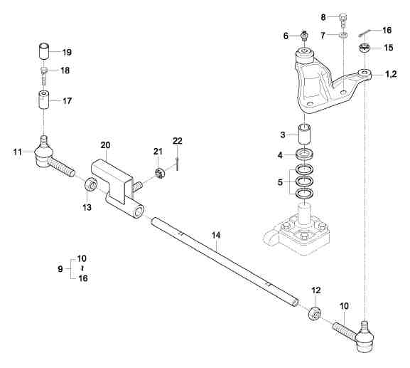

Today I broke my right side knucle arm. At least that's what I think it is. It is the cast iron piece that bolts to the knuckle with a little arm that sticks out and bolts to the steering cylinder. I broke the little arm off. :(

Managed to get it on the trailer and get it home. So I am wondering if this knucle arm is something I can fix myself. Looks like it just bolts to the knucle. Does anyone know if there is anything tricky about bolting a new one on? Thanks.

It is pretty easy no real tricks.
There was an update put out about 3 years ago on this.
The steering bump stops were located on the wrong side of the axle and need to be moved to the opposite side..the only problem is I can't remember what side they are suppose to be on.
Make sure when you get the parts you get it for the proper side.
Get the new bushing and seal to.
I have everything on the shelf if need be.
   / Broke rt side knucle arm #3
Looking at my LK3054 service manual looks like there maybe a couple of shims under the four bolts that hold on the knuckle arm. That looks to be the only semi tricky part. I've not pulled steering pistons off of a Kioti but in some instances the the ends are held on with tapered bolts that require a pickle fork to pull apart. All in all looks to be a straight forward, unbolt and then bolt back on procedure. also looks to be a busing on the knuckle pin. Good luck.

Rick,
Thanks for the parts. Came in 1 day!
I changed out the knuckle arm with no problems. My problem now is I cannot get part 17 off part 11 on the diagrahm Rick sent. Part 18 is a bolt with a lock nut on it. That comes right off. Are you supposed to use that lock nut somehow to get part 17 off. Is part 17 standard thread, meaning counter clockwise loosens it?
I could use some help here.
Thanks...
   / Broke rt side knucle arm #6
Not certain on yours as tough to go by a picture, but maybe a tapered fit. May need a pickle fork to get the part off the shaft. I've used pickle fork many times to remove tie-rod from a car. A picture would help.

Got it all appart and back together with the new parts. It's working fine now. The threaded sleve above the steering arm was rusted on. Heating it broke it free fromt he rust. I was then able to tap the old steering arm end (the broken piece) off with a hammer. It was just a bit rusted on as well.
Apparently this happened because the steering stops are not correctly installed. There is a TSB. I will post a separate thread when I have time so other LB1914 owners can check theirs before they crack.
