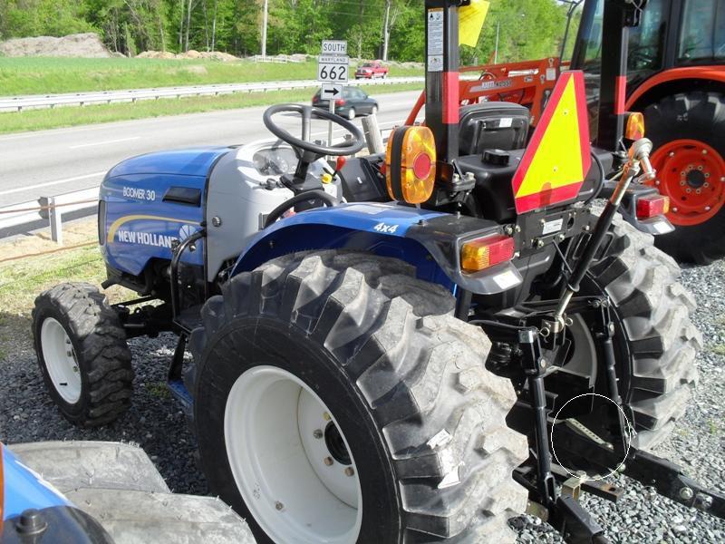

Found a photo online showing the bar that I'm talking about.

You broke gold colored pin on the arm itself? That's a lot cheaper than breaking off the mounting point under the axle.
The easiest solution is to order a new stabilizer arm from messicks and take the old one in to a welder to keep as a spare.

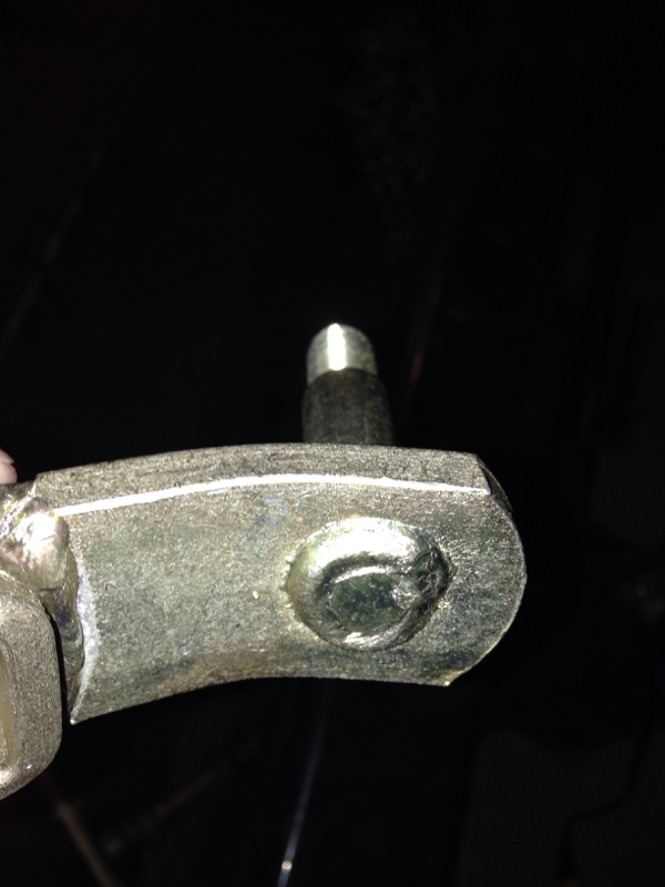

This piece?
Comes as an entire assembly. You can't order just the upper bar.

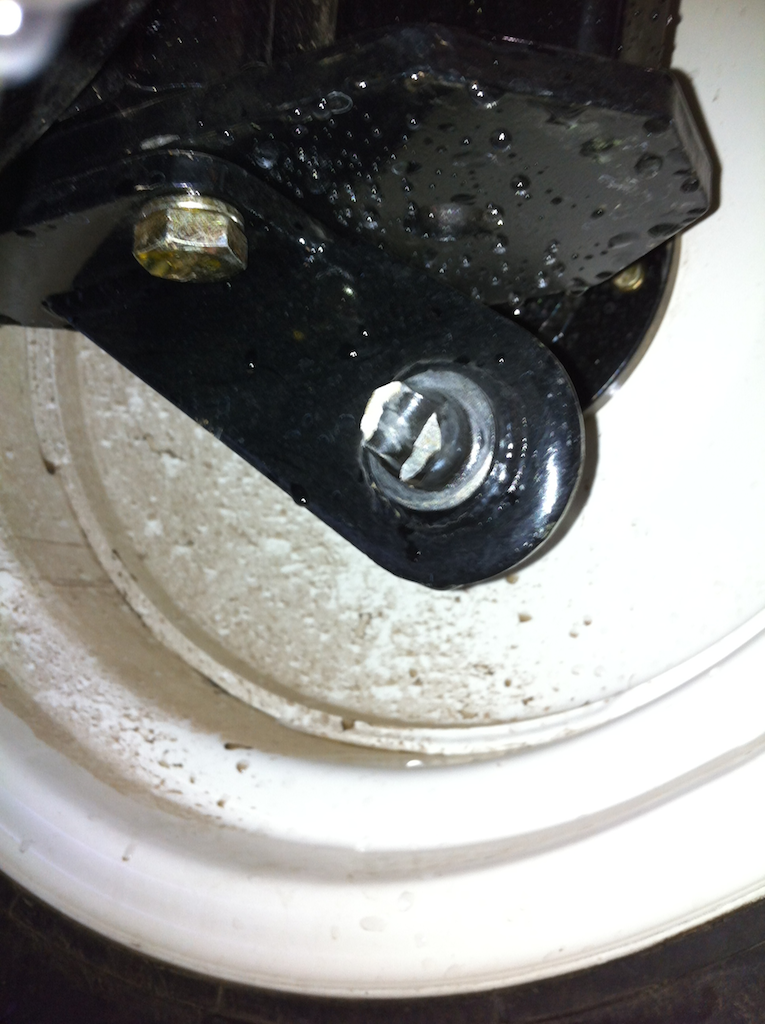

I've put a call in to my dealer about replacing the plate. It may be covered under warranty but they'll need to send the broken one in to see. Either way, it apparently runs around $120. Here's a photo of someone else's plate. Same as mine. I'm just relieved to know it's a plate and not a pin welded directly to the frame. The engineers must have anticipated some broken pins. That was good thinking on CNH's part.

OK, this is a lot clearer now. It looks like the mounting plate is bolted on to the axle so I would unbolt it from the tractor, grind off the weld on the pin on both sides and punch out the old pin. It should be a Cat 1 pin the same as you would have on your implement that is threaded and bolted on. Pick up one to match the size of the stabilizer arm, insert it in the hole and bolt it in place (or weld). If bolting, use a double nut to secure it so it doesn't back off. I could fix this in less than an hour including dismount and remount (paint might need touchup) If warranty covers it just get a new plate and see if the dealer will let you keep the old one to repair for a spare. I think maybe the welding caused some hardening of the pin which caused it to break or the weld could have undercut the pin caused a stress riser that made it break. Either way, a bolted on pin would be the easiest way to go and easily replaced if damaged.
PS: If you have a spare 3 PH pin of the correct size, this could be fixed in less time that it take to make a trip to the dealer for the new part. Those MIG welded fillet welds wont have a lot of penetration so grinding them flush should allow easy removal of the broken pin.

Someone else's? You mean my pic :)
Read my entire thread. Check the lynch pin on the other side. See if you have the ones with the mushroom head instead of a flat side (I have a pic of the good and bad one in the thread.) if it is the mushroom head, they bind and the stabilizer becomes a wedge and blows apart the pin. You can also check for "marking" and gouges on the right side one to see if there is evidence of binding.
If you have the mushroom head, print my thread and take it to your dealer and demand they warranty it. It's a bad choice in pins and I made CNH well aware of the issue and solution last year.

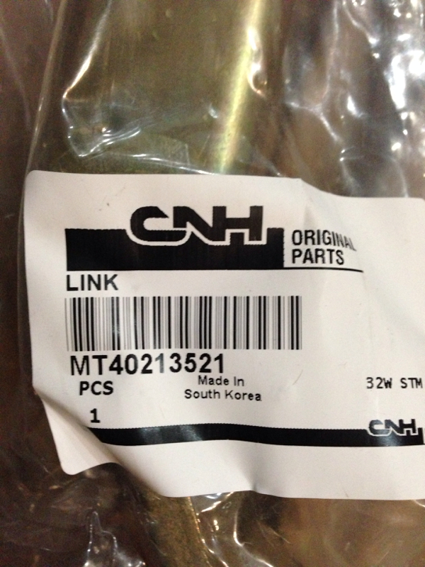

Just a heads up that the first plate we ordered had the "correct" model number but was for the opposite side of the tractor. Hopefully they have corrected that issue on the parts.
