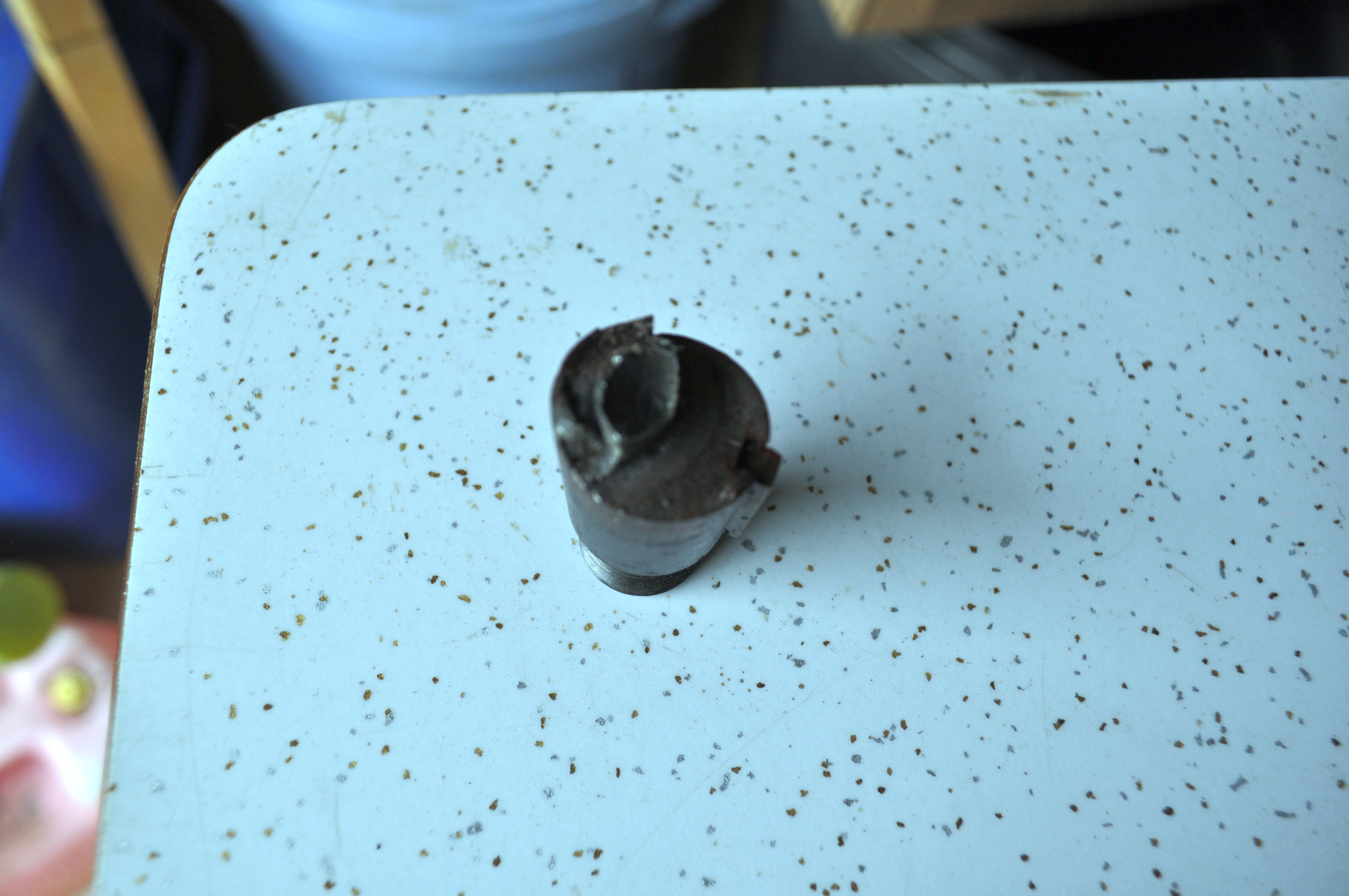

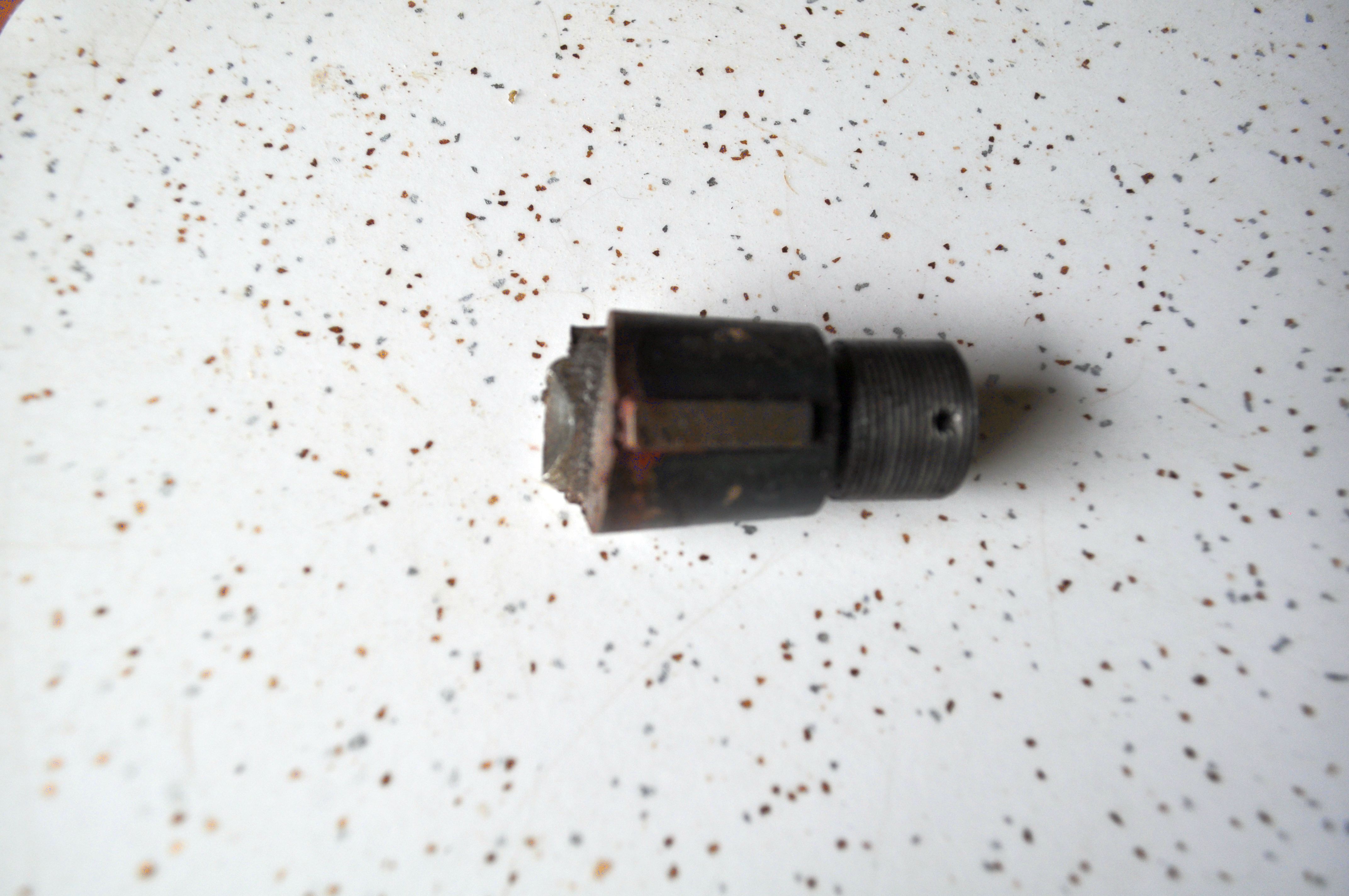

I found some pics of the 1st axle failure. This one broke at the same spot.
   / Broke another wheel motor axle #9
Judging by the rust on the inner fracture, that was cracked for a long time before it gave out. I wonder if you got a bad batch of motors.

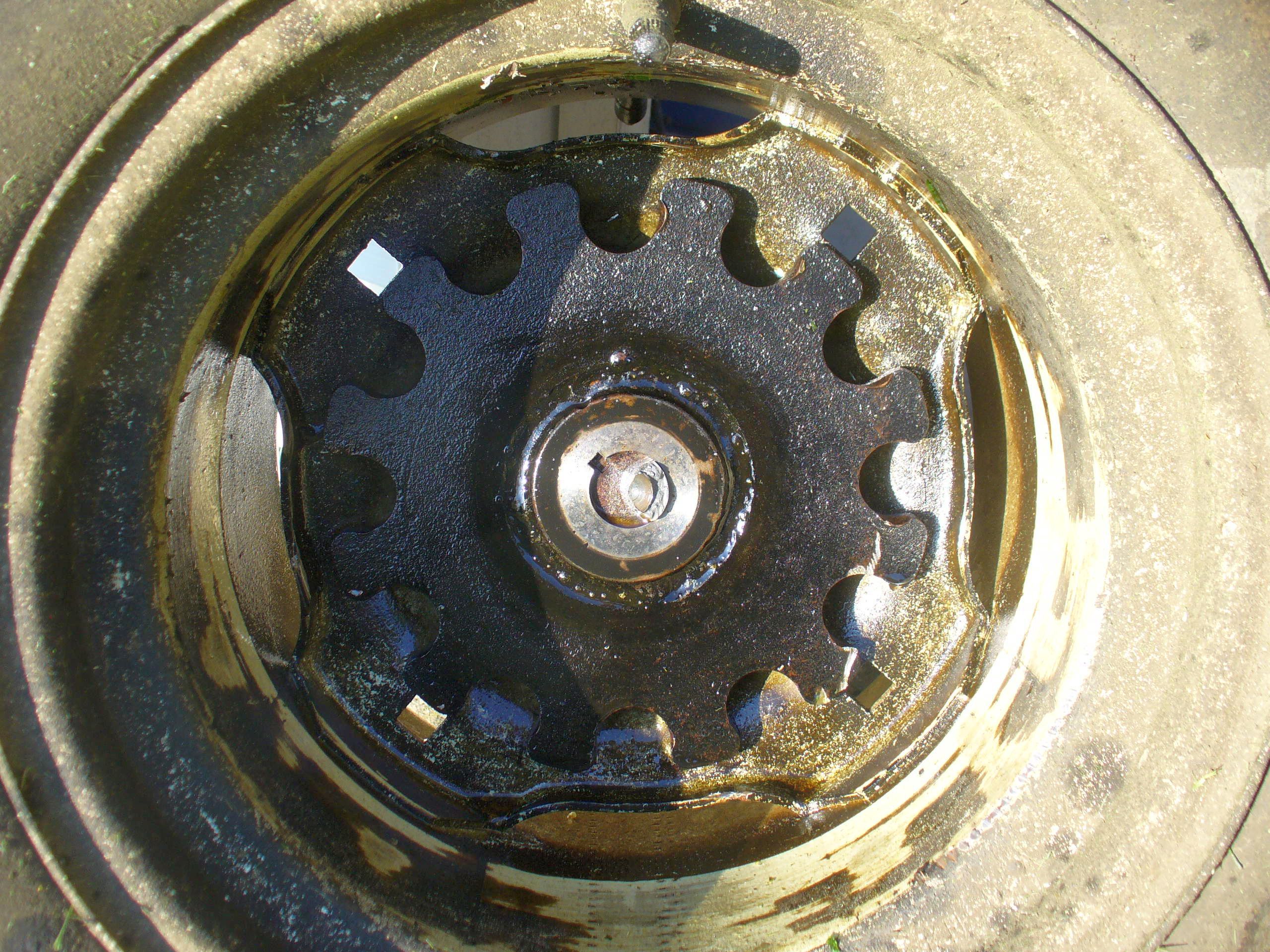

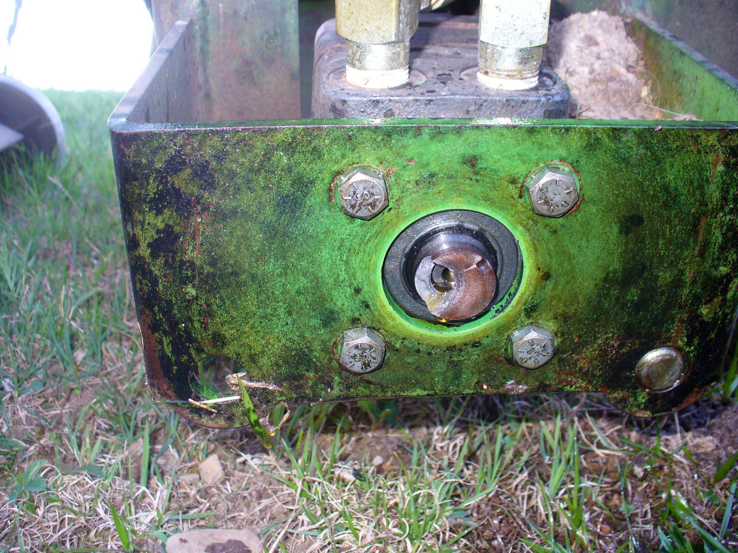

Pics could be better....no plastic in there. I hope it was just a bad batch! Here are 2 pics of the end that snapped recently.
