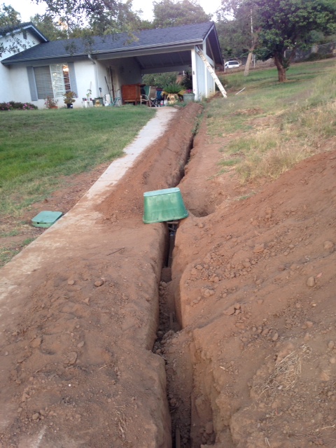

For 3.5 years my connection has been the 4G cell tower nearby. This was better than nothing, but speed issues aside, you have the dreaded data cap. In this day and age, 5 Gb per month does not go very far, and the overage charges are outrageous. So for 3.5 years I have gotten out of the habit of clicking on video links, downloading music or much of anything else, and avoiding large email attachments. Had to save anything interesting to view at work.
Finally I had the wireless guys out for a site survey while I was home, and behold, there was a line of sight to the mountain from my little pasture, down by the well pump. They had not realized that was part of my property in the past, and the spot is about 200' from the house.
Time for action. Used my little DitchWitch to trench as part of the larger irrigation project. Rented an UnderWunder to bore 23' under a very thick concrete driveway. Ran most of 300' gel-filled CAT5e in 3/4" conduit (adding junctions and pull rope for future), routed through outdoor roofed area, bored through wall, and down the attic. Chipped, bored, and shoveled a 40" hole wider at the bottom, installed 2" OD galvanized pole (not standard fence post), and filled with 'crete.
And finally I was ready....
The guys were out yesterday. I took a vacation day to meet them. The dish is a 25" 5.8 GHz with receiver for the Motorola Canopy system they use to deliver the service. I picked up a new Netgear N750 wireless router and installed it in the centrally-located laundry room. I still didn't really believe it was gonna work, until they came out and said, "you've got net".
OMG... 8+ mbps download, 2.74 mbps upload, for the cost of my ATT data card! Movies, cartoons, music, came pouring into the house! All at once! No data cap! I played an old TV youtube of Rednecks, White Socks, and Blue Ribbon Beer, just for the heck of it! Also my phone and mommy's iPad thingie are now like instantaneous; she did a "face time" session with her mom and it was like ESPN coverage.
Folks, if there is such an option in your worlds, all I can say is that it's been life-changing. At least for the last 12 hours.

That Millenicom link looked interesting. If this hadn't worked out, that would have been worth looking into. Also, if you're a long way from the cell tower, Wilson has some street legal amps and a Yagi that can boost things a lot: For Cellular Modems | Store | Wilson Electronics
In my case I could have hit the cell tower with a pistol. ATT has glass running right to the base of the thing but wouldn't let me tap into it from 150' away. I will not miss them and will be terminating that service today, with glee.
I was really worried about loss through the long cable run, but signal is excellent at the router end. It's a power over Ethernet (PoE) setup from the house to their receiver in the dish. I have also been super-impressed with the Netgear wireless, a WNDR4300. No-brainer setup and excellent coverage so far on the 2.4 band. I am not sure what to do with the 5 gig part of it, but it's nice to have for future.
Next up: CCTV cams and a web-based gate control and call box. I can sure think up projects faster than I can do them, but this would be great peace of mind and convenience.
