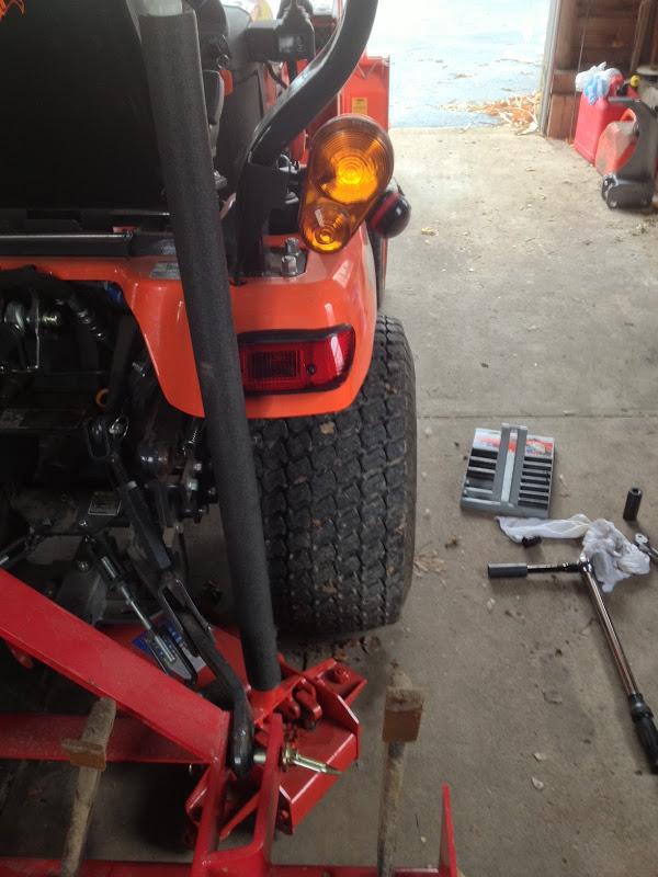

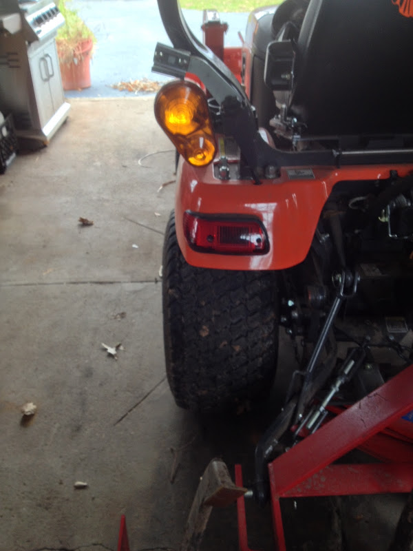

i went with the small ones (1.25") due to the clearances on my 54" mower. most of my annual hours are accumulated mowing and i wanted spacers that i could install and forget.
i installed them this afternoon. no idea (yet) if they make the machine noticeably more stable, but they made installation of the tire chains a bit easier. plus, though subtle, the tractor looks cooler with the wheels pushed out a bit :thumbsup:
without spacer:
with spacer:
