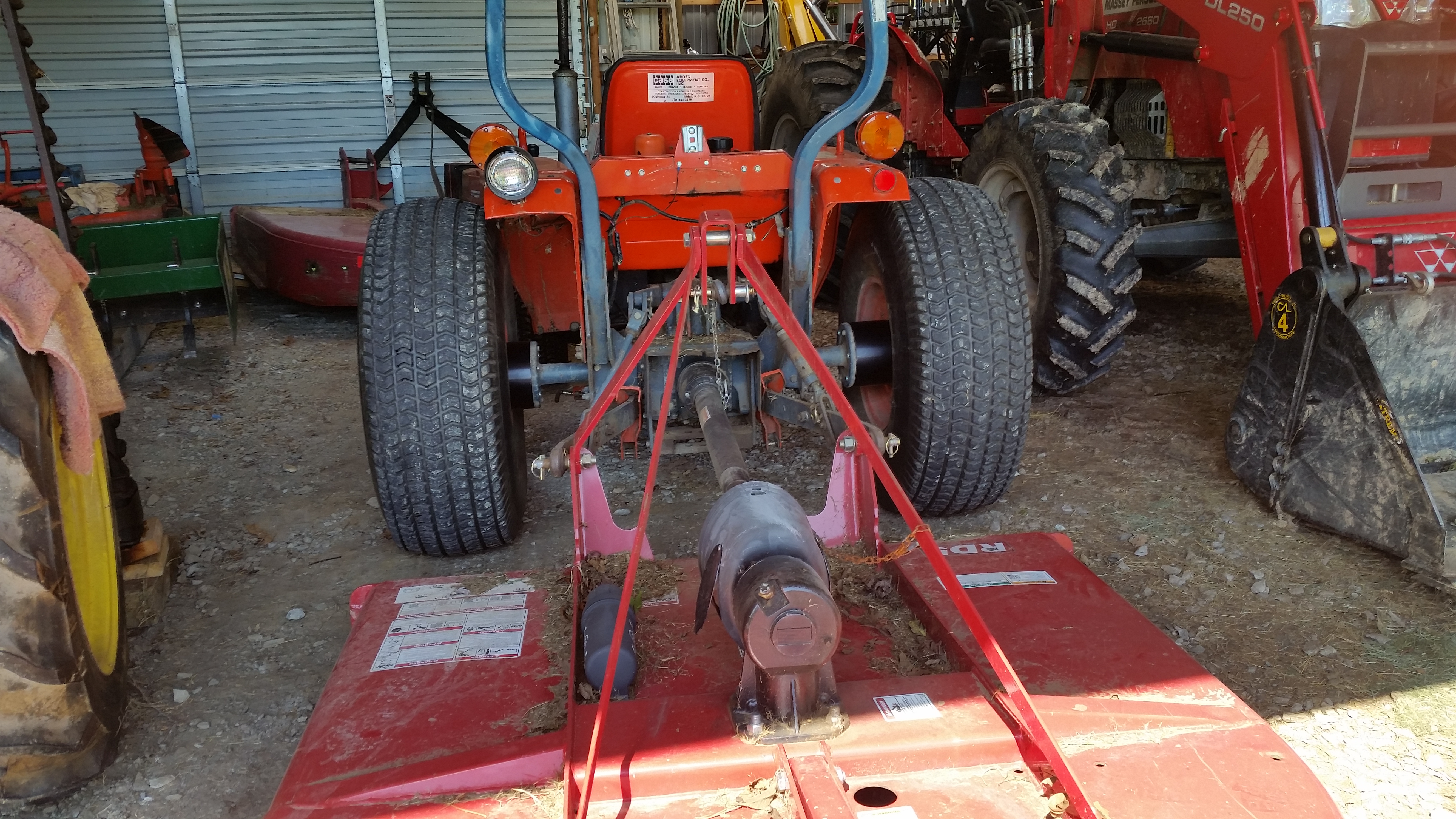

The height that matters most is not where you sit but the center of gravity. Those old Fords, Ferguson's, etc. had relatively high wheels and very low c.g. with so much of the transmission, chassis and engine sitting very low. Sounds like you may have found a satisfactory situation with the 3" spacers you are using. I'm conservative/cautious/picky when it comes to working on steep ground. Just for gen info I am inserting some pictures.

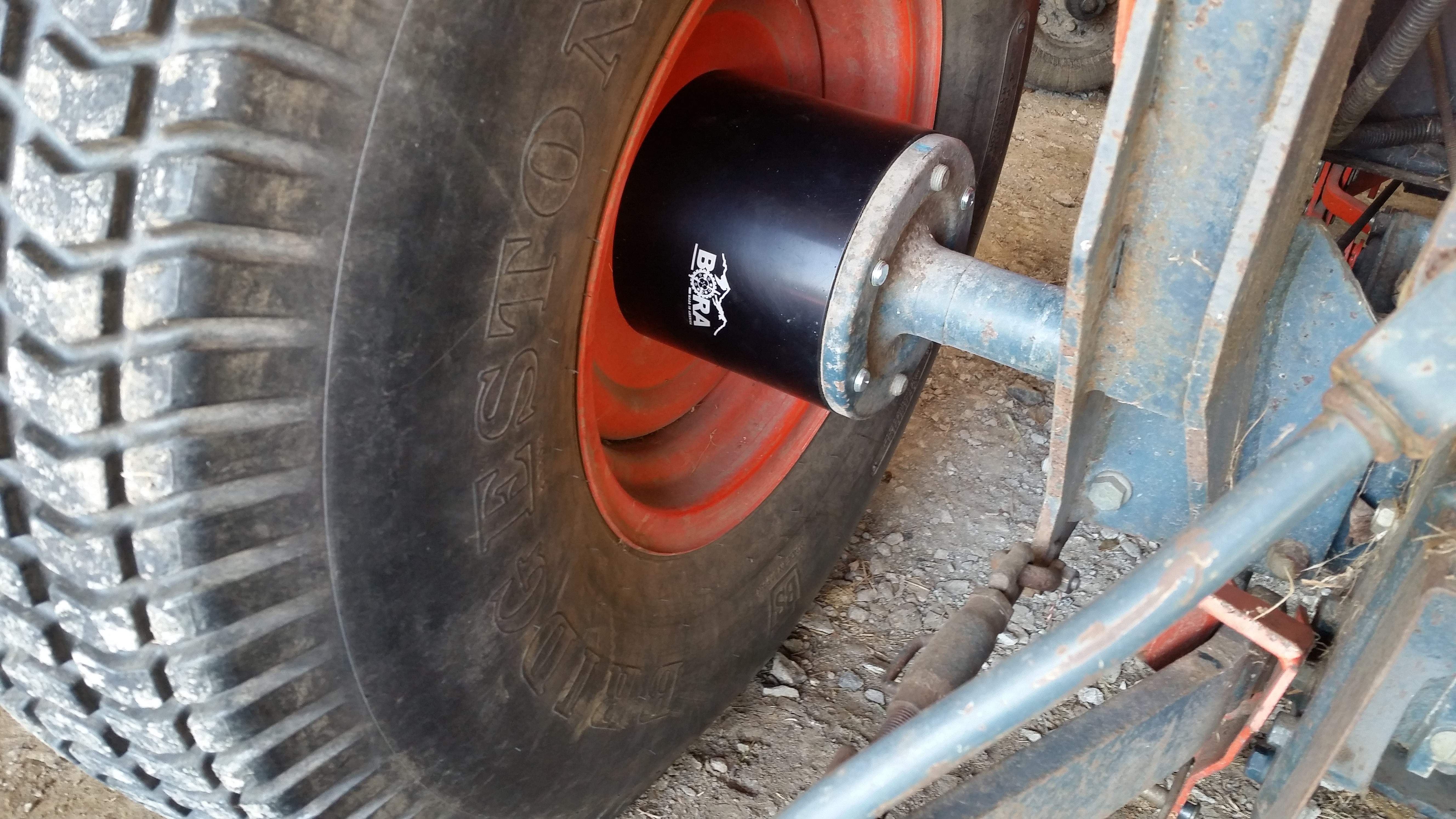

These are the spacers I Installed on the B2150 Kubota.
This is what the B2150 and 5ft hog look like after installing the 6" spacers.
This is a friend's installation of a different type wheel spacer (also 6 inch.) These are steel welded style versus the machined aluminum ones I used.
