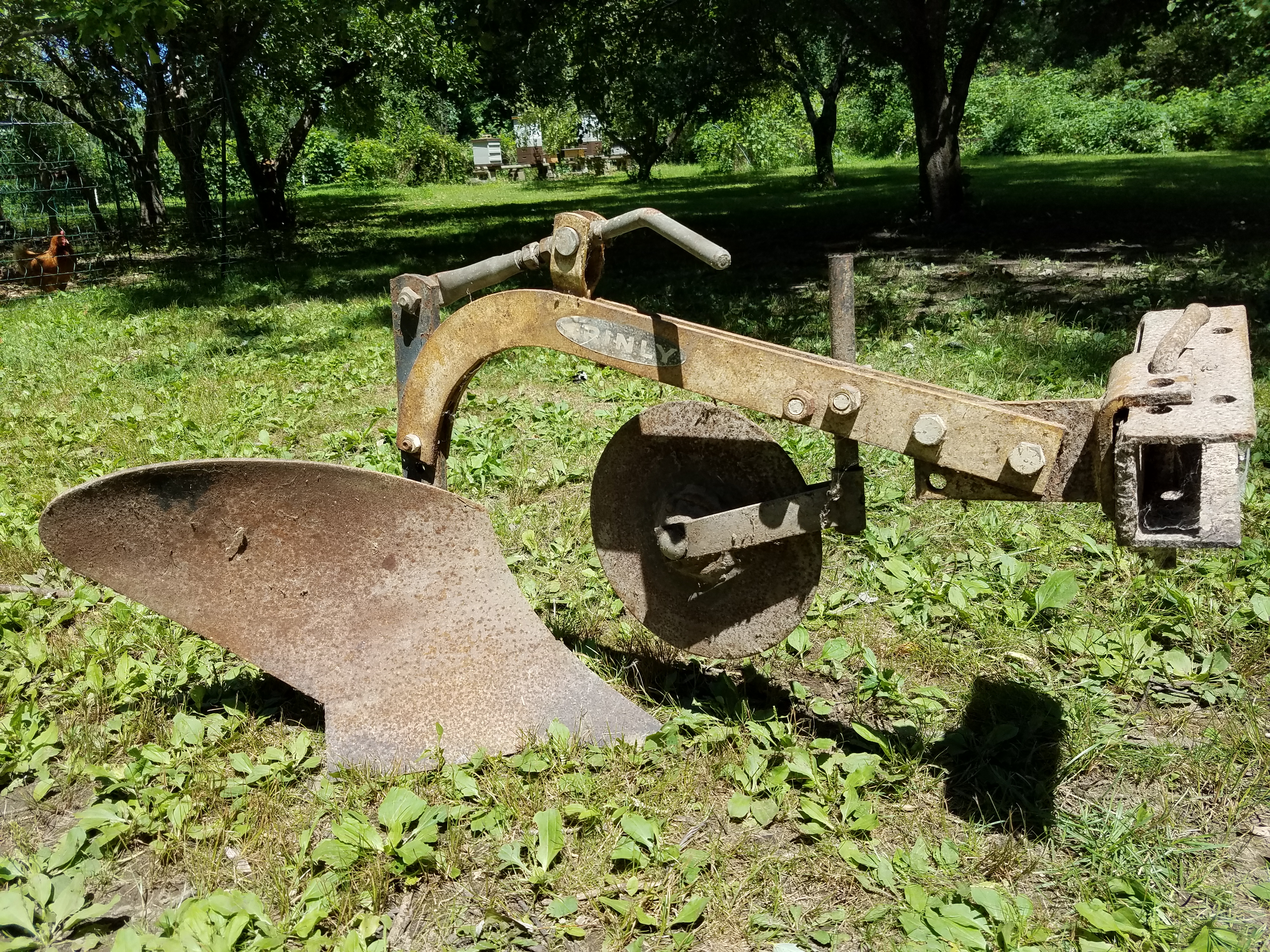

I found an old Brinly Hardy moldboard plow in my pole building today. Initially, my thought was to sell it on CL. I don't really know what they are even used for, but if I did maybe I might use it. We live on 20 acres mostly wooded and are clearing a lot of invasive buckthorn and honeysuckle. Would this be of any use to prep the land afterward for replanting native plants? The model is a B-75 I think, single blade. plow.jpg

Not trying to sound like an idiot here. I understand what a plow does, just wondering if this is considered a useful attachment or if I should look for a tiller for the same purpose.

I would think it would rip roots out of the ground? Dont know for sure but I would try it

Brinly plows use a sleeve hitch to connect behind lawn/garden tractors.
To use a Brinly sleeve hitch plow on your Three Point Hitch you will have to buy an adaptor for the Brinly, which will slide into a 2" female receiver hitch on your tractor.
As a single bottom, light duty plow, a Brinly is fine. A Brinly will plow 5" deep.

No plow in good condition will rip out roots. A plow slices through the earth, slices through roots and inverts the mass so lowest soil and roots are up in the air for sun to dry.

Northern Tools I think still sells these. They're usually hooked behind a 4 wheeler or small tractor for doing small food plots or gardens. They make a hitch that slides into a 2" receiver then bolt the sleeve hitch to it. They are tough plows and might be worth it to drag it around and tear up small roots. If you're going to use a tiller it won't hurt to drag this through the area first. On hard ground with large roots or stumps this isn't going to help much though.

I found an old Brinly Hardy moldboard plow in my pole building today. Initially, my thought was to sell it on CL. ------------------------------
If you sell it, don't price it too low. There are a lot of Brinly Hardy collectors out there.
Not to long after I posted pictures of my Brinly Hardy forks in my TORO + Loader thread, I received a PM from a guy that joined just to send me a request to buy them. We communicated by phone and he drove over from the east side of Oklahoma and bought them.
