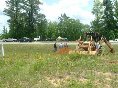

So I'm working on my rafters on a my workshop and home when a stange truck pulls up. Some stranger saw the gate open and was curious about what's going on. I'm friendly and tell him about the park and we chat a little. This in normal East Texas behavior.
Anyway, I know the gate was locked, so somebody has opened it. I head out that way and see a convention of trucks and people all over the place.
Yippy, they started my road bore to bring in the water today.
You'd think they'd say something to me, but I've filled out the forms and paid the bill, so they don't need me for anything.

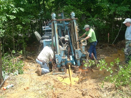

They got everything set up, took there measurements, and started drilling.
It was realy quite simple. They used allot more water then I expected, but it makes a huge diference.

The drilling machine was across the highway from my land. They wanted to feed the steel pipe in from my side bacause of the space available.
This is the hole they dug on my side.
They hit it just right!

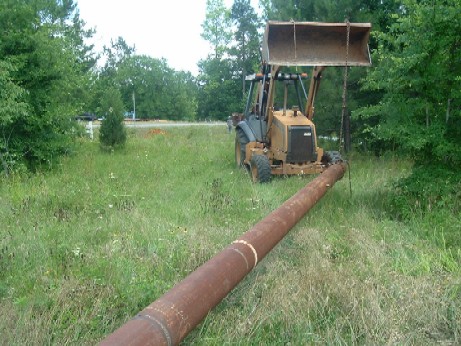

Moving the pipe around was a job requireing their backhoe. It's a Case 580L 4X4. Nice machine.

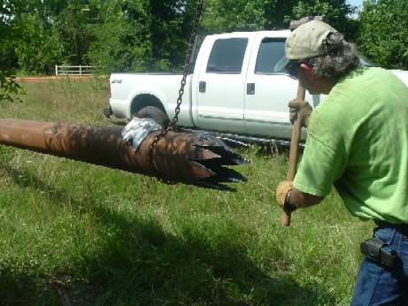

Once the pipe was in the general area, they started digging a trench to fit it into the hole.
They also cut notches into then end of the pipe.

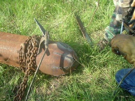

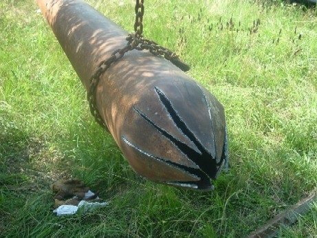

They are closeing off the end of the pipe. First notching it, then bending it over to form a bullet shape.

   / Bringing Water to the Park
They welded it tight to keep the mud out from whole.
Not shown, but the next step, they welded on a piece of flat steel with a hole in it to attach to the end of the bit on the road boaring machine.
