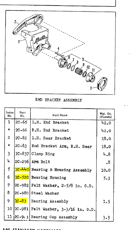

Pick up what looks like used to be an old brillion seeder that's now just a cultipacker. Anybody know where I can find replacement hubs and bearings? The rear one in the pic needs replaced.
Found an old parts manual for what looks like matches mine but haven't had any luck finding the parts for sale anywhere. http://landoll.com/Manuals/Brillion.../8C273_SS96-04&120-04_PARTS.pdf?_t=1187886908

Piece of cake. Look up the parts prices online at Messicks and order from them mail order--drop ship. Brillion still has parts for everything and prices are reasonable. Yours are needle bearings so make sure you get them all in. You can hold in place with grease. There will be no problem getting parts and I do it all the time.
That could also have just been made as a packer. It doesn't have to be a seeder and I don't think it was. Brillion used very few different parts and many things from the 1960's are still made today and are maybe 98% the same. They have roller bearings these days. I'll bet you can even buy a roller bearing conversion for your packer. It's expensive, so don't since the needle bearings are fine.

You just have to fool around on the internet and find one that looks like it. Many--almost all-that look the same are the same. Brillion is unique in that what was made is generally still made and parts are still available because they were used in so many of the same models. Relax.
You have needle bearings that, from a lack of grease, stopped rolling. Then the axles just rode over the bearings that were not turning and wore them out. The rebuild kits come with enough to do the job and you can only fit so many in the hub. Put in what fits tight and that's the right number. You'll see.
Wait--you might be talking about the packer wheels that contact the ground and yes, you could be missing some. Many that look like that are the same and new ones are maybe $85 but used ones can be had for $50-$60. Shipping is an issue because they are heavy. They install by unbolting the axle and sliding them on. No big deal.

Looking at the pic do you think that bearing housing is shot or do you think I can get by with just the bearing?
   / Brillion Hub and Bearings #9
Have to take it apart. How much is the housing from Messick's? Can't be that much?
I always took them apart first and then ordered the parts. Brillion is fast and you can call Messics and put on a credit card. Brillion will drop ship to you.
The "bearing" is just a bunch of small round steel pins or "needles". Like extra long u-joint pins.

I have found the bearing but not the housing. Brillion: BEARING, Part # 1C83
What I need to figure out is if I can get by with just the bearing (part no. 9) or will I need the whole housing assembly (part no. 5). According to what I can find on Messicks I can't get the whole assembly but I may be able to get the individual parts. I need to get the thing tore apart to figure all that out.
