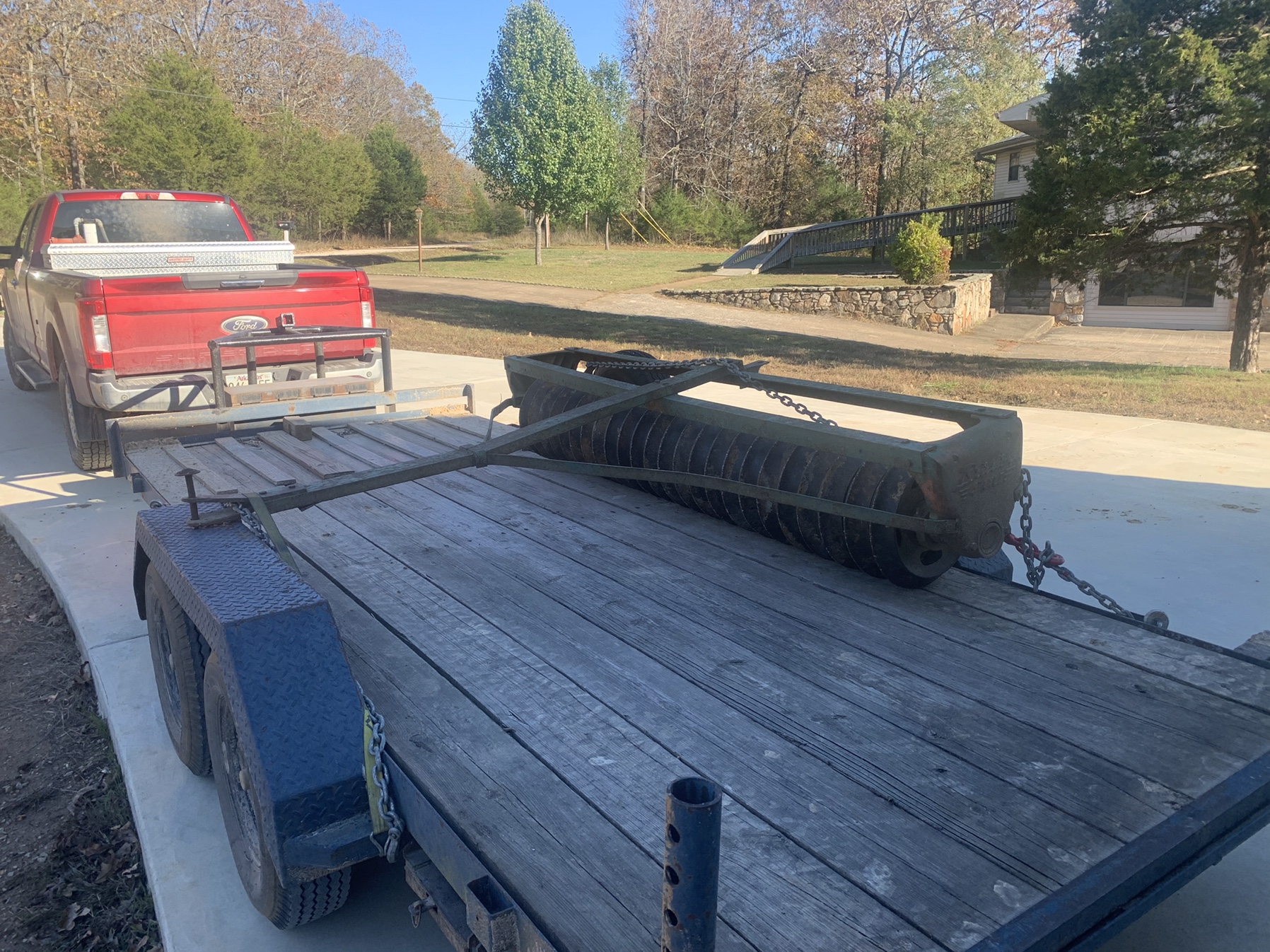

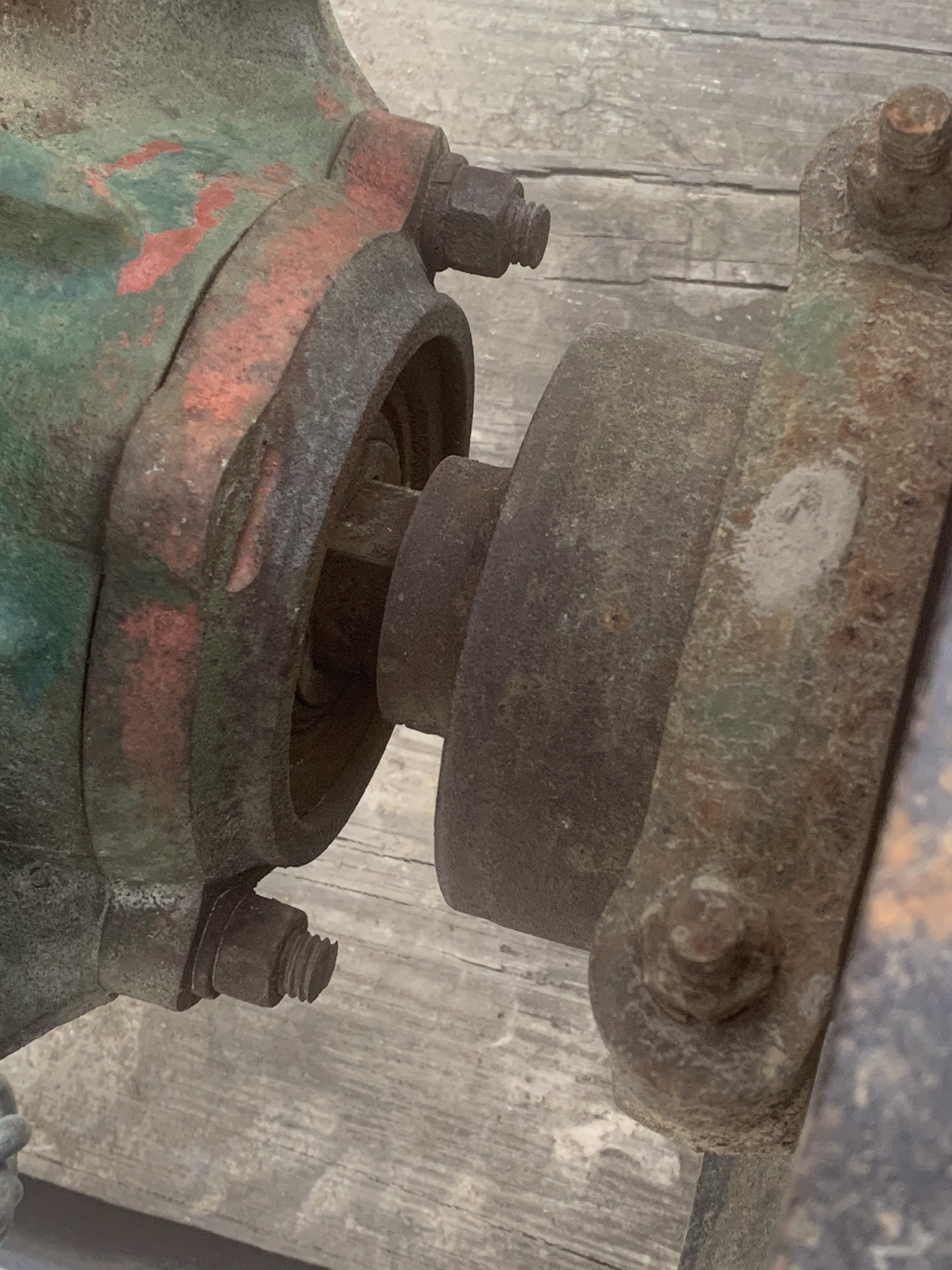

I just bought an eight foot Brillion cultipacker & got it home today. After closer inspection l think lhave a bad bearing or maybe two. It’s also possible one wheel is missing. I’ll start disassembling tomorrow to see where l stand. It’s understandable that bearings are bad as its very old.
I have some questions:
1) How do l find outwhat model it is, there is no tag on it?
2) Where can l get parts?
3) Does anyone know whar the original color(s) were?

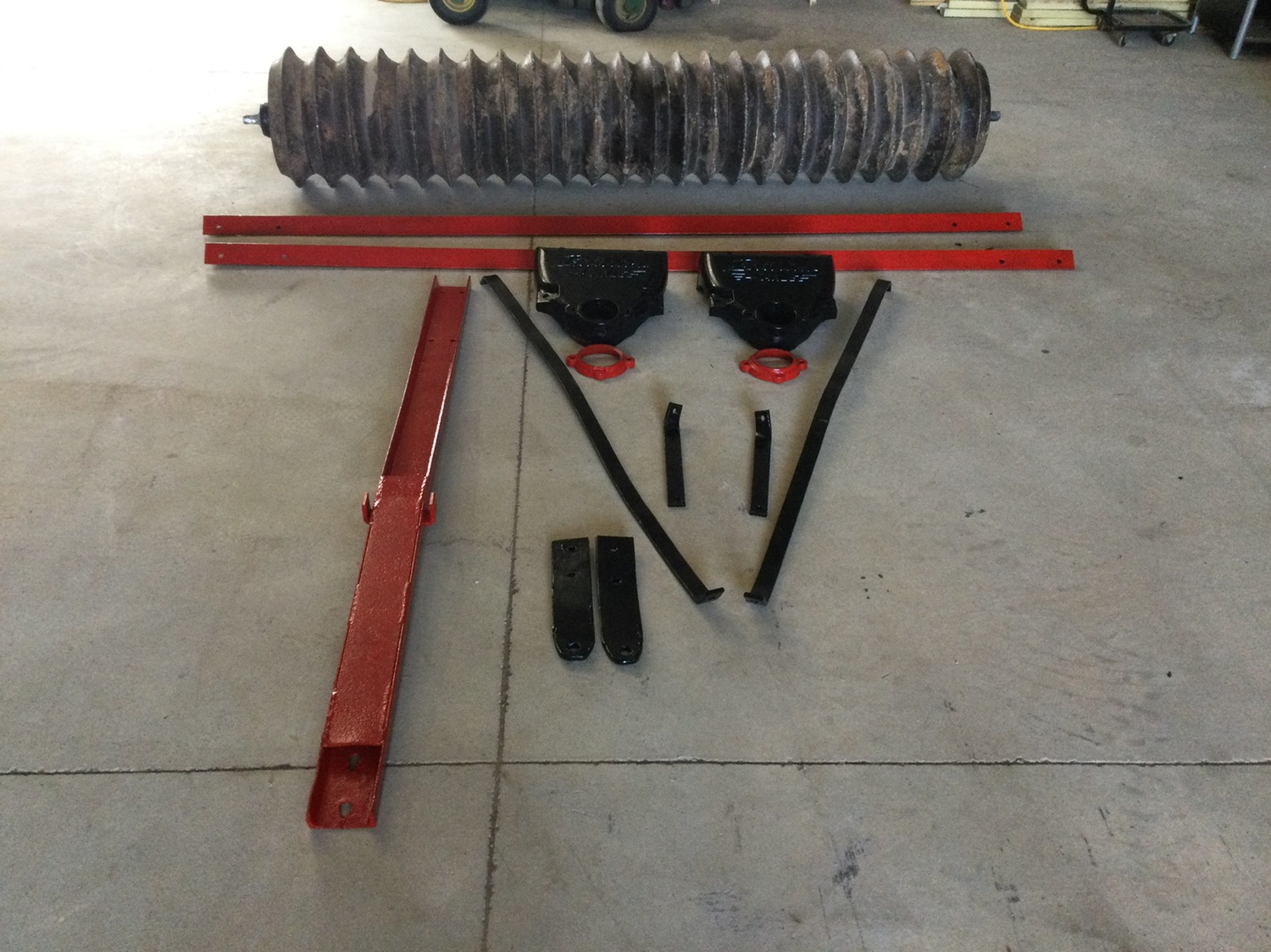

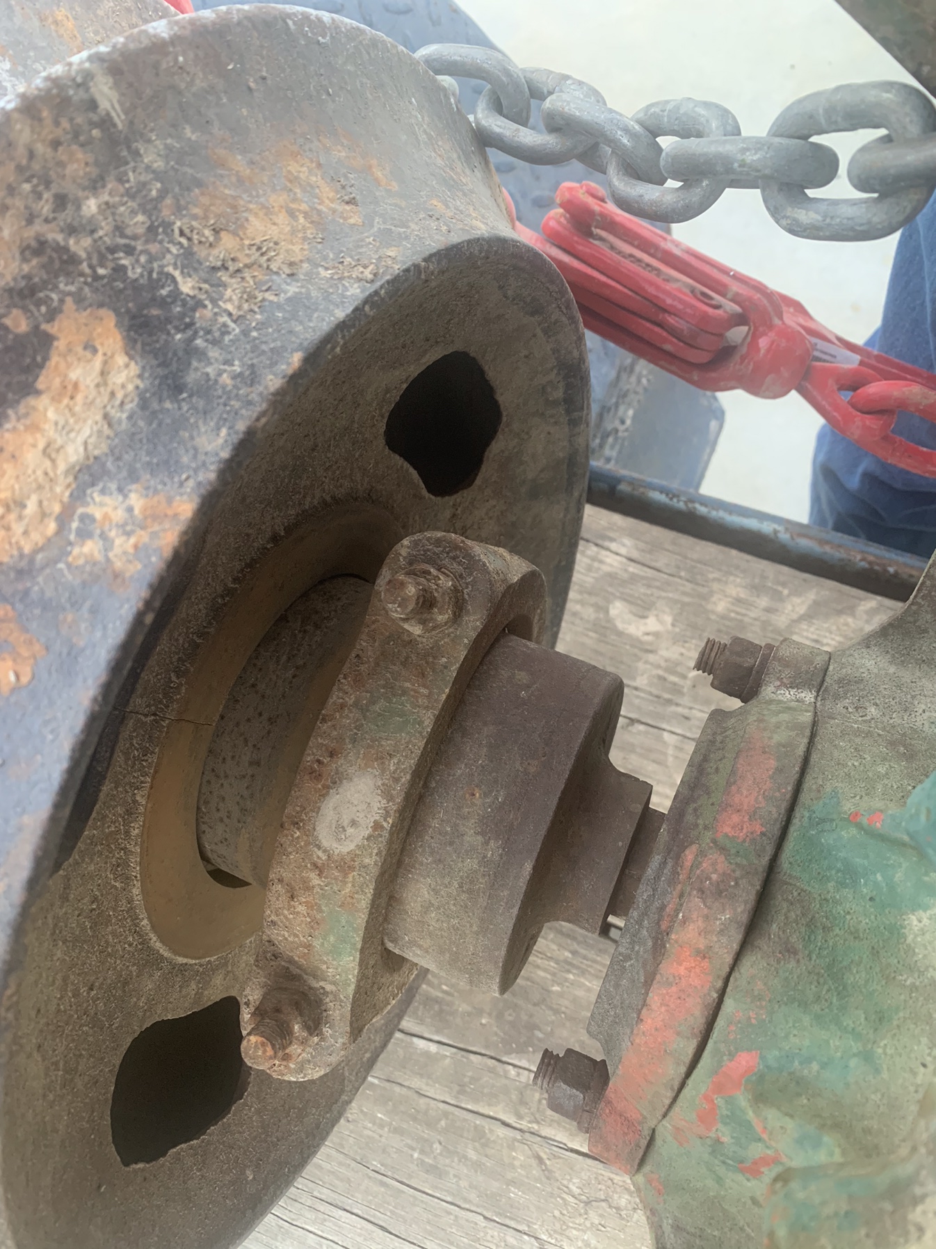

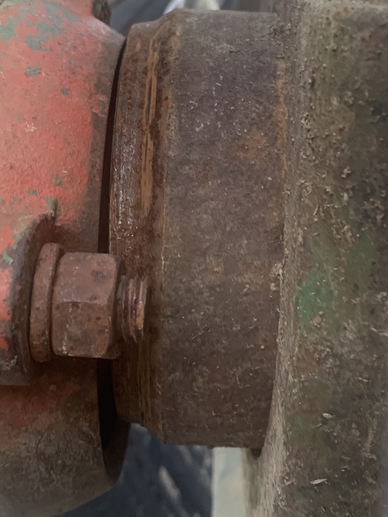

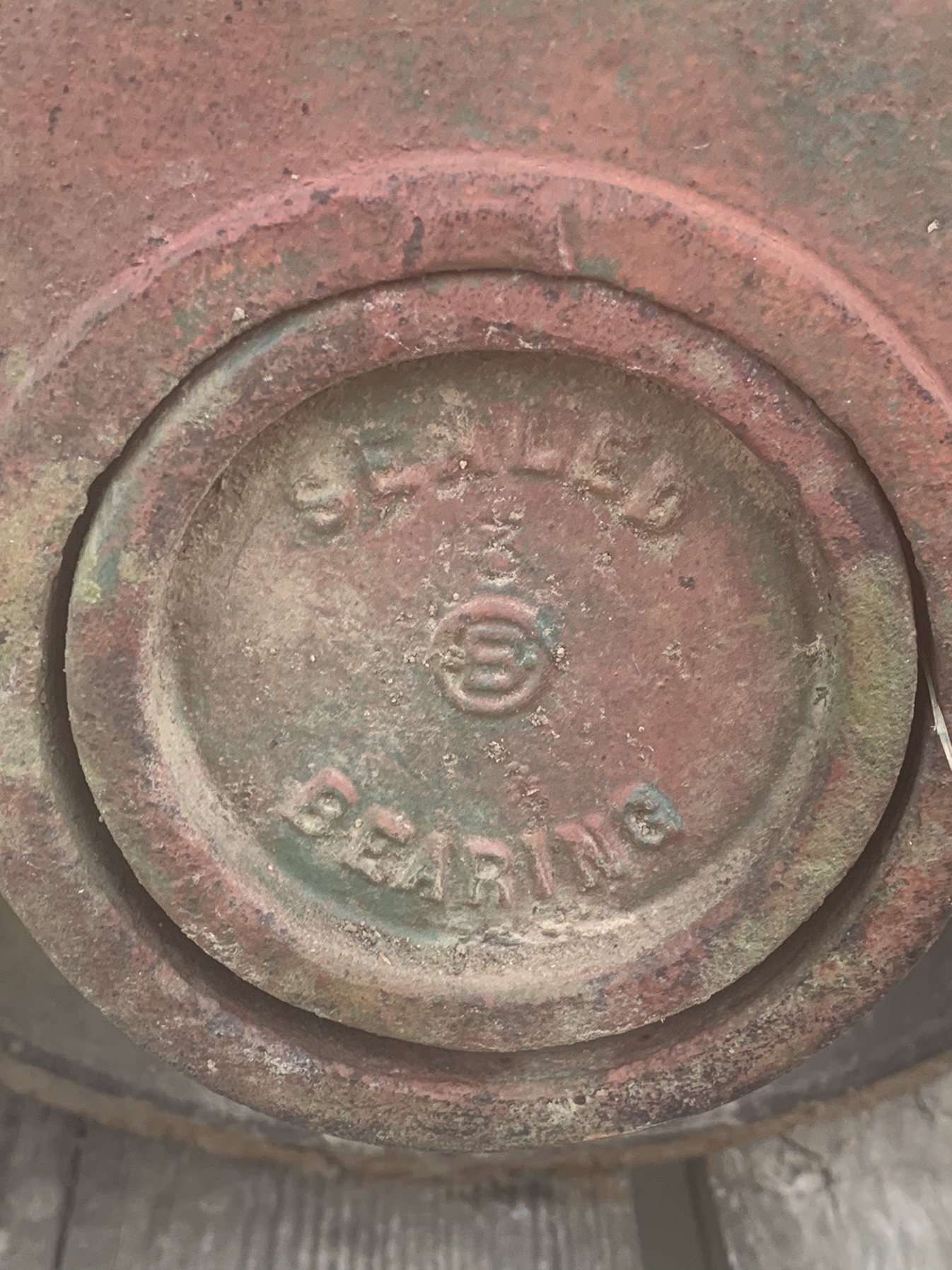

Got everything painted & new bolts. Waiting on new bearings to come in in a few days. Had to bring bearing hubs to a local machine shop to get the old bearings out.
   / Brillion Cultipacker rebuild
I ordered the bearings from Agri Supply, part number W208PP5. Figured this may help someone down the road.

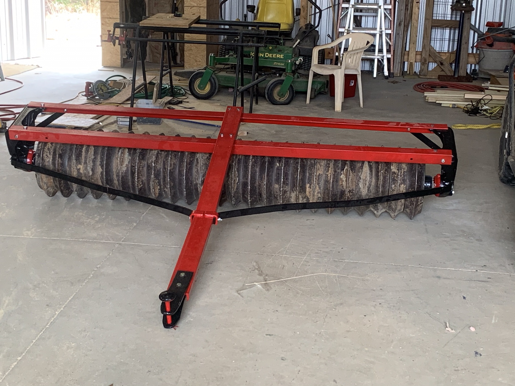

Well I finally got my Cultipacker put back together, new bearings installed.
   / Brillion Cultipacker rebuild #8
Do you have any photos with the bearings removed? Bought one similar to yours and want to know what I'm getting into before I take it apart. Thanks!
