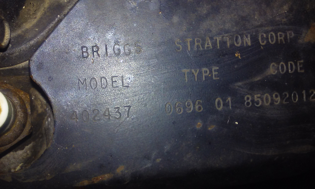

My Briggs and Stratton 16hp twin cylinder industrial engine won't fire. I parked it last fall with a bad coil. Just replaced the coil the spark plugs and now it won't fire. It don't even act like it's firing. Any ideas???
Attached are the info for the motor

Cleaning a rusty mag coil/magnet makes one feel good but a little rust on those components have no affect on magnetic flux. It is really helpful if you post engine model numbers. ASSUMING you may have a flathead opposed twin, 40 series engine, are you sure you installed the coil correctly? Plug wires exit coil heading towards the back of engine, double back in opposite direction coming out then on carb side of engine where plugs are.

Yes i do have that style. Sorry about not positing earlier
Can you explain what you mean a little more. I did the the shorter spark plug wire to the closer plug
