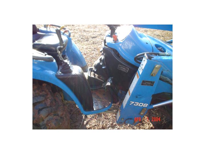

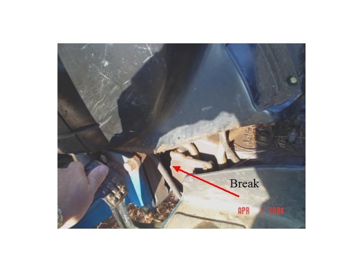

I have a TC33D and it broke in half while I was moving brush. I only had a bush Hog on the 3 PH. The New Holland Technical Rep, after two months, look at the broke tractor. He said New Holland would not help on repair because the tractor was out of warranty. I would be very concerned if I had one of these tractors with a FEL. I will not use the FEL for anything until I can trade this for another brand. Repair bill $3550.

Hey BRG, can you get a picture from farther back that shows more of the damage, and possibly some more detialed shots? I'd love to know exactly where yours broke so I can inspect mine there..

</font><font color="blue" class="small">( Hey BRG, can you get a picture from farther back that shows more of the damage, and possibly some more detialed shots? I'd love to know exactly where yours broke so I can inspect mine there.. )</font>
The first thing I look at is the casting. I look for voids and inclusions that could become a weak spot. I also look at the mating flanges. If the flanges are nice and thick, it indicates a strong housing. If 1 or both flanges have been milled thin, watch out!
To BRG:
For #3500, I believe I would have gotten an experienced casting or machining inspector to examine it. I'm betting there was a flaw of some sort. Many states force manufacturers to cover factory defects well beyond warranty.

Kris, See attachment for more pictures.

   / Breaking tractor in half? #10
Has your tractor been fixed yet? I sure agree with Have_blue. I'd darn sure get that casting and have it looked at by an expert. I don't believe there's anything inherently wrong with the design of the tractor, or we would hear of a lot of folks with the same problem. If your casting has a manufacturing fault, NH should replace it. You can hope your state has a "lemon law."
