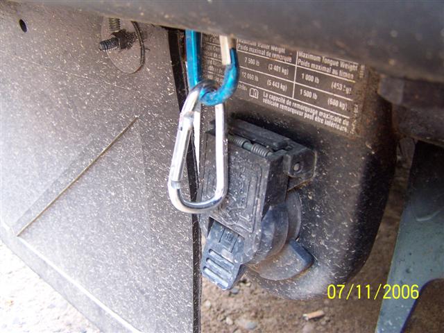

Where do you guys hook the breakaway cable on your trailer?My new trailer had the cable inter twined in one of the safety chains and that can't work that way.If the safety chain jumped out there would be nothing to pull on the cable.Attach to hitch on truck or bumper?.
Thanks. Getting ready for 1st tow and a bit nervous.

Which will not work if the ball breaks off. The reason for having safety chains and breakaway breaks is to have redundant and INDEPENDANT safety systems. I use a spring loaded clip (looks like the caribeaner that a climber uses) to attach the breakaway cable to my truck's frame. The whole hitch couls come off of the truck and the trailer brakes will still activate. You were also right that the cable should not be intertwined with the chain or anything else that could cause it to tangle and not activate the brakes.

The breakaway cable should be attached to the vehicle, not over the ball or the hitch frame. What good would that do if the ball or the entire hitch frame assy. came loose from the truck. The breakaway cable would not activate since it is still connected in this case. It should be somehow attached to the truck. I use a spring loaded clip (the kind used for key rings) attached to the bumper.
