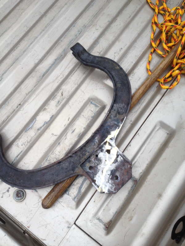

It has been a while since I have been here hope all is well. Had guy bring this fun little project by thought y'all might enjoy it.
Finally got it clean, Someone dropped a lot JB weld on it and tried to wipe it off with caulk.

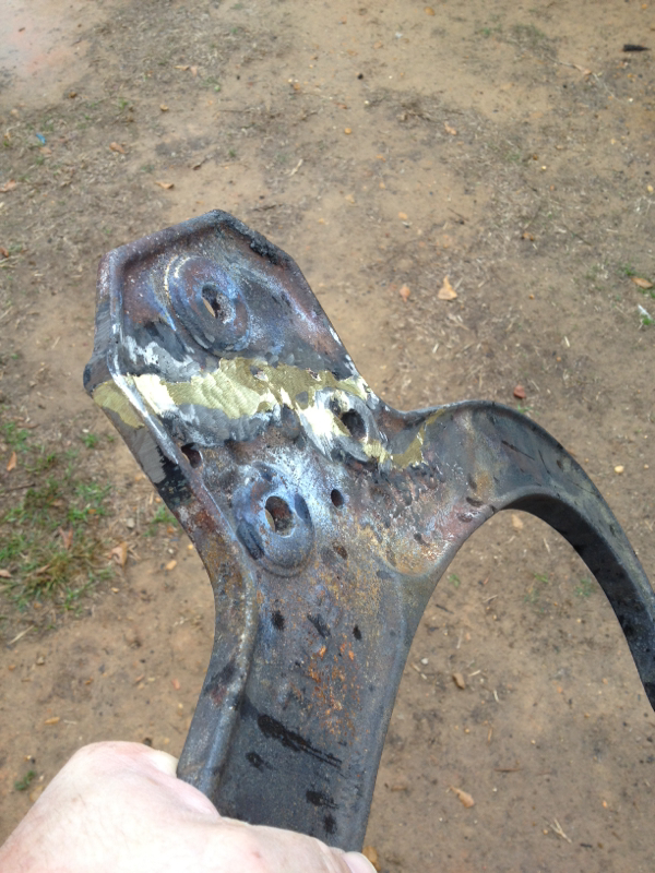

Close up of the weld that failed, lots slag left behind. A decent welder would taken it with him.
I just slapped some brass on it, if it breaks again I will order some of that tv fix it stuff. Wish I had a welding torch, perhaps Santa will bring one. Y'all have a good one!

Jody what is the object? And is it cast iron or cast steel? Looks like you did a pretty good job brazing.
/ Brazing pictures
It is a crystal foundry #2 bell frame. I have my great great great grandmothers it is very similar (#3). It was also broke and I brazed it about six years ago. I think it's cast iron, not too sure though. I used a high strength flux (blue) and bare rod and victor cutting torch with 0 tip.

I actually thought that was what it might be, but wasn't sure. Well I think you did about the best repair that could be done on it. "paint it black, and it won't come back":)

i agree.. that's a very nice looking repair.
PS.. I think that yellow glue did a much better job than those alloy 'magic' brazing rods you see on tv.
I mean.. I've used them.. but that bras run around there looks like it will be much better...

Great repair.. The only thing I would have done different is Spray Powder. No worries on it breaking again though,.

Funny - we have one also - with the same type of braze to repair the same type of break.... Your braze looks great by the way!

Sweet repair...curious how you held the pieces aligned (flat) while brazing ?
