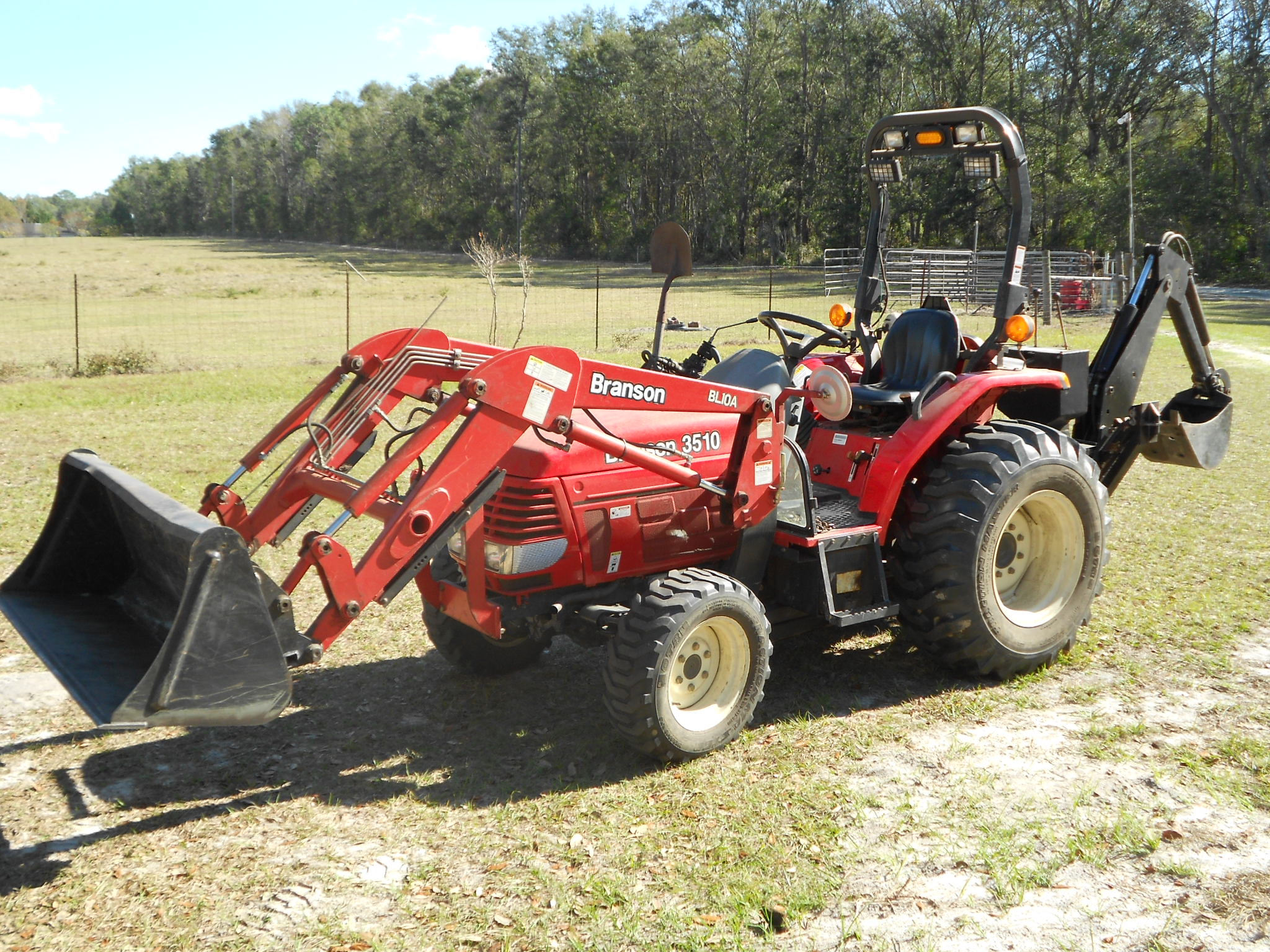

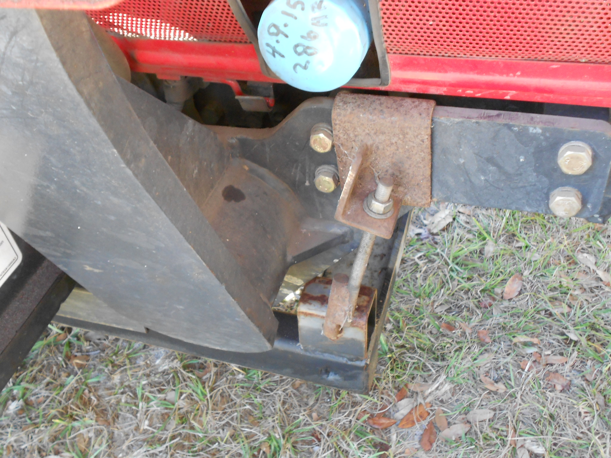

/ Branson loader question/help #4
Here are pics of my 3510 FEL.
The first might give you a clear idea of the original FEL and the second is one that I just happen to have of the FEL bracket mount to the side of the engine/transmission.
You can see how heavy metal that mount is made of and it has 6 bolts on each side.
In your pic you need a heavier cross member than you are showing and it needs gussets to stiffen it.
Thank for the pictures and sugestions Stimw.
My tractor has a mid mounted ROPS which makes things interesting when adding a loader. However the ROPS is built strong enough to have the loader attached to it. I will still add a couple for flat bar pieces going to the front of the tractor and also two more going underneath to the rear axle and I will also add a cross-member between the two loader mounts.
Yes, I will reinforce the crossmember. I might actually just weld 2 pieces of the rectangular tube together instead of a pipe, unless I come up with a thicker wall pipe.
Here is an updated design. I'm still figuring out the loader mounts.
