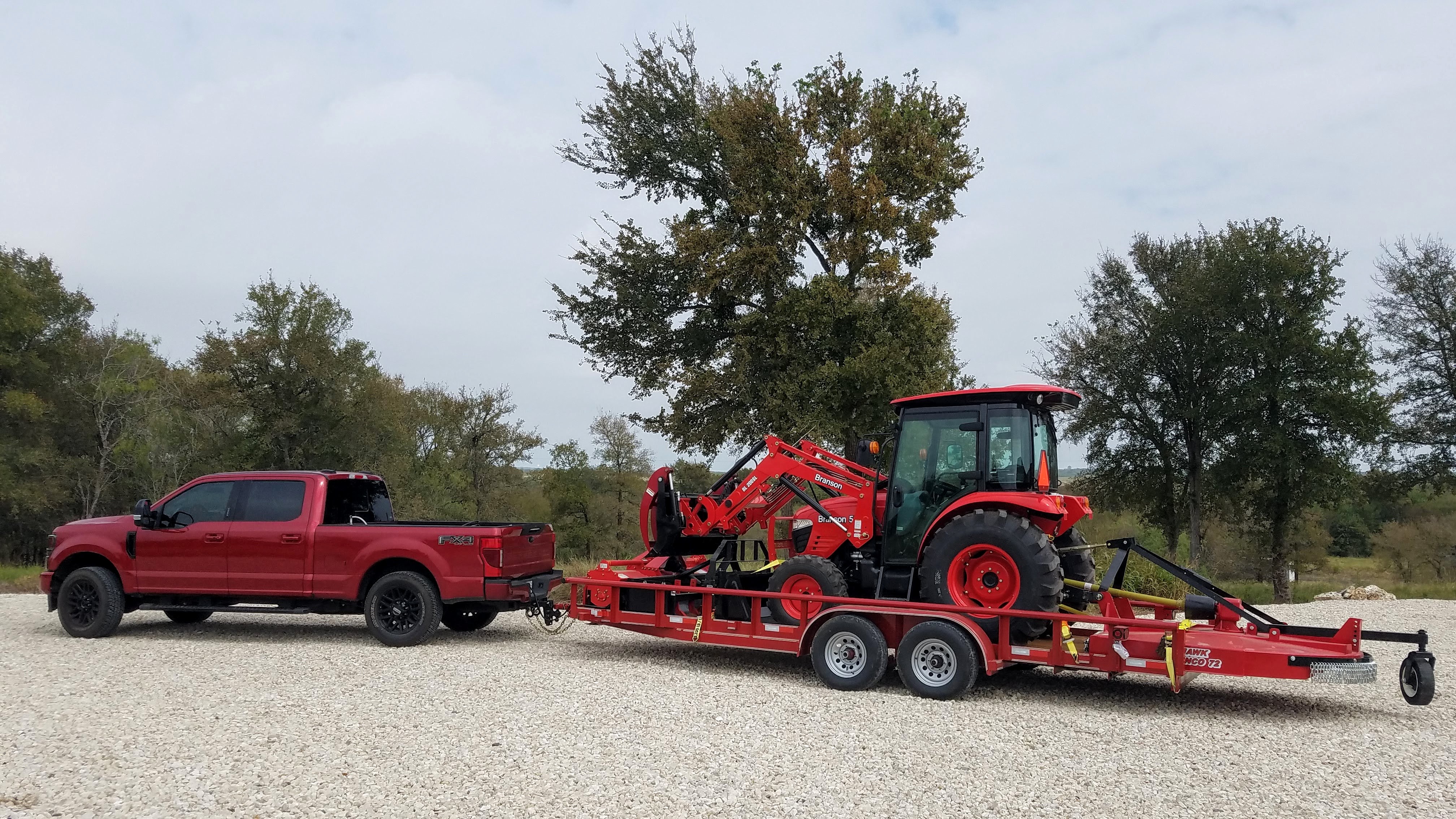

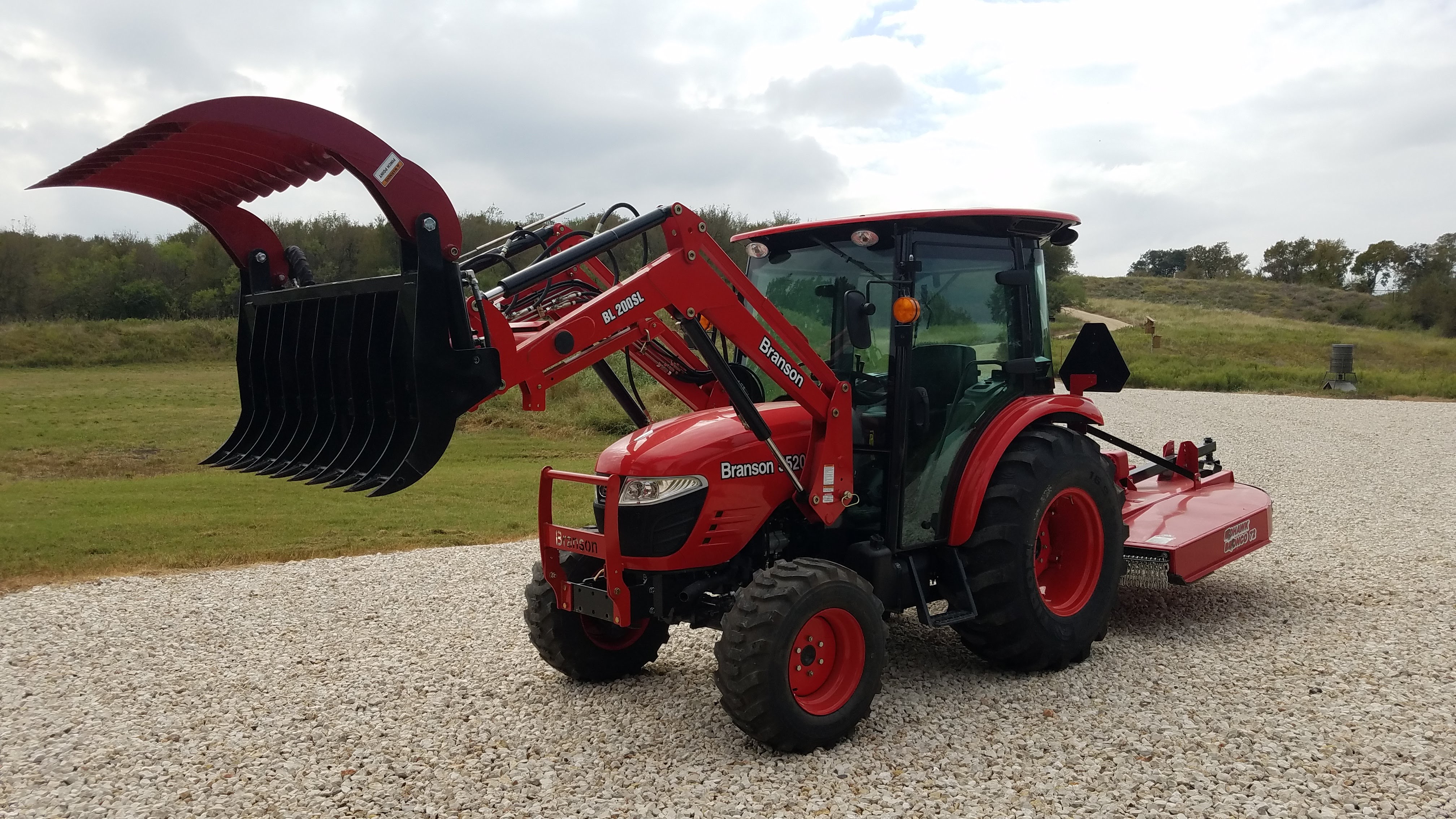

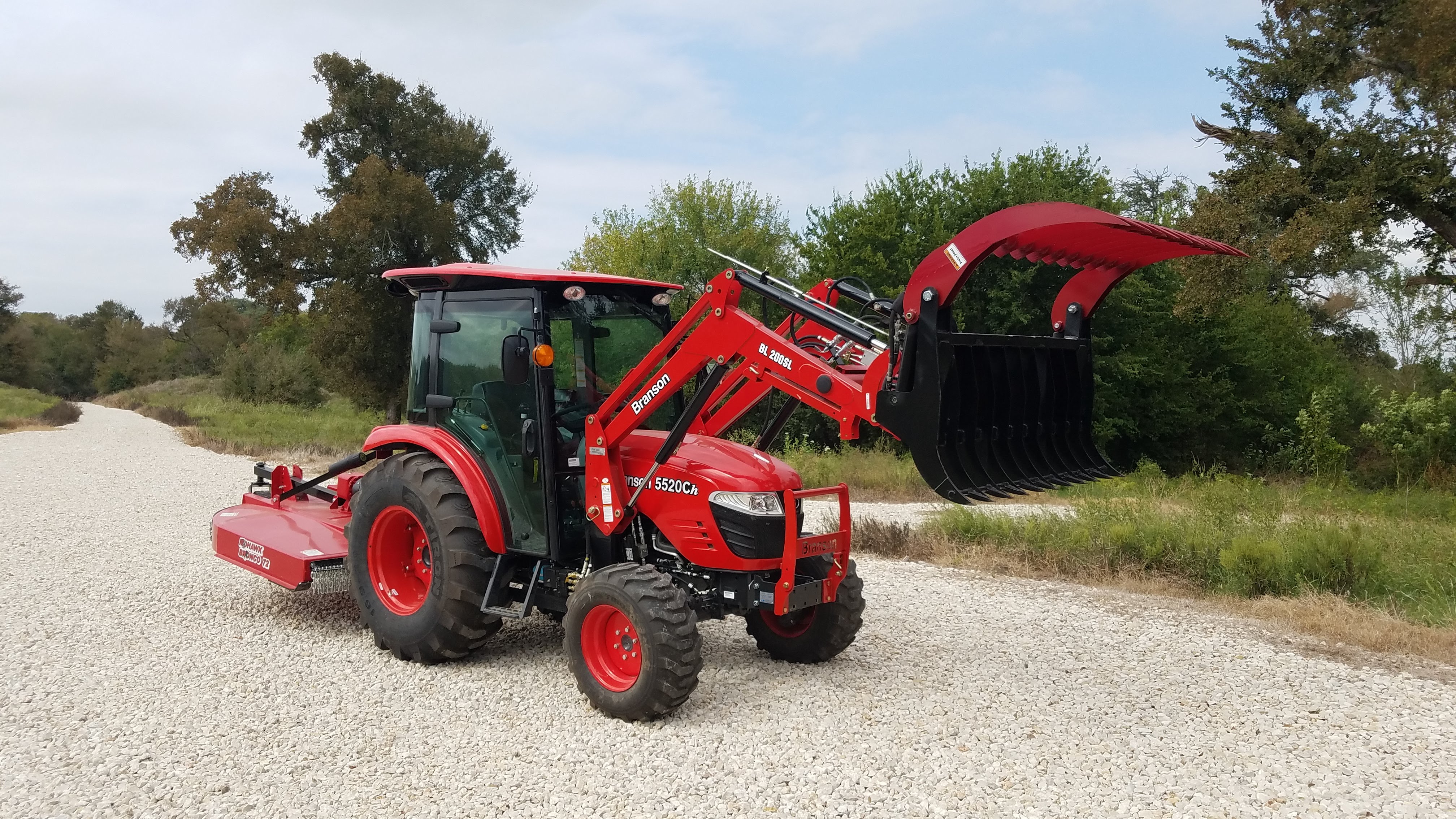

In the end, I picked up a new Branson 5520CH with BL200SL Self-Leveling Loader on Saturday, October 18, 2020, from Epperson Tractor in Lorena, Texas (near Waco).
Dealer welded three hooks on the loader bucket and installed third-function valve to drive grapple, auger, and other hydraulic front-end attachments.
Dealer filled the tires with products I ordered online, and filled the rears to 75% with water on top of the mix:
+ 20 gallons of Propylene Glycol Boiler Antifreeze from Chemworks, and 1-gallon of corrosion inhibitor (10-gallons plus 1/2-gallon for each rear tire)
+ 10 gallons of Multiseal Hydro 1500 sealant that mixes with ballast (5-gallons for each rear tire)
+ 2 gallons of Multiseal Pro HD 2500 sealant (1-gallon for each front tire)
Implements purchased with the tractor include:
+ Armstrong Ag BGR Mini 60" Grapple
+ Titan 4000# Pallet Forks
+ Ag-Meier Bronco 72R Rotary Cutter with slip clutch and guard chains
+ Ansung ER074 Rotary Tiller with slip clutch
+ Armstrong Ag 6' Standard Box Blade
+ Premier MD09PHD Hydraulic Auger Drive with 2" hex coupler and 9" auger
+ and Falcon Super Duty II 83x20 10K-lb Trailer to carry it all
Out the door, base tractor with standard loader was $34K; adding the third function valve and upgrading to self-leveling loader brings the tractor total near $36K, and then add $12K for implements and trailer resulting in a total of $48K. Add ballast and sealant plus several round-trip ~4+ hour drives to visit dealers and we're near $50K all-in. Christmas comes early in Texas! A lot of hard work saving over time for this purchase. Now we start again and work toward a shed for the tractor.

Very Nice rig MadGunner! Congratulations!
   / Branson 5520CH vs Kioti vs Kubota for new tractor owner #8
That's a nice rig! Congrats on your new tractor!
You did an awesome job describing the entire process, reasons behind your choice, prices and so on.
Also, that hydrostatic transmission hooked to a 4 speed synchronized range gear must be really nice.
   / Branson 5520CH vs Kioti vs Kubota for new tractor owner #9
Nice setup, congrats. Thanks for sharing pictures.
   / Branson 5520CH vs Kioti vs Kubota for new tractor owner #10
Nice looking setup.
If you have any thoughts about adding the bolt on cutting edge I would recommend doing so immediately,
as soon as you do much with the bucket and get a few dimples in the bucket edge it will not fit well.
