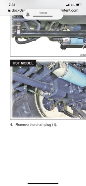

Branson 5520ch
Trying to find servicing information on a Branson 5520ch.
Changing engine oil, hydraulic and HST oil.
Found the engine oil plug.
Found the hydraulic oil plug.
However there is one more plug forward the hydraulic oil plug and higher.
I think it is for the HST but unclear.
All three plugs are painted yellow and are 17mm.

   / Branson 5520ch Oil Change Drain Plugs #2
There is only one drain for the hydraulic fluid that I see. The HST shares this fluid with the hydraulic system.
   / Branson 5520ch Oil Change Drain Plugs #3
Then again I forgot you have the new model so the location may have changed.
