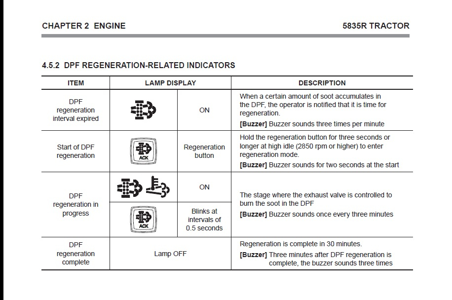

I don't have the manual for the new 20 Series but I have the manual for the 5835 that uses the same DPF and processes related to it.
The 3 beeps along with the light flashing indicates indeed that's asking for the regen. Check picture #1.

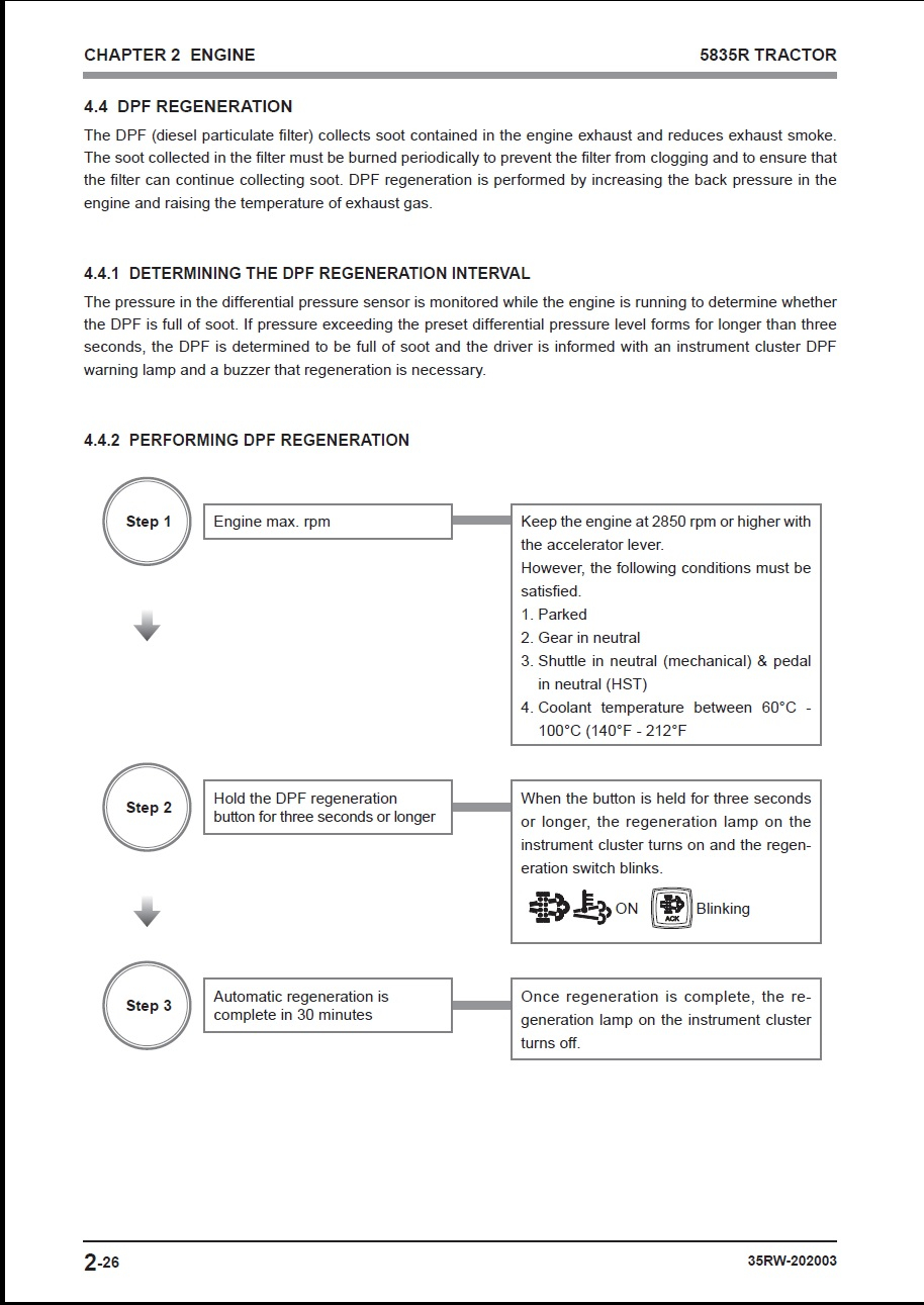

On the second picture, there is the steps needed to start the regen process.
I hope it helps. Let us know how it goes.

Perfect, appreciate it! I've been running all over the farm looking for where my manual wound up.
I'll try to trigger the light and will follow those steps now before it gets too late.
My regen button lost the little plastic button cap courtesy of my daughter sitting on the seat, but I imagine I can push it with my finger still.
I'll let y'all know how it works out
   / Branson 5520 - Beeping 3 times + Exhaust light on
Followed those directions. Got it into the regen mode at 2900RPM, golly that seems high, whew!
It's doing its thing, will check back on it in 30 mins.
   / Branson 5520 - Beeping 3 times + Exhaust light on #10
Checked back after 30 minutes, regen lights are off and tractor seems to have more pep. Looks to have worked. Thanks all! First regen complete.
