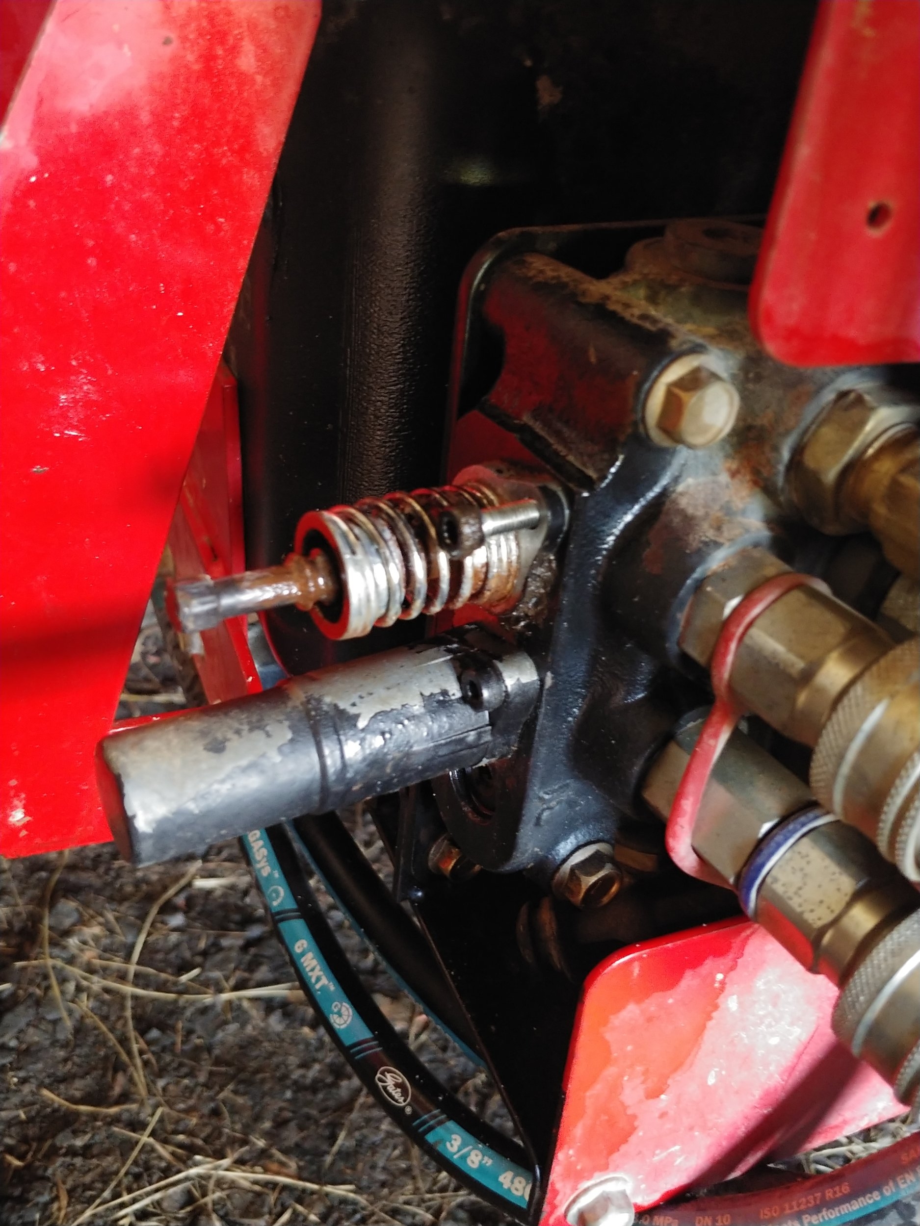

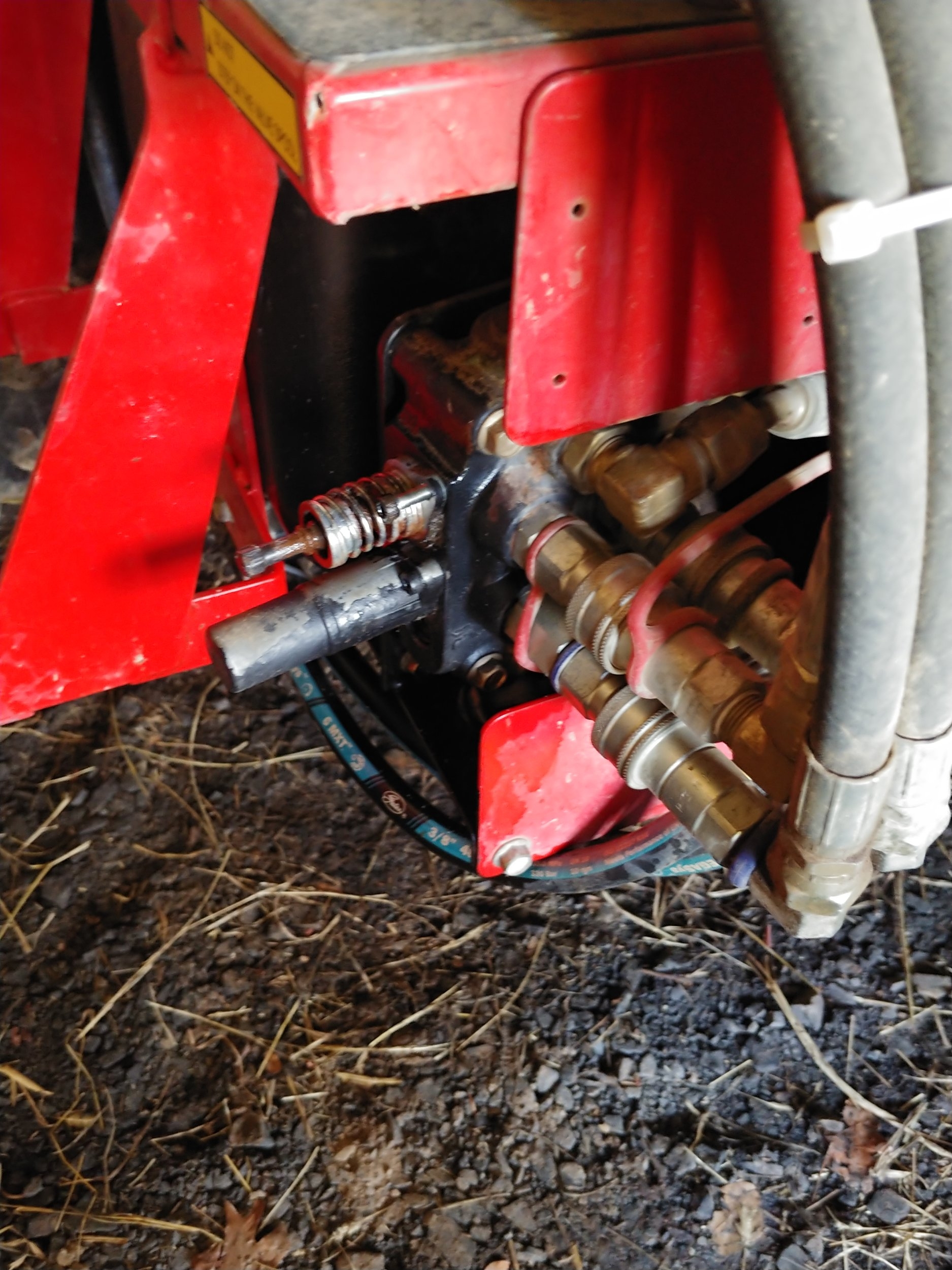

Need some help finding a spool end cap for a 2014 Branson 5220r FEL hydraulic valve, picture attached. Dealer of course said their solution was a new valve for $1500. Does anyone know the manufacturer of the valve? I think it's a Besco, but I'm guessing.

You might be able to make a cap for it if you can't find one. What is the diameter of the valve?
I could be wrong but, looks like a hydraulic pressure control valve on a distribution block...? Can you not just buy a new pressure control valve?

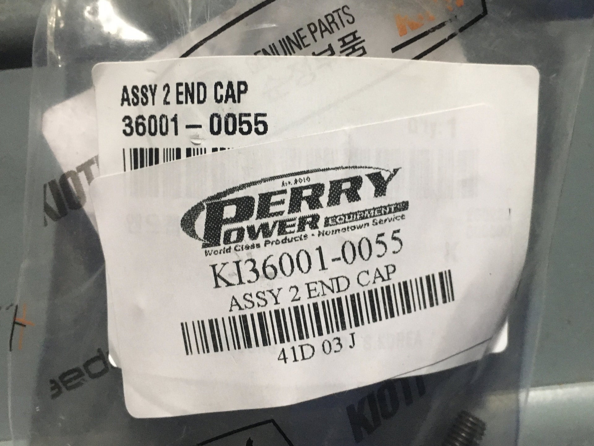

Found one on eBay that appears to work. The original is a pot metal brittle part that is exposed underneath. Hope this works.

Found replacement parts on ebay that should work.
