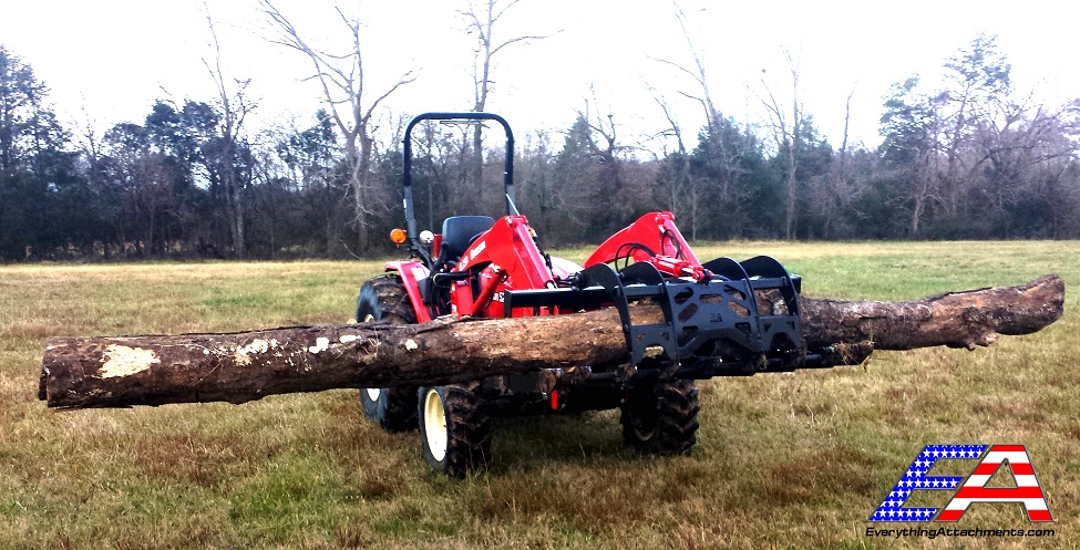

Most customers easily install the WR Long 3rd Function Hydraulic kit without any issue. Everything needed is included and it's custom to the tractor/loader you have. We're currently offering a $50 coupon code when you order a kit and grapple at the same time.
Obviously, my favorite grapple is our Wicked Grapple. I'm a little partial to 60" Single Lid because of the many pics and feedback I've received, but some applications call for different sizes and configurations. Personal preference comes into play as well.
Here are the choices. You'll absolutely LOVE it!
Single Lid Wicked Grapple

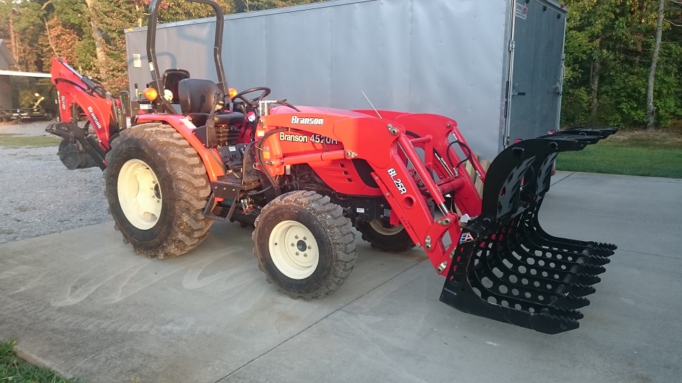

The bottom two pics above are my tractor. Install of the WR Long kit was easy enough. I did ultimately shorten the supplied hoses. But I was glad to have a bit extra rather than not enough!
   / Branson 4520R - Third function hydraulics #5
Sidecar,
Not to derail the thread, but couldn't help noticing your rear tire clearance to fenders is almost nonexistent. Is that the stock configuration, or did you modify your rims, or change your rear tire size?
Also, like your place, looks nice.
   / Branson 4520R - Third function hydraulics #6
Tires are stock, clearance is better than it looks in the photos about 2" at the closest point.
Thanks for the complement, East TN is a great place to live. The property needs attention and I've picked the best tools I could find for that. The grapple was great for removing that tree (and many others) it will get some use this afternoon too dealing with a couple of blow downs from recent storms.
