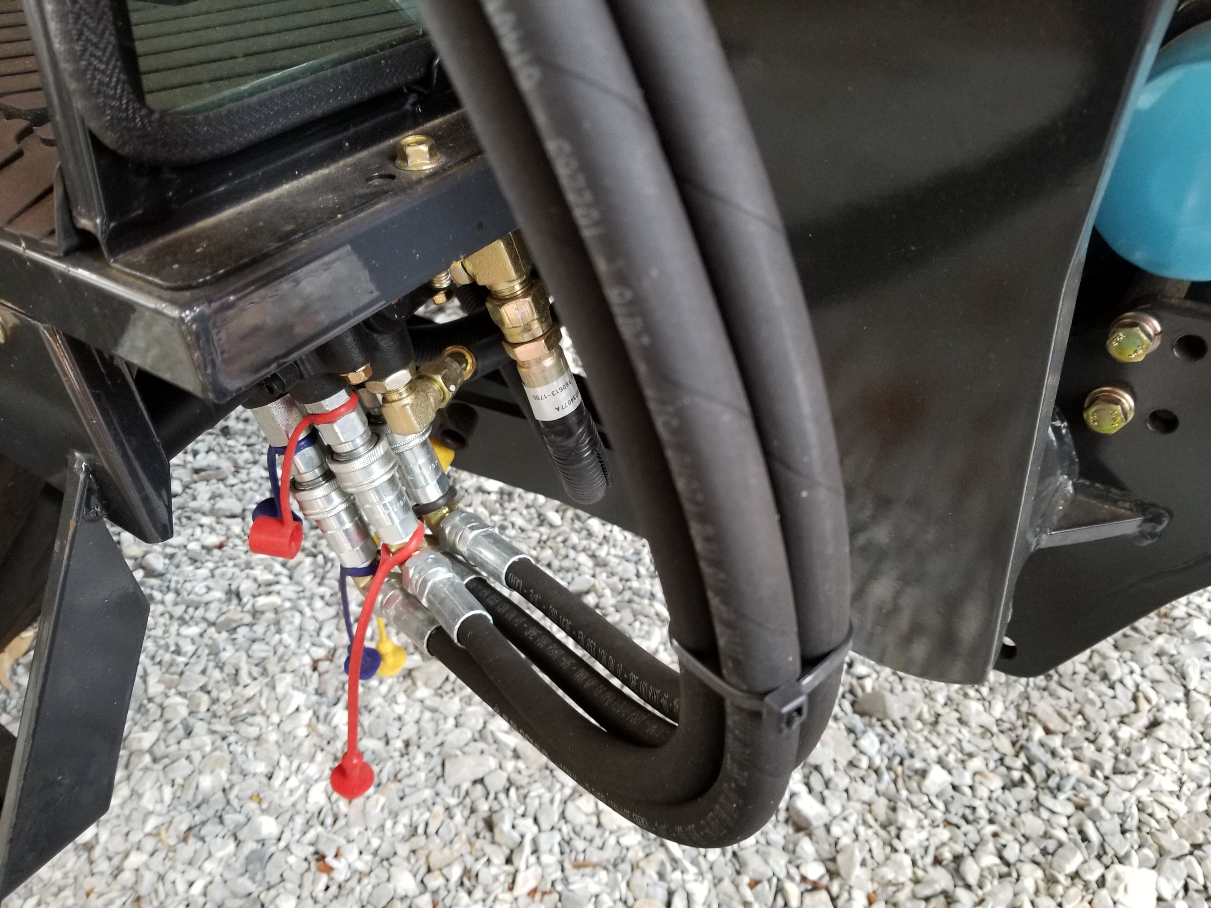

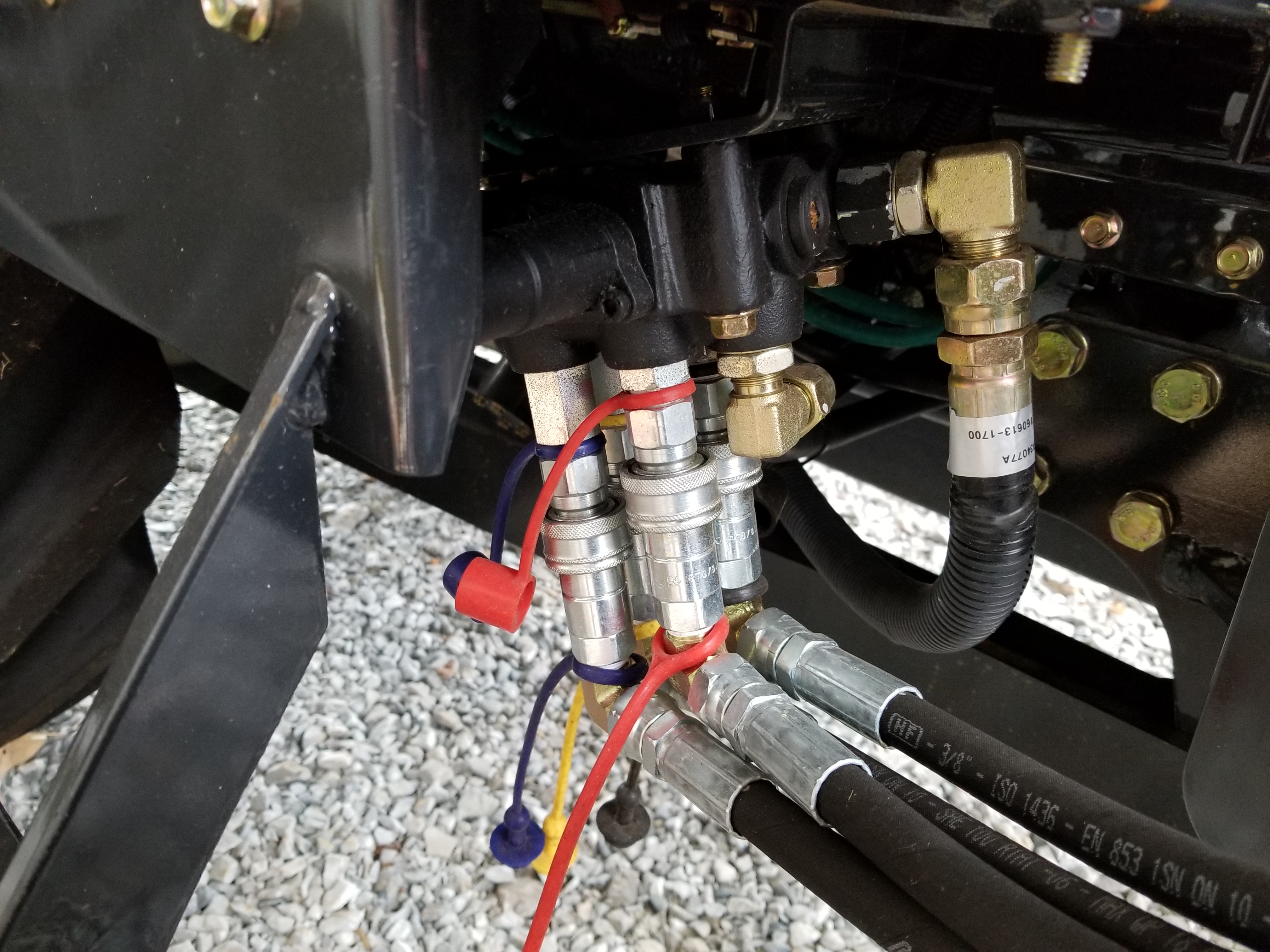

Hey guys, got my Wicked Grapple in and just got my WR Long 3rd Function Remote.
Now I am trying to identify my power beyond port. I have a Branson 4520R with a backhoe and BL25R FEL. I took a few pics of the loader valve. valve 1.jpgvalve 2.jpgView attachment 536794
   / Branson 4520R Power Beyond Port Identification #2
Looking at the first picture, it should be the 1/2" line with a black adapter where the 1/2" elbow threads in, this should be the power beyond adapter. I'm just guessing by looking at the pictures. An easier way to check this is to crawl underneath and check where each line goes to. The power beyond line, on my tractor, goes to the remote valve on the rear of the tractor and then feeds the 3 point hitch.
   / Branson 4520R Power Beyond Port Identification #3
Hard to be certain, you should have 7 lines total,4 for the loader, then of the other 3, one should be a feed from the pump (supply), one to the chassis of the tractor ( the hydraulic reservoir) (return) and the third one should go on to either rear remotes if you have them or the 3 point hitch, that would be the (power beyond).
