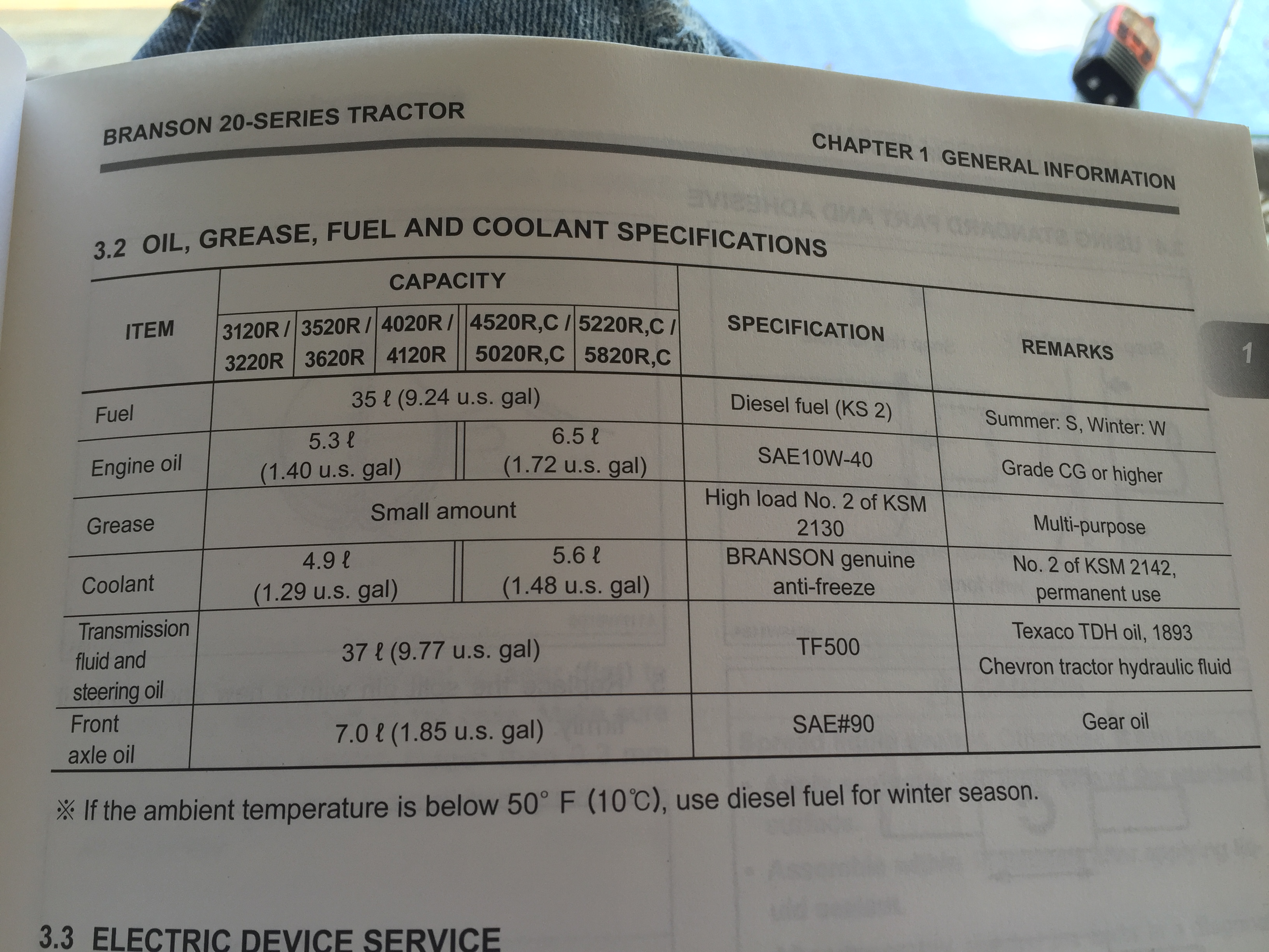

Unless I missed it somewhere, all my manual says is "a good quality tractor hydraulic fluid"....
   / Branson 4020R 50 hr service #8
It could. I've looked at three different Branson manuals and the tractor fluid spec is different in each one. But all three listed only specific brands, and the only one that was common across all three is the Texaco 1893. I suspect that any good "regular" THF like Kubota UDT would be ok. My dealer said not to use Super UDT so I think the low viscosity THFs are out. Mine doesn't whine on the factory fill so I don't feel the need to improve it.
On a new tractor under warranty I'd want to stick closer to what's in the manual. After that, good quality regular THF.
   / Branson 4020R 50 hr service #9
So here's this:
   / Branson 4020R 50 hr service #10
I was going to use Chevron THF1000 as the local NAPA stores said they could get it (I checked before I bought the tractor). It's not in my manual but I'd seen it in others. Last week when I got around to ordering it, it's no longer available. I ended up ordering Mobilfluid 424 off Amazon. It's specs are nearly identical to the THF1000 and it's listed as a replacement in a number of cross-reference charts.
