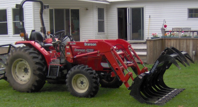

I have had my Branson 4220i since last spring. It has been bullet proof. I have 50 hours on it and getting ready to change the oil. I got the filters and oil from my local dealer. I cross referenced the filters to the Wix numbers and looked up prices on the internet. No price difference. I have a grapple bucket for mine and use it when doing my firewood. The unit has been flawless.
