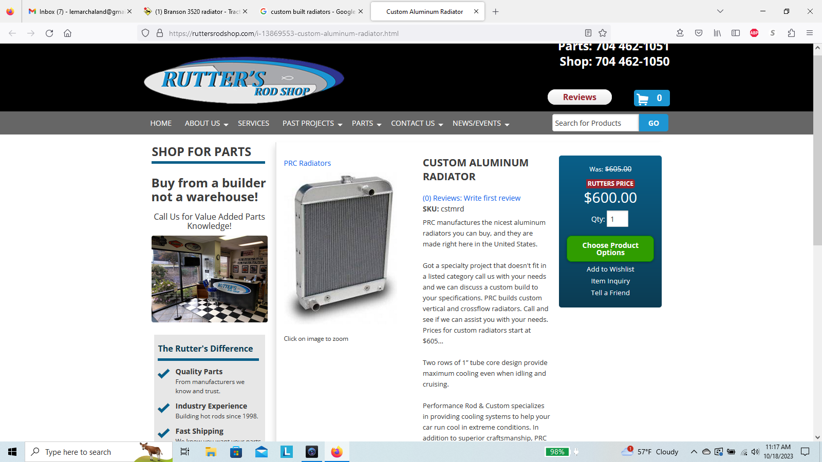

Been needing a radiator for my Branson 3520, not wanting to pay $1000 dollars for it from dealer, wondering if anyone might know where I could find a used one or aftermarket one. I have found a few aftermarket radiators that look to fit but does not have the 3/8 line at bottom that goes to engine block. Any help is much appreciated

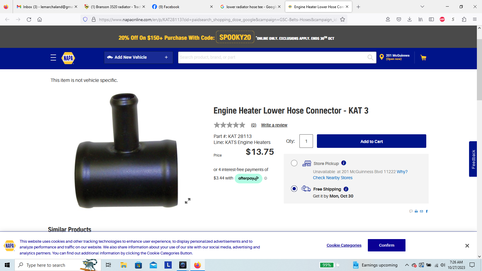

Just wondering if the 3/8 line to block can be eliminated? Plenty of aftermarket radiators out there but none have I found with this on it.

Have you priced getting a custom built radiator?

So if you buy new and it is 1k
And new aluminum built one is 2k but probably won’t go bad as long as you keep everything cheeky hmmm

Is it to bleed air from the block? 3/8 isn't going to flow much coolant.
If you're confident it's to bleed air you could either do the bleeding another way like opening the thermostat housing or run it to an appropriate fitting. Like get a tee that goes in the upper hose and has a 3/8 nipple.
   / Branson 3520 radiator #10
Some thing like this would work as well as a line from the radiator, just install in the lower radiator hose;
