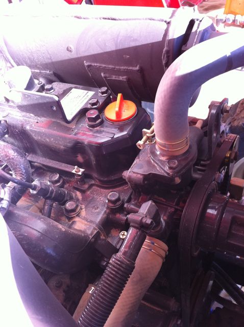

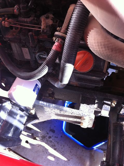

  3. I changed the Engine oil and put in 15w-40 oil for diesel engines, when filling, I noticed that there are two orange caps labeled "oil" on this little engine. I filled from the top cap, but what is the other one for closer to the front and on the right side of the engine? (see pictures)

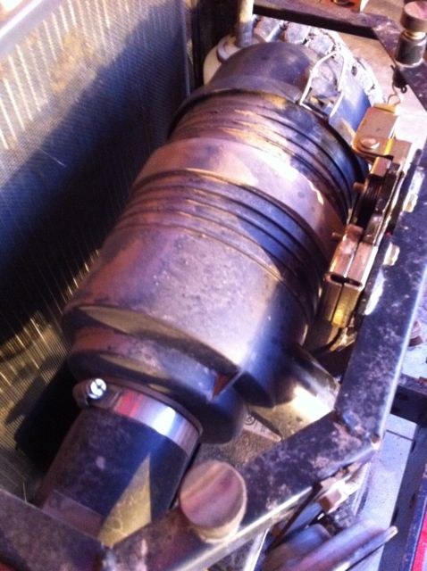

  5. Air filter: whats the best way to get the air filter out of it's cylinder? Is there a trick, or should I loosen the hose clamp, take off the rubber bungee, and pull the whole thing out so I can get the filter out?

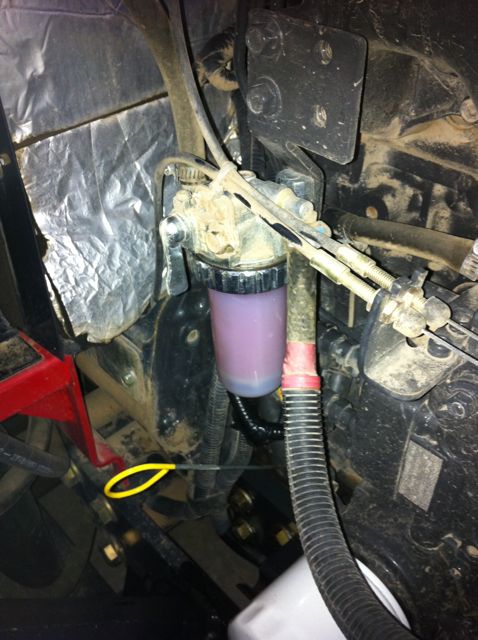

  6. Fuel filter: this one seemed pretty straight forward and was an easy change, but I'm curious what the petcock is for? I assumed that it turned off the fuel and moved it up 180コ before I took off the filter bowl, then moved it back down after I got the new filter in.

I used TSC universal hydro/gear oil in front and rear. The front was filled and drained from each outer area as you have done. I do not recall a drain in the center pot. I fill my oil from the top cap and I don't know what the lower cap is for. My air filter is on the other side and can be removed by opening up the clips; yours doesn't appear to have the clearance so it looks like you need to loosen the clamp and remove it as a whole unit (Make sure the water drain is on the bottom side when you reassemble). I would assume the filter petcock is so you don't leak additional fuel/ and siphon back to the tank when you service the filter. The hose barbs on mine appeared glued in and came loose after a few years, you might want to think about a different assembly.
