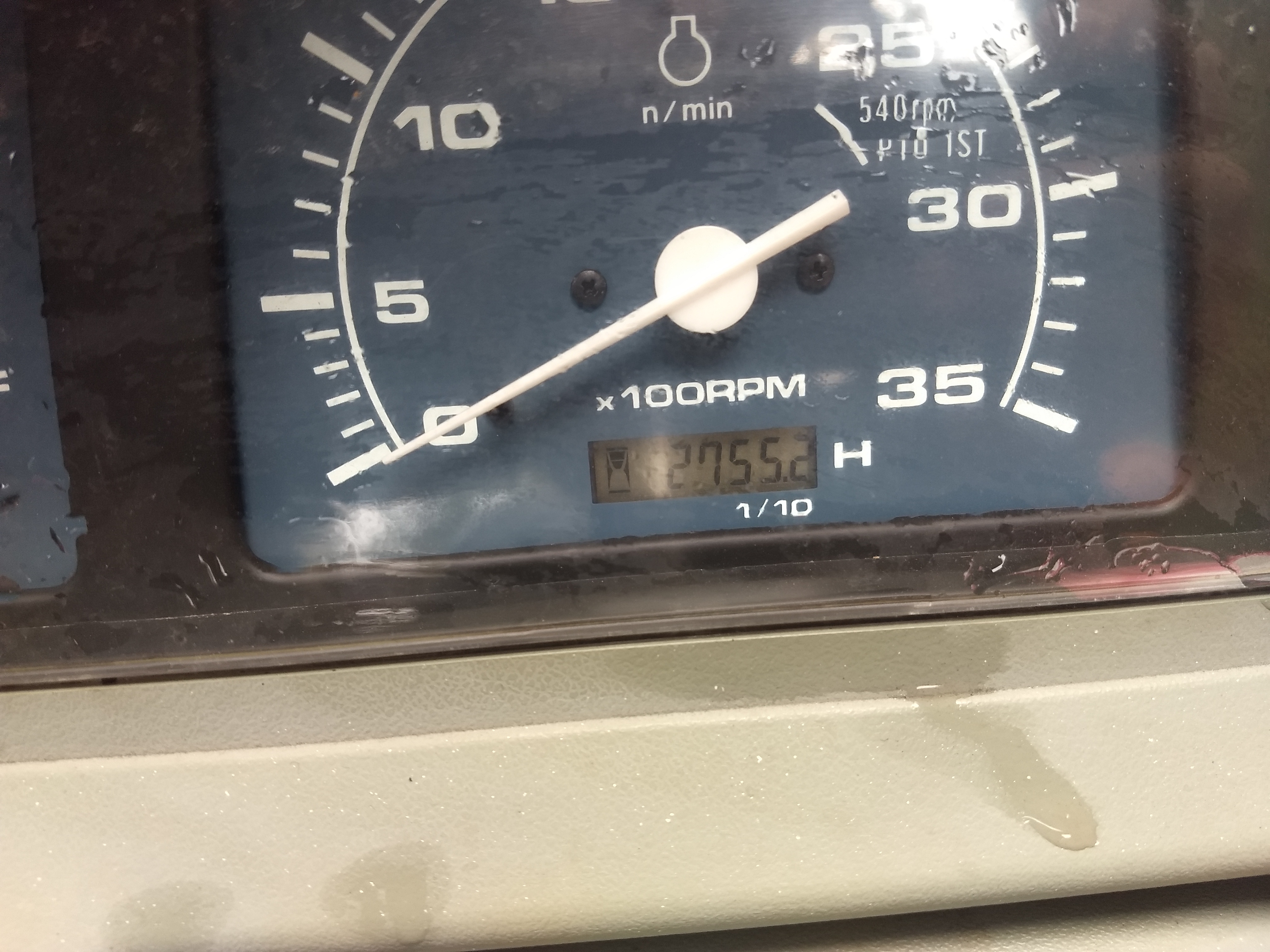

It has 256 hrs....not much for the age of the machine I would say.
I'd take it to a tractor repair place or see if someone could come by your place if you can't transport it and let them figure it out.
This is mine after 10 years of self employment with it.
