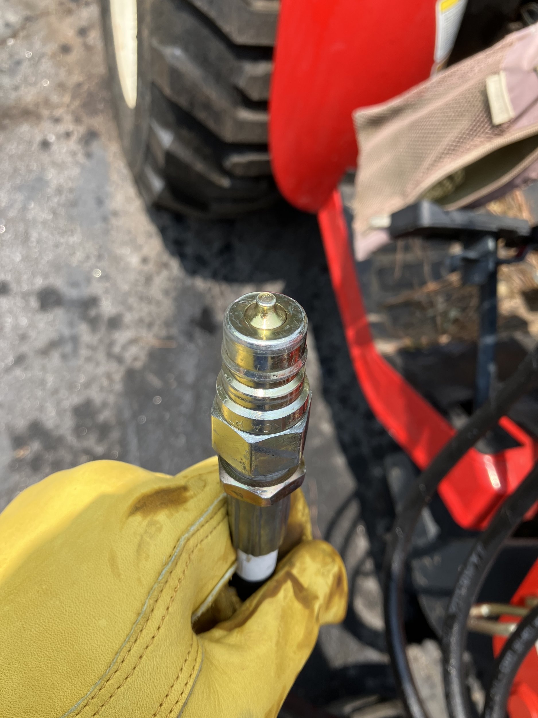

I have two simultaneous problems with my front BL100 Loader hydraulic lines. I was attempting to detach the front loader to be more agile in the forest.
Anyway, I did it all wrong, another story.
So, I detached all 4 hoses before realizing the color coding on the female ends were all rotted off. So I have no idea which make ends go to the female connectors.
Second issue, one of the male ends, it won’t connect. The nipple that depresses won’t budge. The other 3 I can depress with my thumb and they connect fine.

Well, my old man squared me away. It was the bucket still being off the ground that was putting too much pressure on that one male end connector. He suggested I jack it up to relieve that pressure, and sure as **** the quick release accepted it just fine.
And I get lucky plugging the connectors in, they work, the bucket works like it’s supposed to.

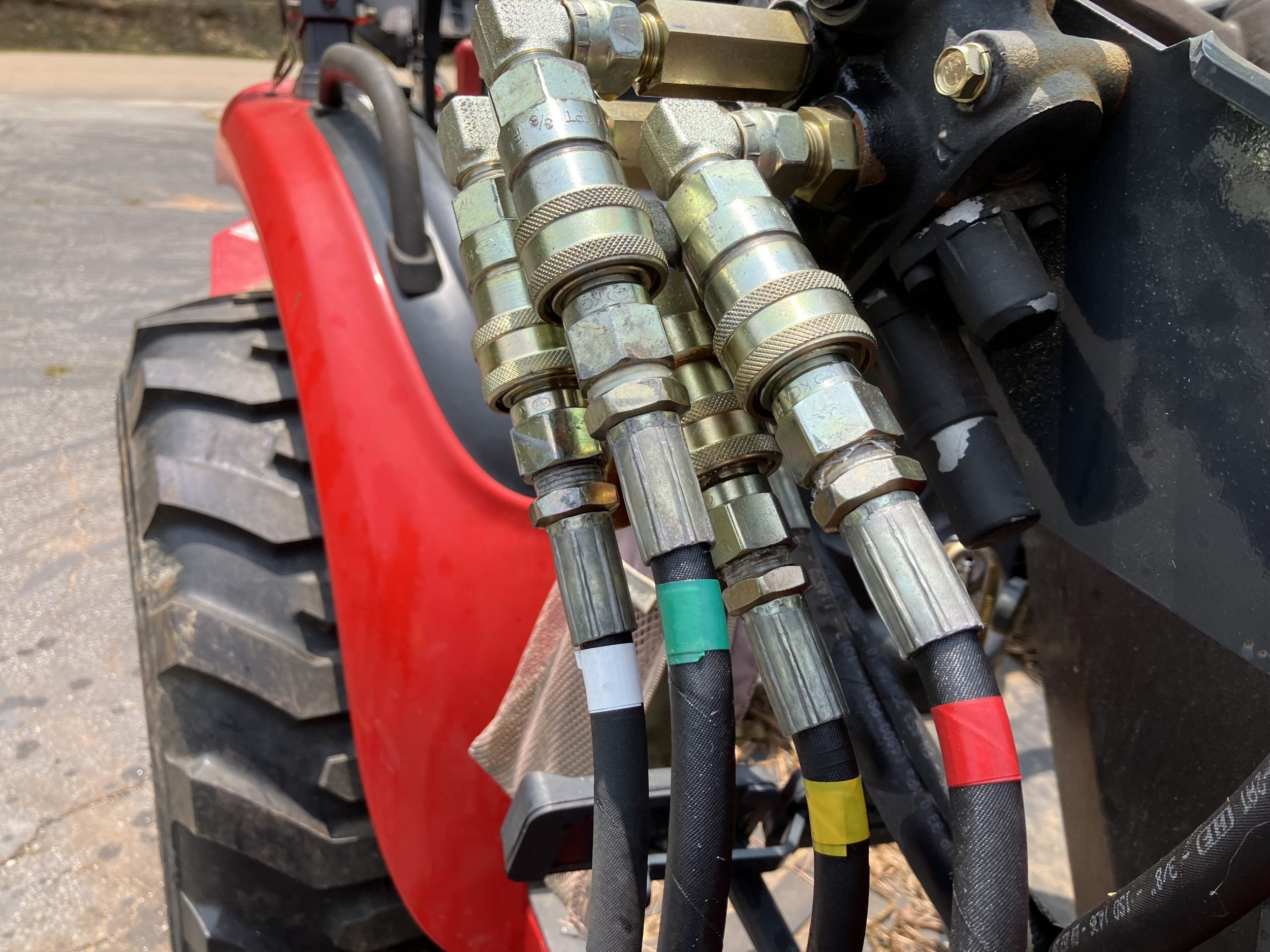

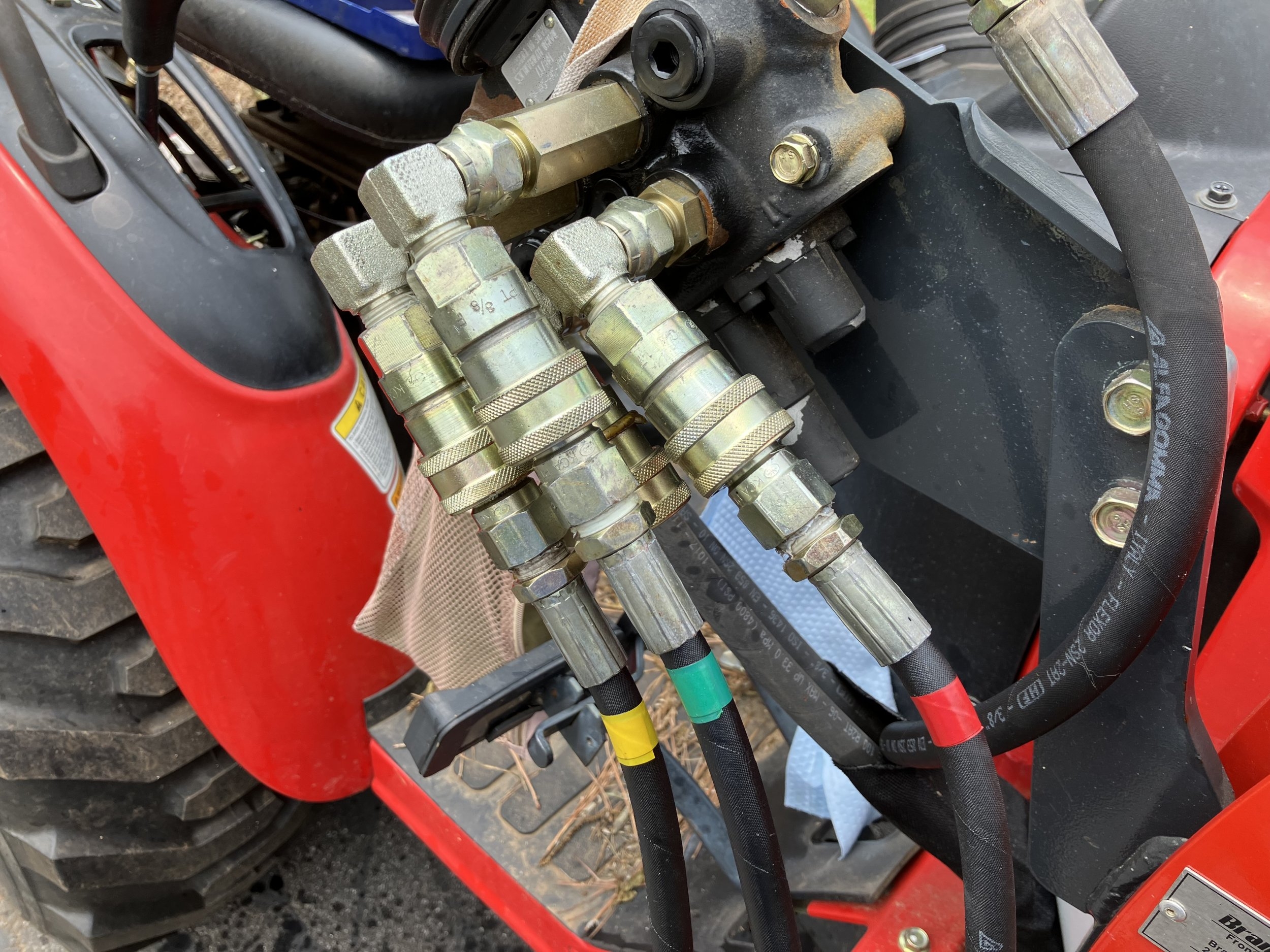

And I’m going to link a photo of the hoses connected for future reference, if anyone has the same problem.

Get some colored zip ties and mark the female connectors so you know the next time.
