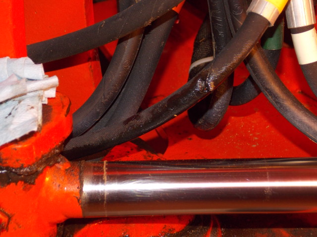

Now that I'm old, I say, "Be thankful for any problem that can be fixed with a little money or time." Too bad it happen, but be happy that it happened while under warranty and that you have a responsive dealer making good. It's a good thing to cycle all your hydraulic controls on a new machine and see it any hoses are rubbing. I found out the hard way. I cut a hose on my BX-25 that must of been rubbing since day one. Another poster mentioned that the loader stand had been rubbing against his metal lines and almost cut into them. As I don't remove my loader, I removed the stand.
Hope you have nothing but fun from here on out. Attached is a pic of my cut hose.

Sorry to hear about your trouble. My 2620 has a line to the fel that looks rubbed. It wasn't as bad as yours so I taped it and it has held up for almost three years. I'm thinking that when the loader is shipped from Georgia (or wherever) that the packaging leaves a bit to be desired. The 26 hp motor is a working fool however. Mine starts right up and does whatever I need it to do.
