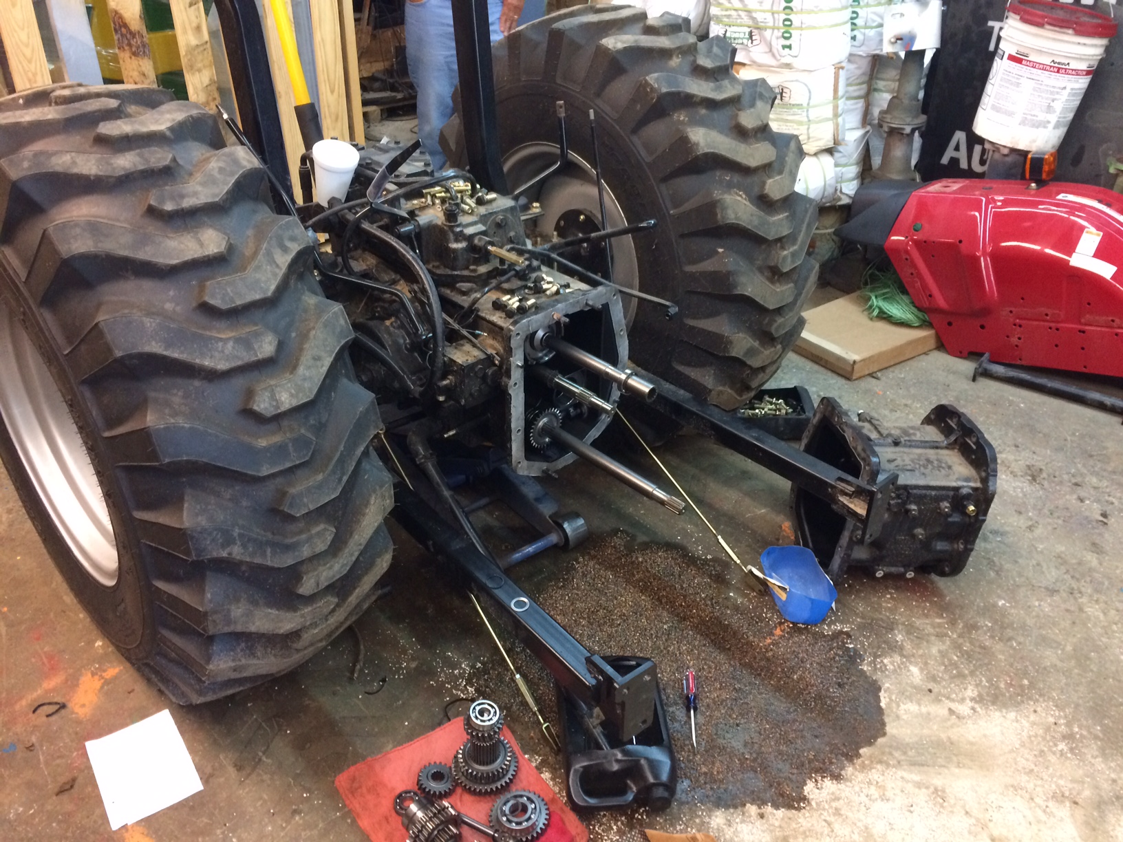

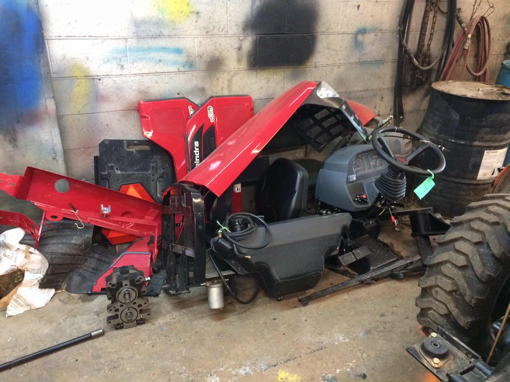

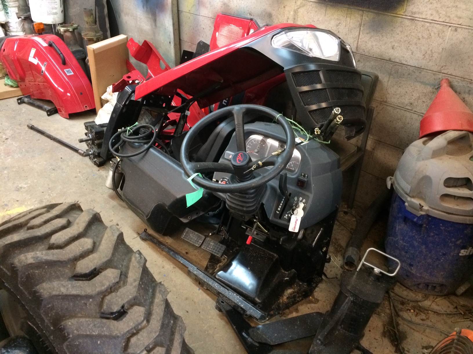

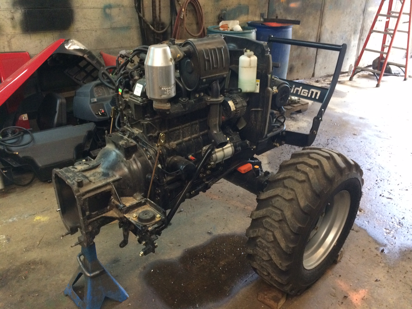

Well, I went to the dealer today to check on the progress. This is what I found. I won't say anything bad about the dealer because they are trying to get it worked out. This simply is what I found. Please let me know what you think and what you would do in this situation. mahindra 1.JPGmahindra 2.JPGmahindra 3.JPGmahindra 4.JPG

I feel sorry for you and for the dealer. This is a bad deal. All the dealer can do is to be prompt and do the job without error and without scratching up the sheet metal. Even then, if he does it perfect he is still sort of the bad guy for selling a tractor that failed in 17 hours. It's a no win for him, and certainly perceived as even a worse deal for the customer. As to what to do, I won't give my opinion as I will either offend Eddie or offend Mahindra with my suggestions. And I am very customer centric, so you can guess which way that would go.
Years ago when the 5010 first came on the scene, also built by TYM as is the 2538, we had a few problems with the range shifter walking itself out of gear on a downhill. It would only happen on down hills and only when the tractor engine was trying to hold back the descent. And even if you tried to hold the lever back, you couldn't. A clever Mahindra service rep figured out that the shaft that was holding the range gears had end play that was beyond specs. The shaft had space at one end for shims. He shimmed it to the correct tolerances and it fixed it perfectly. It was rare, but we had a couple of them out of the 50 or so 5010's that we retailed. In that instance, no one part was beyond tolerances, but each part was near the maximum tolerance and it stacked up and gave us grief. A couple thousandths here and a couple there and all of the sudden you have an issue.
On your 2538, if I were the tech, I'd be looking at this shaft, assuming it is built similar to the 5010 range setup. Probably they will replace the shaft and attached gears (out of an abundance of caution) and then shim to exact tolerances and this "blueprinted" transmission will be perfect.

Is it necessary to completely dismantle the tractor to get to the transmission? I feel bad for the dealer too. They have tons of time tearing this thing down, but I can't imagine that this level of teardown is necessary. He showed me a gear with very rough teeth and said that there was some metal in the trans oil. I'm afraid that simply replacing these gears is treating the symptom, not the disease. I guess the bottom line is that this machine is now a basket case. Everything has been removed...brake pedals, steering wheel, dash, all hydraulic controls, I mean everything. They told me that they'd have to split the tractor, but this looks to be more than a split. But, like I said, the dealer is working with me to find a solution and make it right plus it's not his fault it messed up in the first place. But as a dealer he gets stuck with the bad as well as the good.

Eddie, probably they had to go this far to get to everything. Shafts will often come out of the case longitudinally, hardly ever can they come out the top or side or some place that might be easy. For that reason, the transmission often must be split in a couple of places to remove and replace needed parts. It looks ugly, but it's pretty normal in the tractor world. If they have a good mechanic and they are careful, when it is back together you will be hard pressed to tell it has ever been apart. Once together, they should run it for an hour or so and get it up to temp and look for any leaks, etc.
