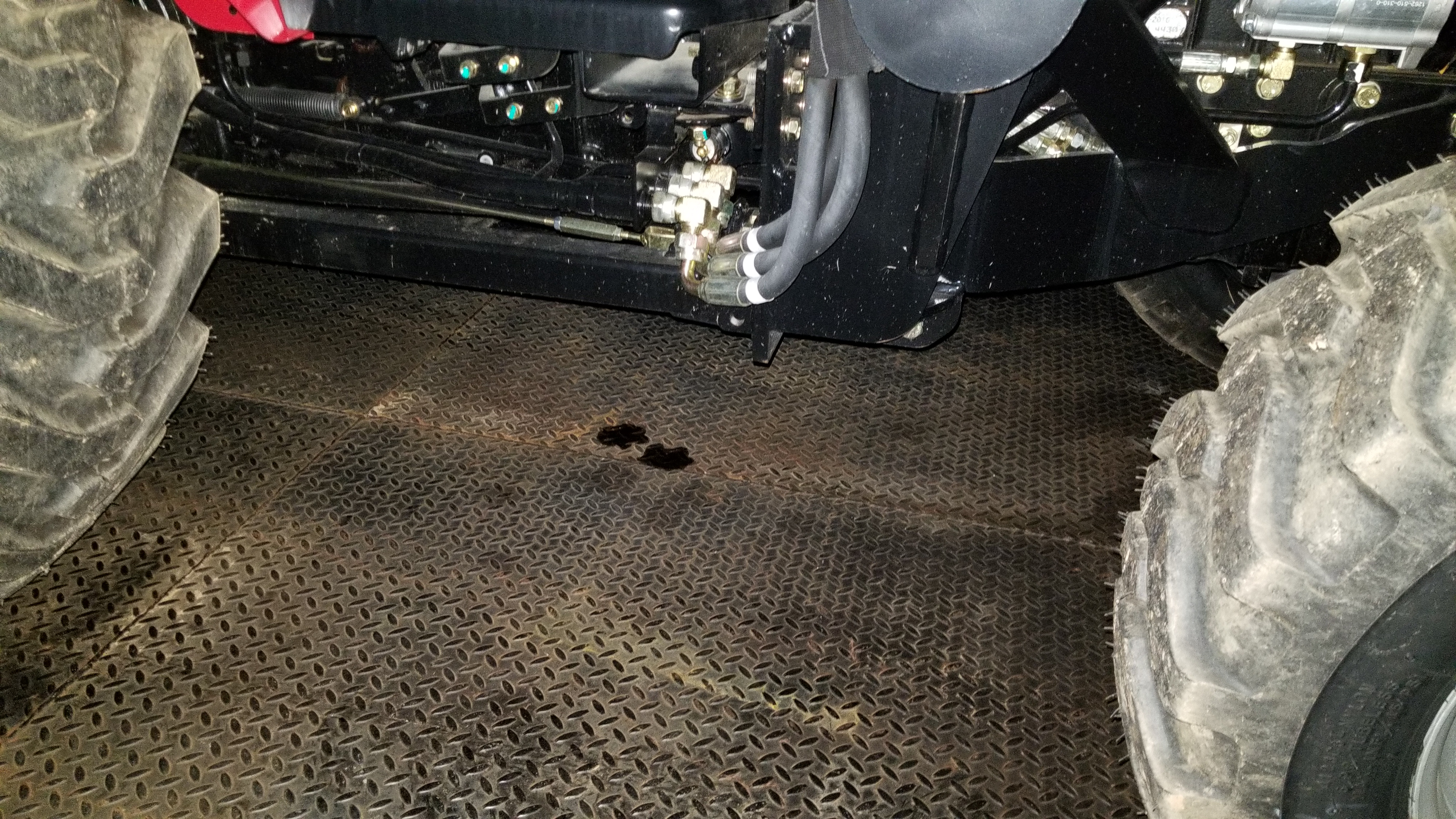

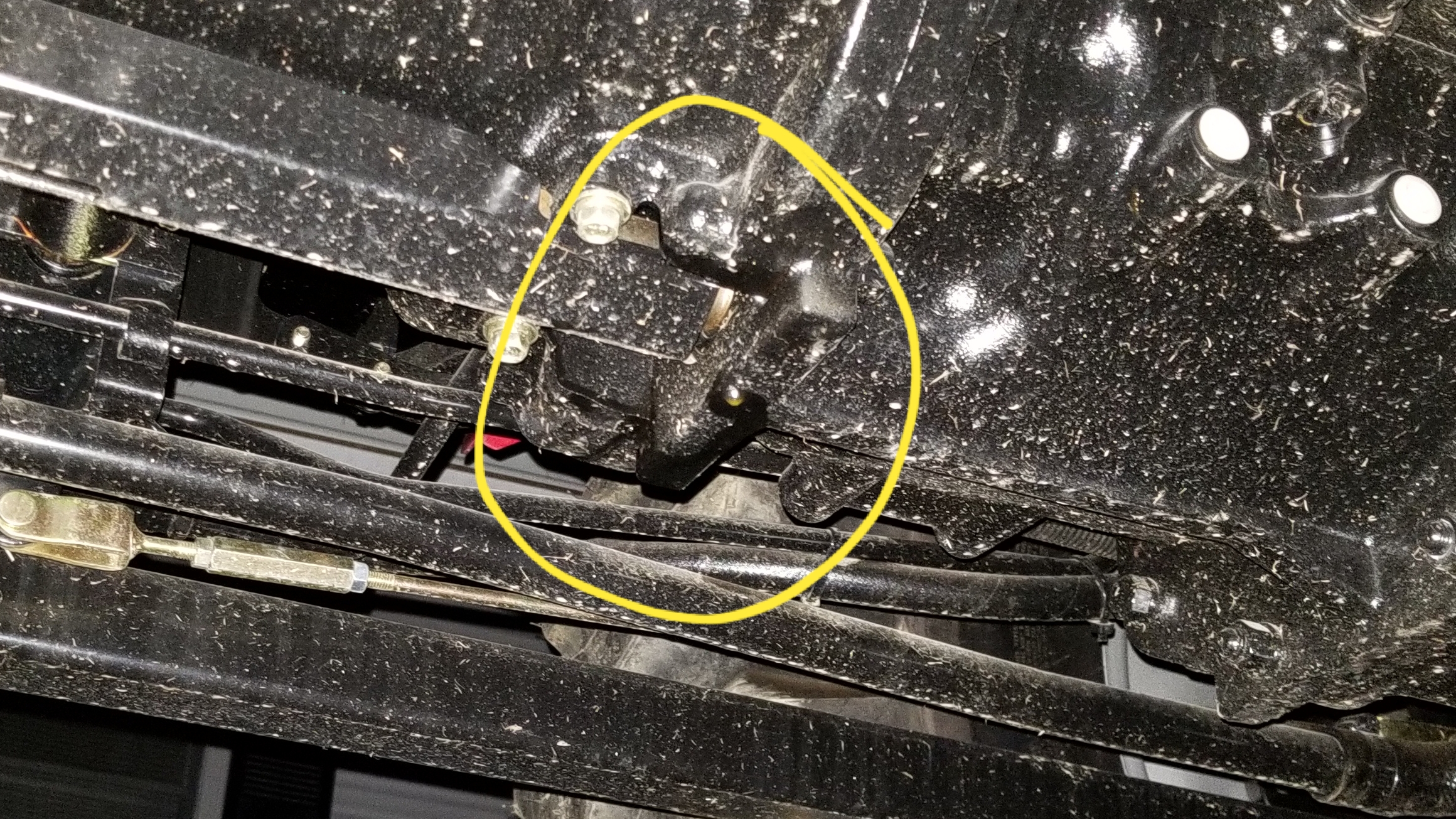

Hey guys, this is my first post since I just bought my first tractor on Friday. It has 5 hours on it. I left it on my trailer since I will be doing some work tomorrow and noticed it has a small leak. From the center of the tractor. I know it's hard to tell from the pictures but does anyone have any idea what it is. Call me crazy but a brand new tractor shouldn't be leaking anything. Needless to say, I'm a little discouraged.

Well, if its brand new I would get it back to the dealer. I know in many cases that is not as easy as it sounds but you paid for the warranty and it is their job to fix it. Good luck.

Yea I plan to, I live an hour away and was hoping if someone else experienced it there mixed be a quick fix.
   / Brand new 2538 leaking oil #5
Go underneath and put a wrench or socket on the various bolt heads in the area. Could be just a loose bolt or nut that worked itself loose from initial use.
   / Brand new 2538 leaking oil #6
I think the two bolts that are just inside the circle you drew on the left are the oil drain plugs. see if they are loose.
Checked everything nothing is loose...dealer thinks it's rear main seal. It's coming from between where the back of the engine and transfer case meet together.
   / Brand new 2538 leaking oil #8
Looks to me that could be around where fwd driveshaft come out of transmission case.
