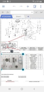

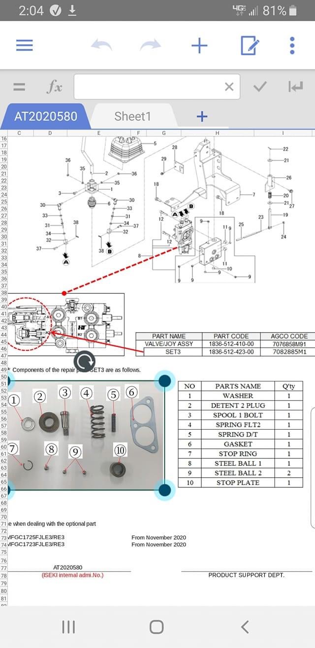

I found some info in a MF SCUT user group on Facebook. Apparently, according to a poster who works at a dealership in the Midwest, there is now a repair kit for this issue. He posted the following picture
The repair kit is labeled SET3 and the part number is 7082885M1. There was another comment below that one from a service tech at a different dealer who said he just received the same kit “today” (which was a couple of days ago) for a customer and he was about to install it. Maybe there is hope.

That looks to be an effort to directly correct a weak detent mechanism. A complete replacement of the assembly.

I have some new info from the tech who installed the fix.
"it's not technically a warranty thing yet... it may be in the future.. sadly not yet....dealer who sold it might be nice though and cover it maybe. we used it on paved driveway and it didnt kick out with that"
He said the kit was $150CAN

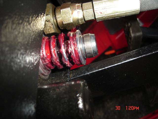

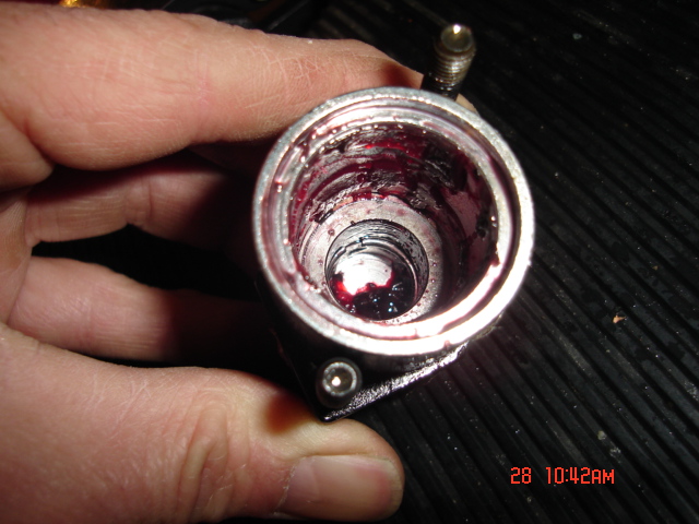

That looks like it might work -- when I first encountered that issue I took the whole thing apart to see how it worked. My conclusion was that there was simply insufficient pressure from the snap ring in the bottom around the mating groove in the plunger to hold it there... so maybe new/different parts in that area will fix it. (Note those pics were taken in 2008 -- not long after I bought my 2310!)
float detent ring.JPG float detent rod:groove.JPG
