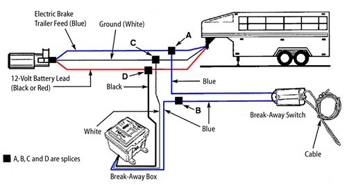

I just bought a 16' 7K trailer with 4 wheel brakes and the brakeaway battery kit. I never had a trailer with the brakeaway kit and I don't know what the battery needs, to be maintained. What are you using to charge your brakeaway batteries?
Thanks

Most breakaway switches I have seen have the charger built right into the box. The battery is charged while connected to the vehicle when the vehicle is running.

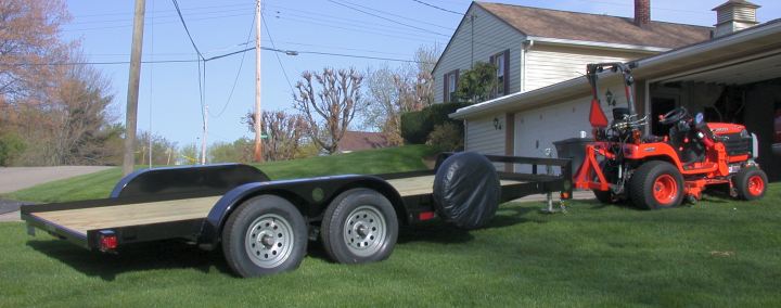

I checked my battery box and there are only two wires which go to the trailer brakes. I went to our local truck and trailer store and they had two chargers, one was $30 a small black box and four wires, the other was $15 and it was just wires with something small shrink wrapped in the wires (it did not look to good?) What kind of chargers do you use?
I will add a picture, I know how everyone likes pictures.
Thanks

The first step is to make sure your tow vehicle has the proper circuit to charge the trailer. If its a Ford you will have to install a relay. Its gray and came with the truck. If its a GM its a little more difficult. You must buy a Maxi-Fuse and hook up a wire. The wire goes on a stud for which the metric nut may or may not be supplied. If its another brand of truck give me a PM and I will talk you through it. No matter what brand of truck you should have 12 volts at the 7 pin plug using the 1 o-clock pin (+) and 7 o-clock (-) pins. Sometimes this is always hot. I do not like it this way. Sometimes its hot only when the truck is running. This is a better setup. Check this site for info.
R and P Carriages, Towing and trailer help questions
As for a charger you really do not need one. You can just hook up a positive and negative wire and it will work. The $30 unit you found is a smart charger and prevents overcharging but I have never seen a battery overcharge with just hooking wires up. The $15 unit you saw is more than likely just a diode to prevent back-feeding the truck.
You may already be hooked up. When I wire a break-away I only run two wires to the battery making the connections in a junction. To check first assure you have 12 volts at the pins I mentioned above then unhook the battery on the trailer and plug in the connector and check the two wires for voltage again. If hooked up you will have 12 volts.
Chris

Chris did a great jog explaining, much better than I did. I have a Ford so I did have to add the relay. The relay energizes when the truck is running.
BTW That's a very nice looking trailer.
