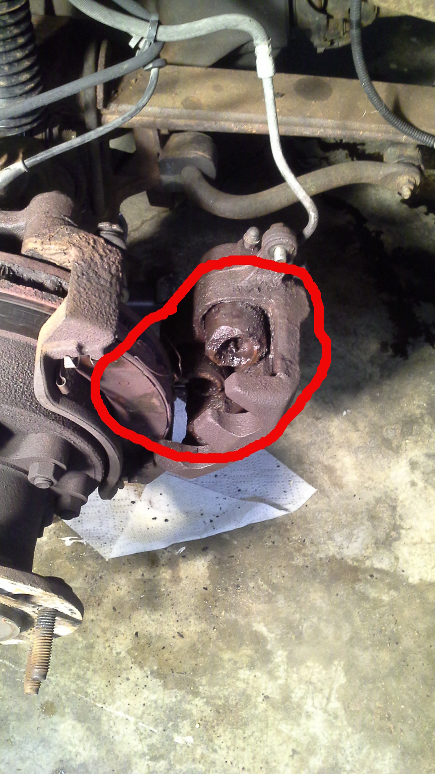

Caught some road trash into a brake caliper and it seems to have torn up a piston.
Looking at Autozone, NAPA, RockAuto, Fordparts they either list phenolic or don't say. O'Reilly's lists metal and phenolic pistons.
Is there some reason that most have gone to phenolic?

Cheaper. Simply that. Phenolic is a thermoset plastic that can take pretty serious heat, but if you are using the brakes hard (any serious road racing or towing) I would go with metal. FWIW

Thanks, that is what I thought. It's only $10 more.

worked in shop one time where we did only automotive light truck brakes anything with phenolic piston only got steel we rebuilt them in house saw hundreds with phenolic piston where piston got really hot and stuck out killing pads rotor and more and as stated before just a part of package the cheapen up vehicle will do same with steel but not near as often
Did some of them look like this?
