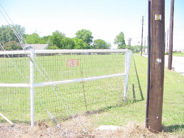

   / braided rope horse fencing #10
Afternoon Ron,
This picture is of a fence about a block from my home. I did it back in 92. What you're looking down is over two hundred foot of fence. It's a drill stem frame with two by four horse wire fabric.
The drill stem was in a pile on the property. My shop is down the street so one day as I was walking by I mentioned to the then homeowner (three back) that we could probably work out something on the installation.
The picture doesn't reflect it well but the fence is still straight. They have goats on it now. But some of the other owners have had cattle and horses.
I've see fences that were started and never finished where they set the posts and no one has touched them since. They are as crooked as a dogs back leg.
It isn't the fabric or the horses that make a fence lean. It's the poor installation. Livestock might rub on it and bow out the fabric but they won't lean over a well done fence.
If you think the rubbing is gonna be a serious problem, which I don't, then be sure and use V Mesh. If you want to keep them off the fence then do what some dairy farmers have found very productive. They stretch a piece of heavy gauge chainlink, at least nine gauge, preferably six. Just place two good well anchored posts in a pasture and pull the chainlink tight. You'll have to retighten it occasionally but it's the cat's meow for back scratching as far as cows and horses go. If you don't believe me sometime do a double take where some fool has used chainlink for livestock fence.
MAKE SURE THE CHAINLINK IS KNUCKLE KNUCKLE! It comes three ways, knuckle knuckle both ends tucked in. Knuckle barb, one end has the points. Barb barb, great for prisons etc where you want points on the bottom and the top.
