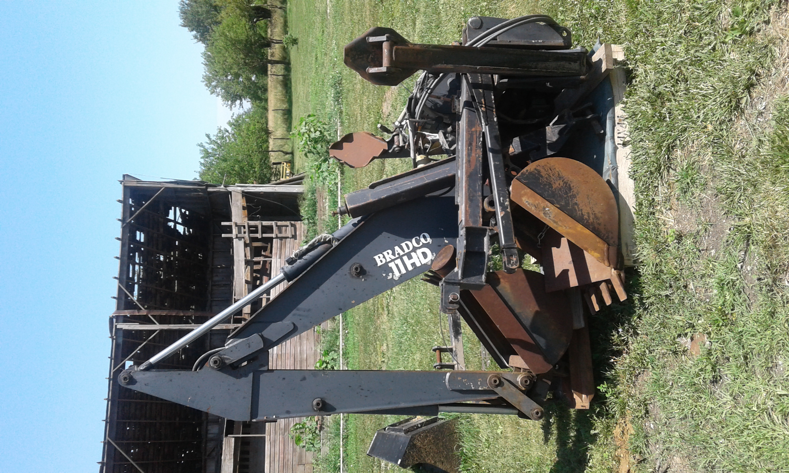

I have recently found a Bradco 11HD and am wondering if anyone has any pics of the subframe for there hoe's on a similar tractor(IE 5530, 6530 etc.)
I am just curious how many places they hook them too in order to not brake the tractor in half.
Was planning on a PTO pump to use w/ it. Manual says 9-14GPM @ 2400psi What is a good brand to look for that wont break the bank also how many gallon tank would be recommended and should I plan on any type of heat control oil I.E. oil cooler, fan etc.
I would really love to see some pics if anyone has the ability to do so, thanks.
Also, this came off a Ford 9030 Bi-Directional Tractor.
I can ask my wife to take some pics of the Backhoe if anyone is interested in seeing it.
Thanks for any help.

Don't know about any bolt pattern, but I have a 511 with the 14gpm PTO pump...you will need a hyd. tank that meets the per minute pump rate. My 511 came with a 15 gal tank. I don't usually have to have the engine run much past 1100 rpm to get all the power from the hoe that I need. I don't have a cooler on the unit. As you may be aware, the 511 is a "4 point" hook up to the subframe. I have to take off the 3 pt hitch to mount the hoe. Can you post a pic of a 11HD? BobG in VA

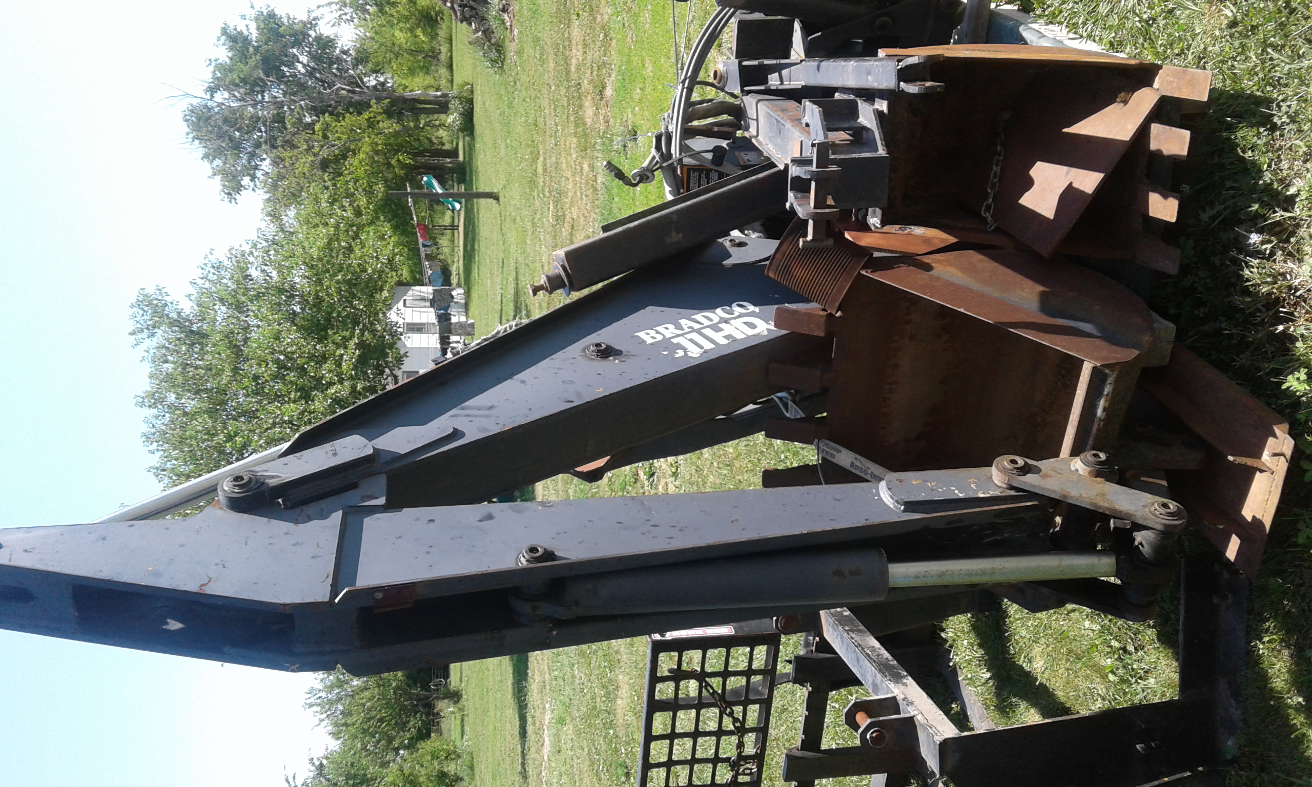

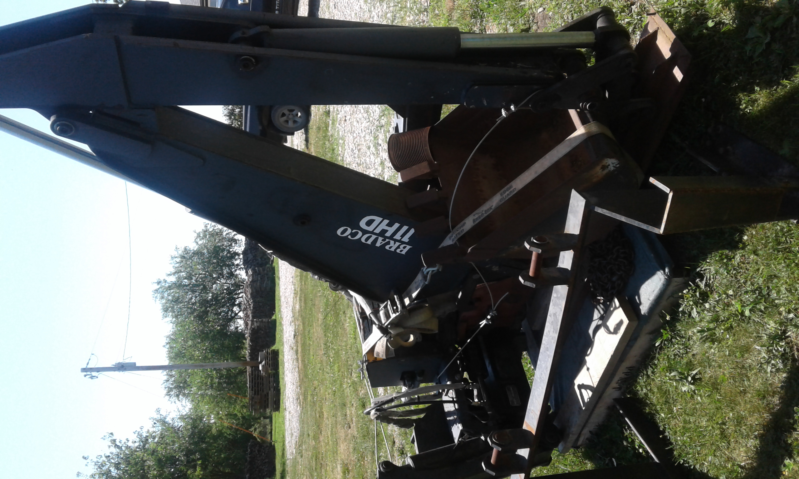

Here's some pics 20170720_115702.jpg20170720_115713.jpg20170720_115723.jpg20170720_115735.jpg
   / Bradco 11HD on a 5530 #6
Question: What did this unit originally come off of....? BobG in VA
As mentioned above, it came from a Ford 9030 Bi-Directional Tractor. I'm not sure if you can tell from the pictures but the hydraulic controls are ran by cables that are able to be put in the tractor itself. I plan to build a swivel seat and instead of getting off the tractor and back onto the hoe attachment I will have the controls right behind the seat for convenience or at least that was the plan!
