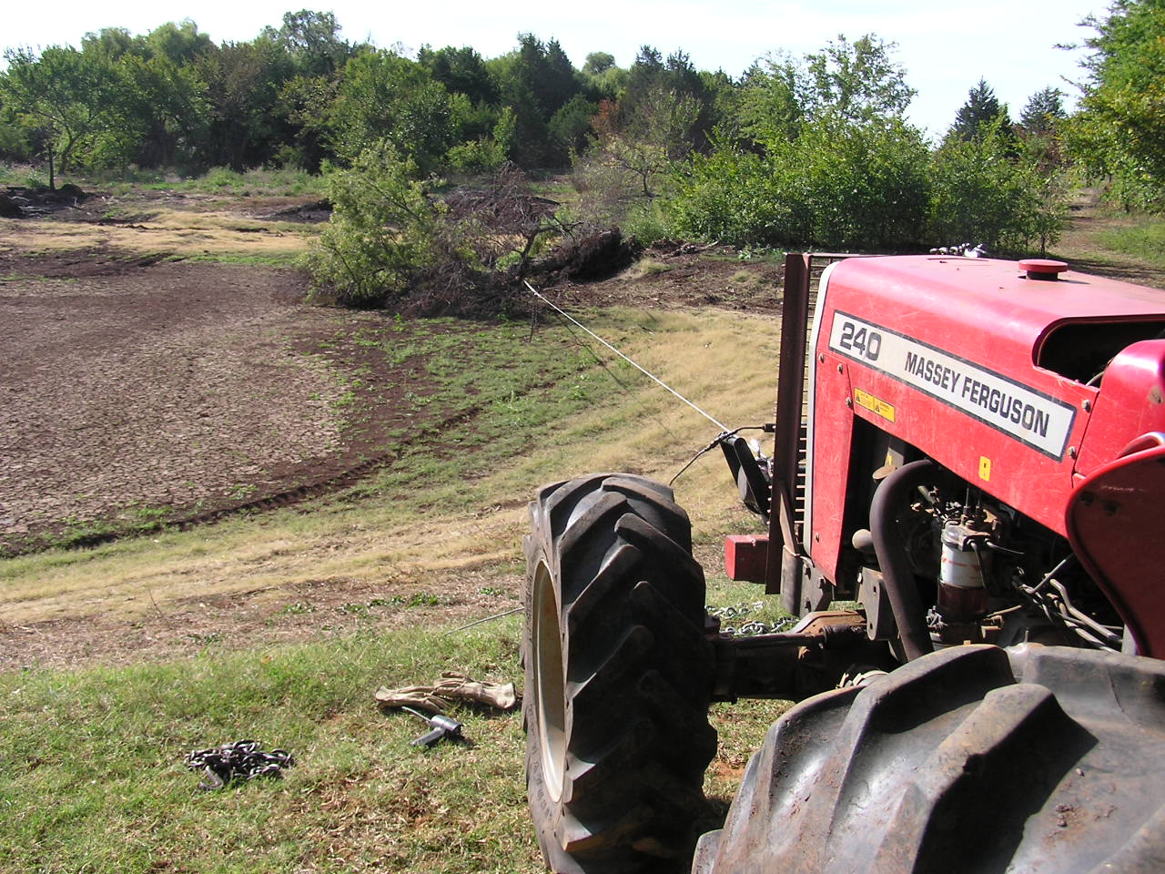

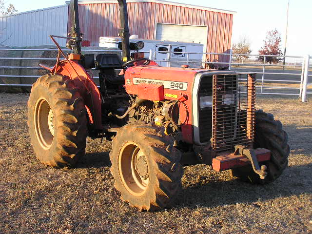

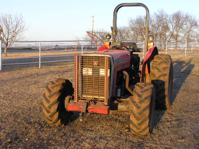

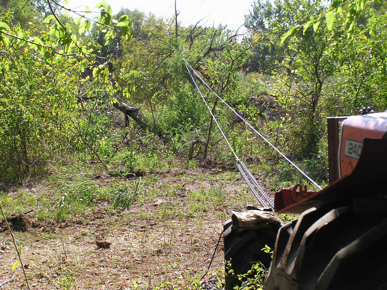

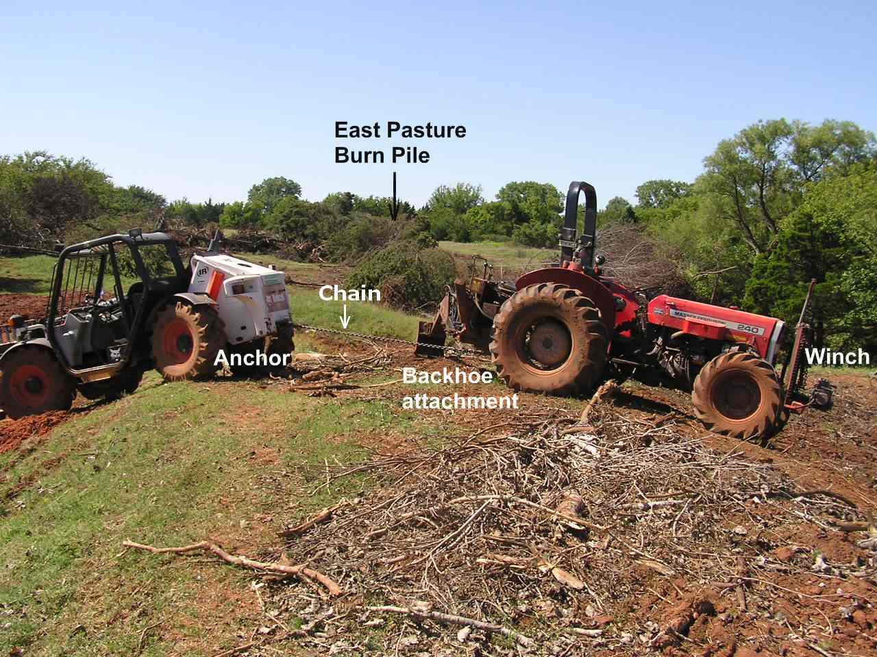

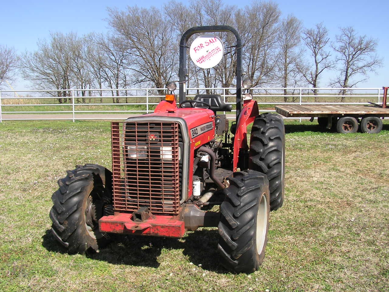

A front receiver hitch is very handy.
Used the winch a lot on this MF240.
Great for moving trailers too.
