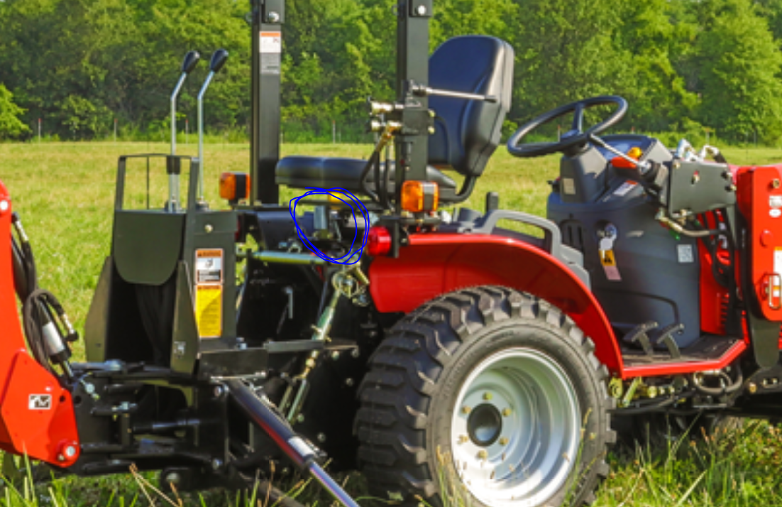

Which way is the bracket for the slow-moving vehicle triangle supposed to point? Up or down?
In the attached picture (from RK's website), it is shown pointing up.
My RK24 came from the factory with the bracket pointing down.
With it pointing down, it's in the way when I try to put the top link in the little hook hanger thing.
The top link hits the bracket and cant be placed in the hanger.
With the bracket pointing up, the seat hits it when turned around for backhoe use.
The seat in the attached picture also looks to be a little higher than mine, providing the needed clearance with the bracket in the up position.
Am I missing something here? :confused3:
How is this all supposed to work?

Most brackets for SMV signs have the opening facing up and you drop the sign post down into the bracket where gravity keeps it in place. If it's one of those brackets it won't even work upside down, at least not for long.
Normally the sign is pointing up and positioned right behind the backrest of the seat, or higher. It sure shouldn't be lower since it could be hidden by implements/etc. Many tractors have the bracket mounted to the seat back itself.
   / Bracket For Slow-Moving Vehicle Sign In The Way Of Top Link #10
I just looked at mine. The backhoe has never been off yet so the SMV sign is still on the bucket curl cylinder bracket. The bracket that you are questioning is wide end up so the SMV drops into it and held there by gravity. The top link hook is behind this bracket, but looks like it will still hold the top link with the SMV installed in the bracket. I'll try tomorrow and see for sure. Hope this helps.
