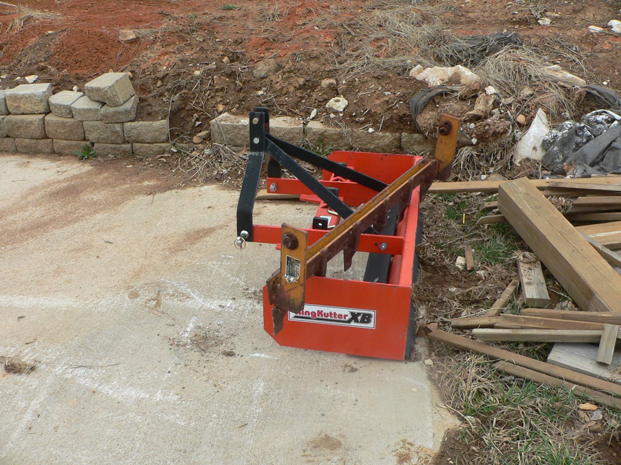

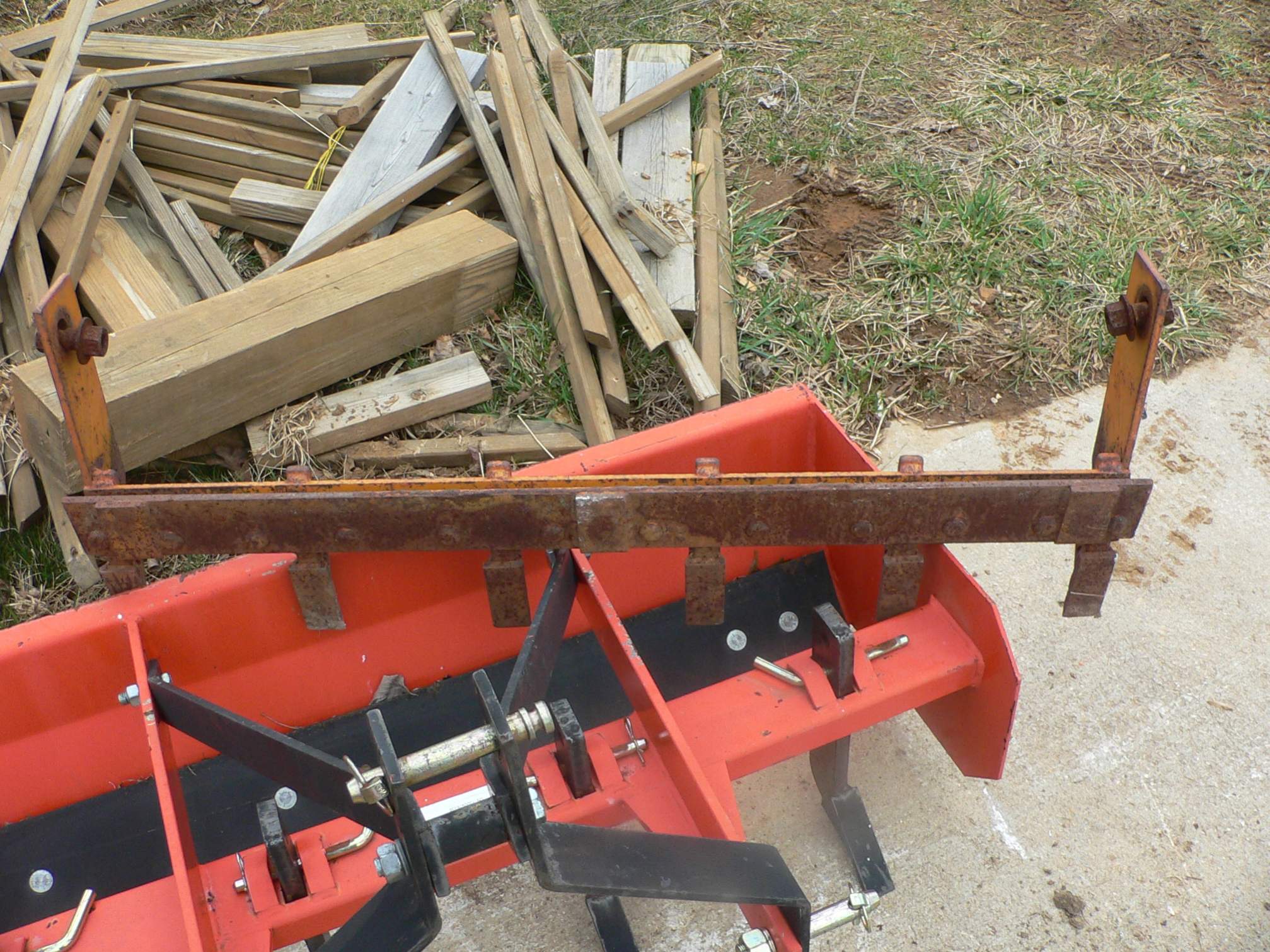

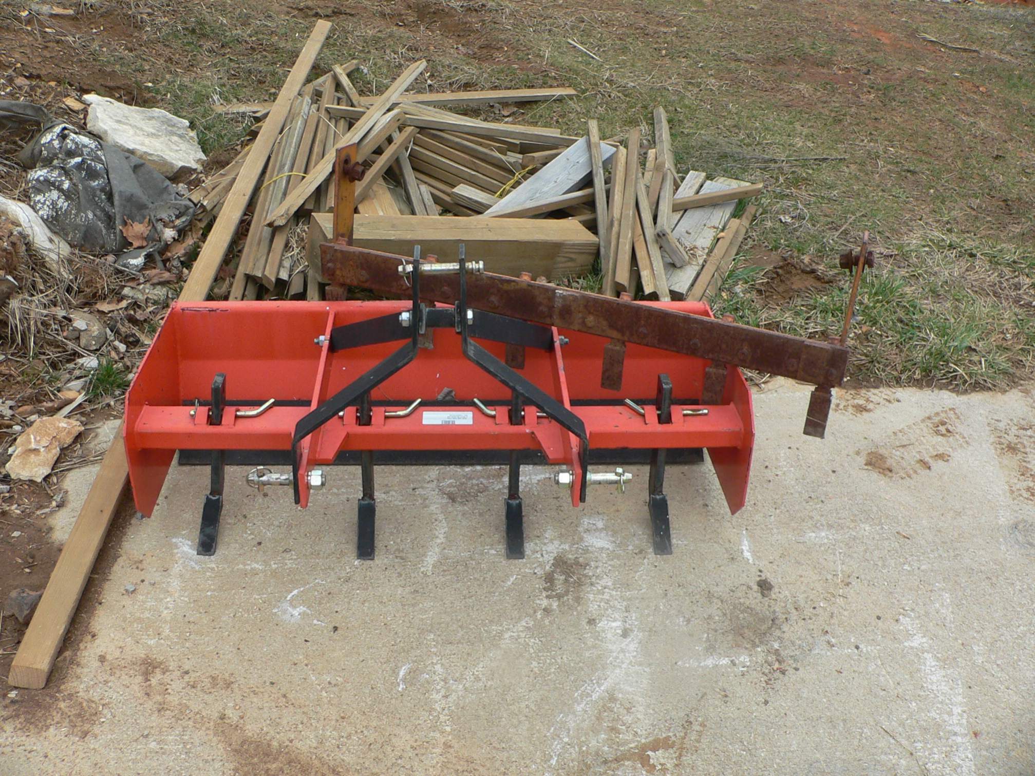

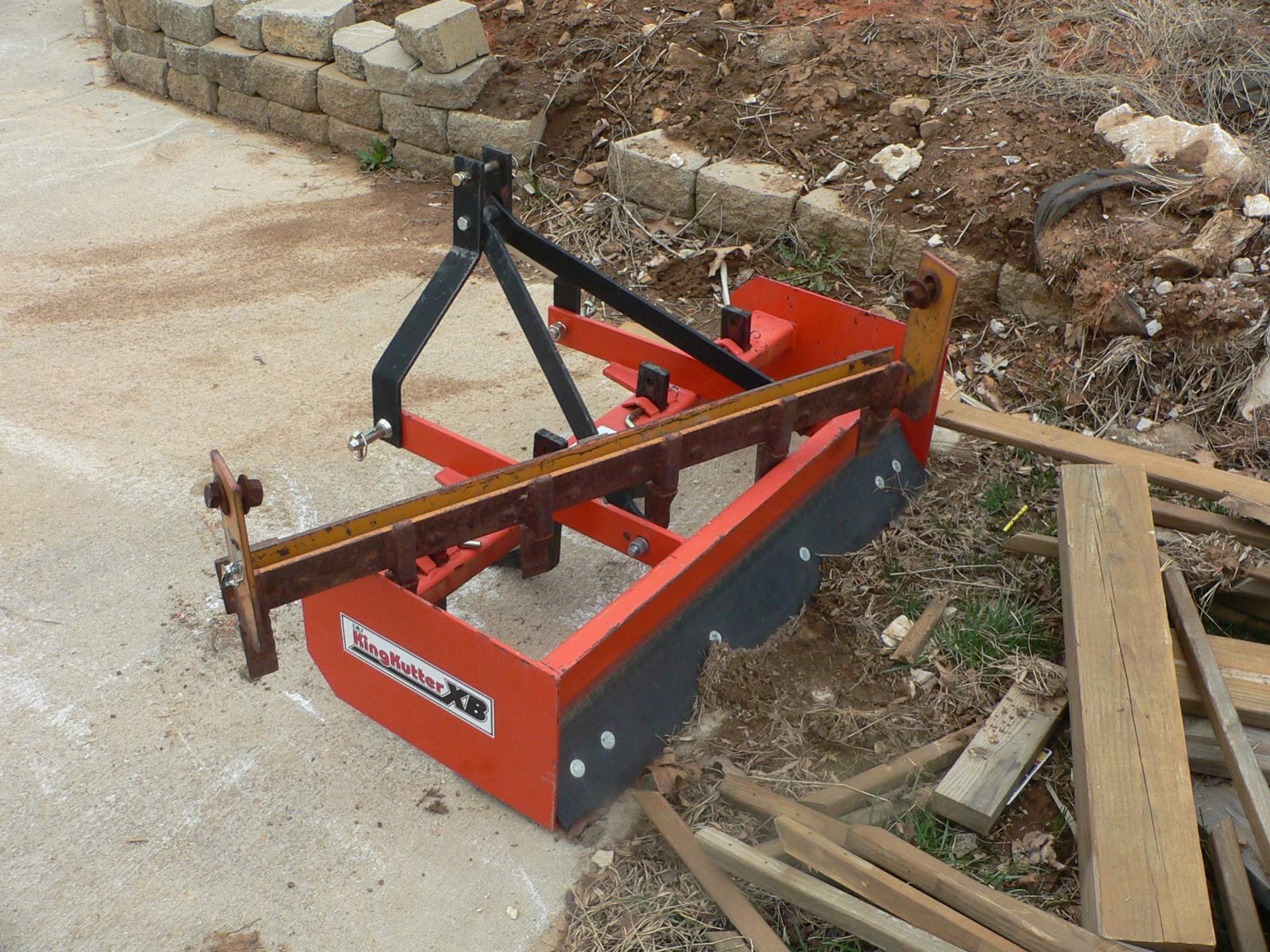

I sold this one yesterday for $150 or rather traded it for a single bottom plow. I paid $150 for it. There are bargains, scams and trash for sale on the internet. Check em out after learning what you need and what makes one better or as good as another one. A new boxblade at a store that's $150 would be a toy.

I got this boxblade, traded a plow that I didn't need, about a 3hr ride each way and a couple of hours of interesting conversation talking about tractors. I was afraid that JT's kubotaitis was contagous, and he tried to infect me with a little playing with his 2660. I'm ok so far, and I got a really nice attachment, looks like it's never seen dirt, I'll get to fix that in a couple of days.

I have the same box blade as MILKMAN. The first one I looked at was bent in at the lower
pins like it was put on a tractor that was to big for the bb. I went to another store and picked
up the same bb unbent and welded angle iron between the pins and all is fine.
