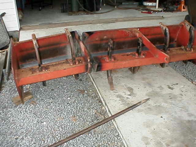

I had a 6 foot boxblade left over from the ford 2000 and after a little thought and trying to use it on the BX2200 I decided to cut it down to 4 foot so it would fit the bota a little better.
That was not the best idea I've ever had, as some of the parts of the unit didn't cut so well. But after a lot of melting and cutting and grinding and rewelding I now have a 4 foot box blade for the bota. You can see the 6 foot Steel bar laying by the cut boxblade. see photo

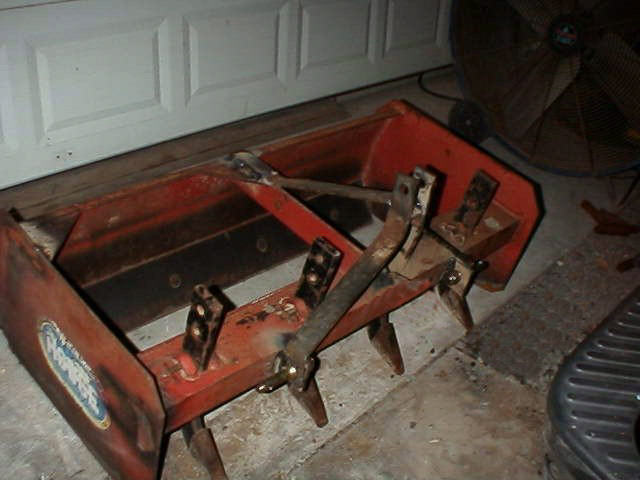

This photo shows it assembled as a 4 foot unit before painting
and I have found some Kudota orange and it now matches the BX2200

Nice job.... Looks like a brand new BB.... Do you know what the final weight was once it was cut down?
   / boxblade the barbarian #8
Nope. I don't have any way to weigh it, but it feels like I cut about 100 pounds off, The bota is a lot happier with it now.
