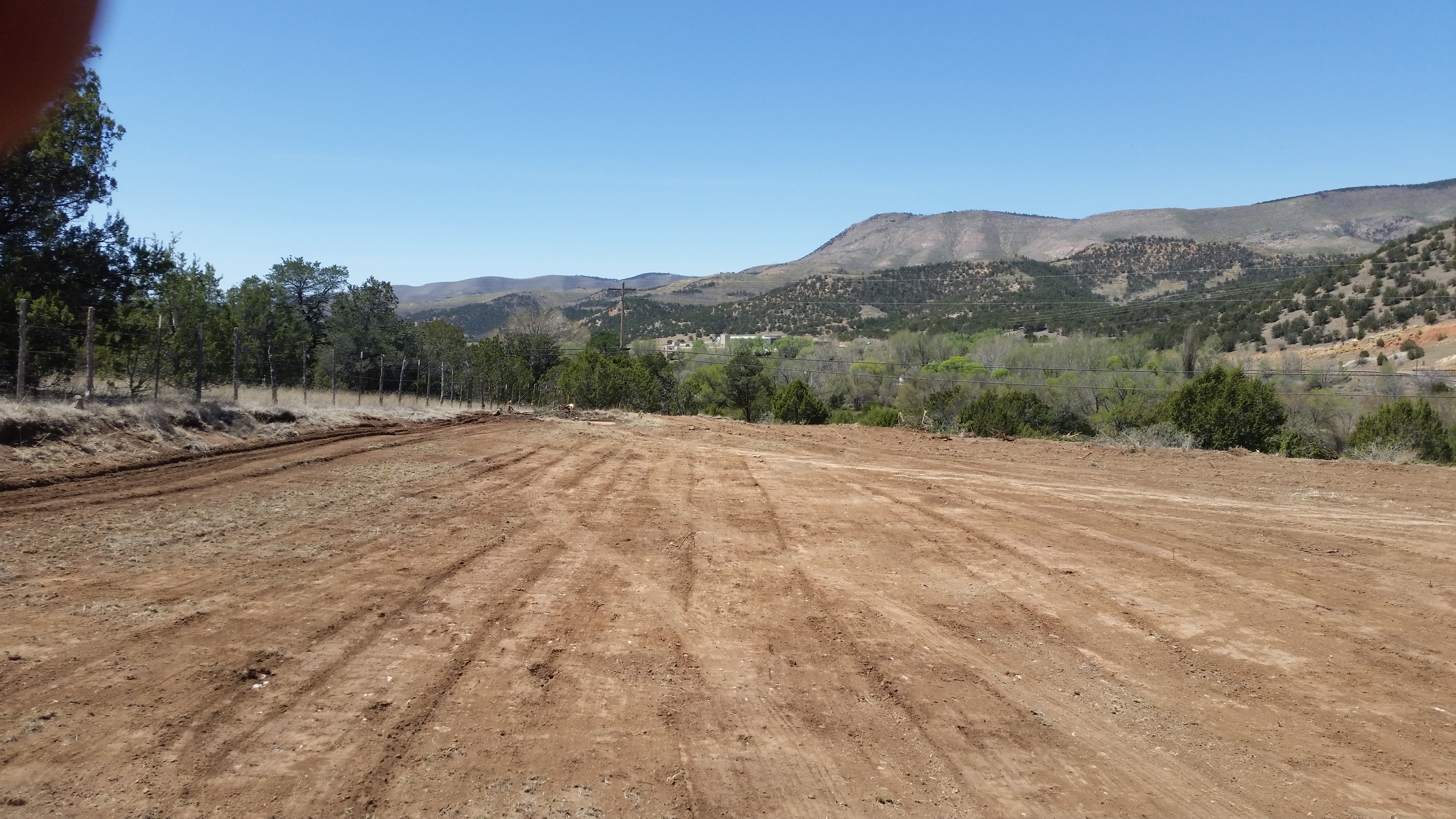

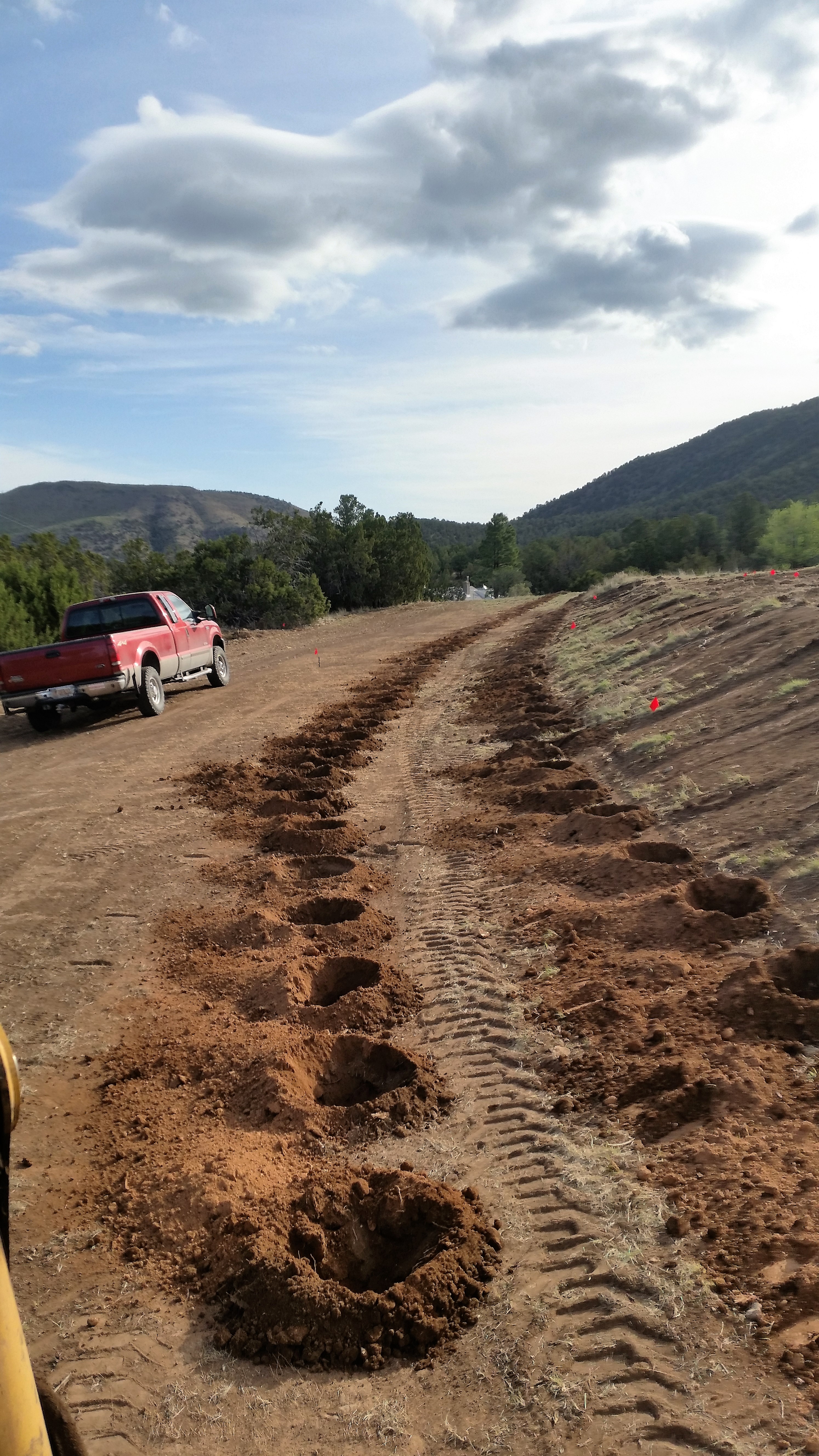

I cleared about an acre of brush and small trees a couple of months ago. Was not too hard to do about 7 to 8 hours work. The few trees that were over six inches diameter I dug out with the backhoe. I removed all the stumps as we were starting a vineyard.
A small dozer would be better for this work but I used the box blade in reverse and pushed the trees over. No bumping trees as that can bend up your 3 point hitch or worse. Top and tilt helps a lot as you can follow the contours easier than using a fel. Smoothed it up just a little and drilled about 1100 post holes for the vines.
