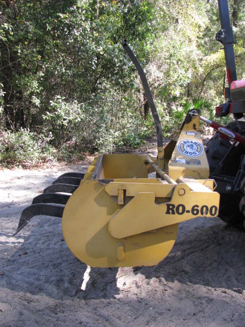

I have a gravel access road about 300 feet in length with no more than a 10 degree grade at any point under 1000 ft. above sea level in need of work. I also have brush I want to clear and turn into field. Everything I've read says my tractor should handle a 5 foot box blade without issue. Is that practical or should I really be looking at a 4 foot box blade? Here in NH box blades even used seem to come at a premium in cost so I want to get the right size for the job the first time.

Typically just a few inches wider than the machine. Too wide and you run out of traction plus it limits your ability to maneuver. Too narrow and your tires are wider than the blade- that makes working an edge less than ideal.

I have a 17 HP B series that is just about the same weight as your tractor...I pull the 60" version of the box blade seen below with very satisfactory results...
The rule of thumb when it comes to box blades is "the heavier the better" but in my opinion it is more important to buy attachments that are sized correctly for a particular class of tractor...

I've been using a tractor supply 60" box blade with my emax for several years. It's been a great implement. The lighter duty tractor supply version seems to be a good fit for the emax. I regularly maintain a 800 foot shared gravel driveway without issue. It's also a great ballast for loader work.

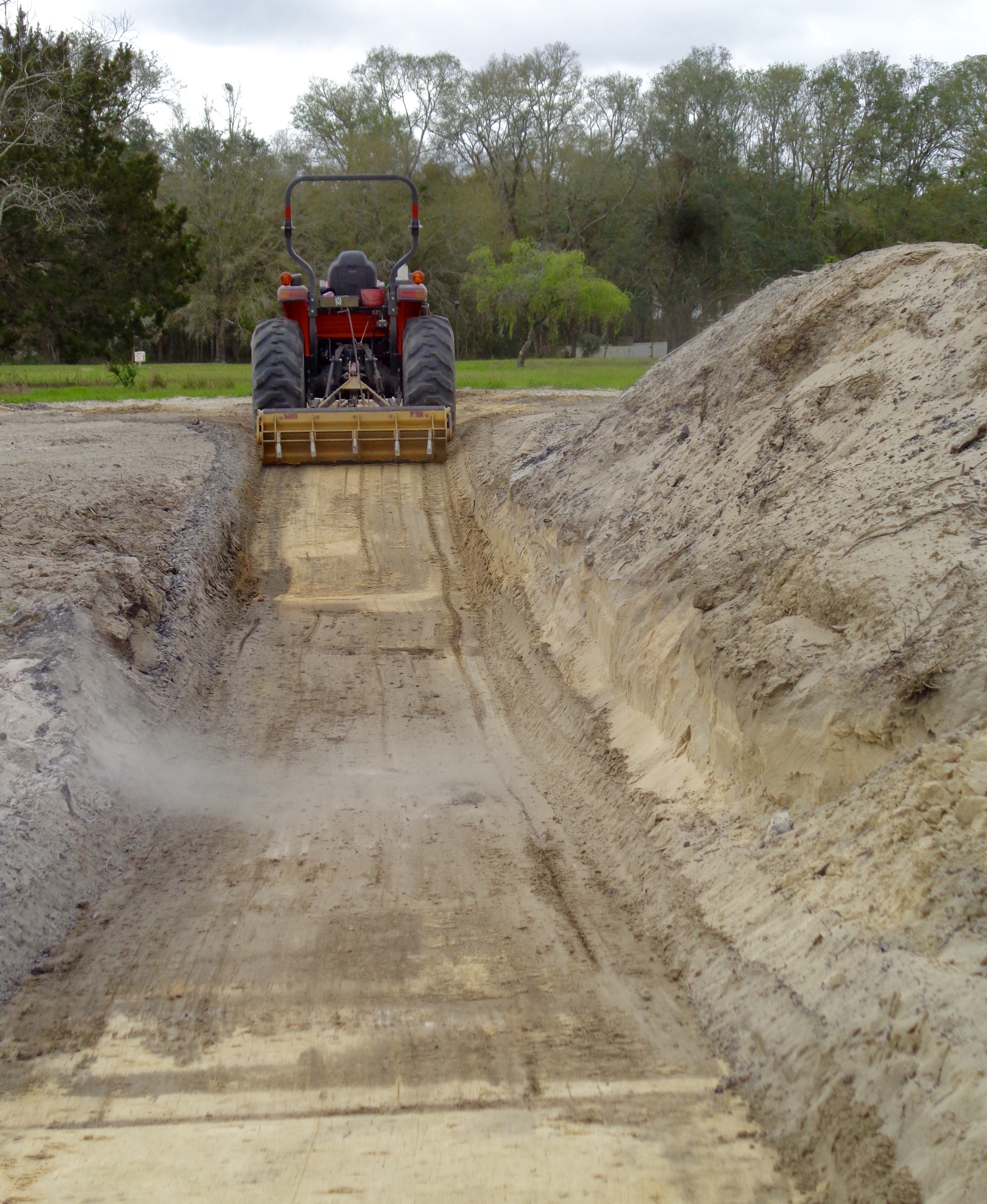

The Three Point Hitch provides no Down Pressure.
The pressure which determines how well a Box Blade will cut is determined by gravity, therefore WEIGHT PER UNIT OF WIDTH is the best indicator of how well a Box Blade will cut.
To me, 80 pounds per foot of operating width is the minimum. Others will disagree. I do not like to fool around drawing a Box Blade repeatedly over the same soil. I like to get the work done.
Buy the heaviest Box Blade you can afford, as wide as your rear tires are spaced, or 6" to 8" wider.

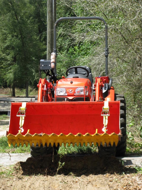

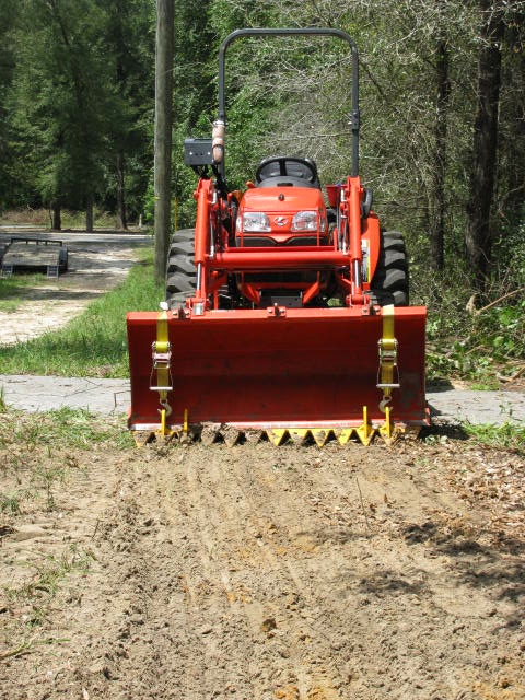

On light tractors I prefer a Ratchet Rake bucket attachment for grading and transporting soil short distances, relative to a Box Blade. For tearing out brush Ratchet Rake is far superior to a Box Blade. You can order a Ratchet Rake through TSC but their inventory is spotty. I recommend ordering direct from the factory.
Ratchet Rake, LLC - All Terrain Rake, Snow Edge, Tractor attachment, Bucket attachment, Loader, Skid loader, Kubota, Skid steer, Landscape rake, Brush remover, York Rake, Harley Rake, Rock Rake, Tractor rake attachment, Construction attachment, New Holland, Bobcat, Fire safety, Home fire safety, Fire prevention, John Deere, skid steer attachment, tractor implement
VIDEO: RATCHET RAKE GRADING - YouTube
6/09/2016
This post concerns Ratchet Rakes Vs. light Box Blades, such as the 60" Land Pride BB1260/346 pounds/69 pounds per foot.
I searched for the weight of Kubota L3301 bucket but could not find a number. I presume L3301 bucket weighs approximately 240 pounds, extrapolating from other kubota specs. 68" Ratchet Rake weighs 88 pounds. Adding 240 + 88 = 328 pounds, pretty close to 346 pounds of BB1260 Box Blade.
In addition, the (operator controlled) weight of the FEL frame bears on the Ratchet Rake. Likewise, weight of the Three Point Hitch bears on the Box Blade. FEL frames weigh much more than ( 3X? 4X?) Three Point Hitch components. So, including some FEL weight, I guesstimate that ground contact pressure on Ratchet Rake and BB1260 would be at least equal, perhaps greater pressure on the Ratchet Rake.
Further in Ratchet Rake's favor you have articulation of bucket/RR combination in two planes from the operator's station and 1-1/2" serrated teeth on the Ratchet Rake.
Box Blade can be raised and lowered hydraulically from the operator's station. Box Blade angle of attack is adjustable via the Three Point Hitch Top Link, but not from the operator's station. Standard Box Blade does not have rippers, standard is a smooth cutting edge.
Ratchet Rake is capable of tearing up sod with its serrated teeth, the initial operation in much grading. The Ratchet Rake will not pull as large a load as a Box Blade but it may pull 35% of capacity of BB1260 per pass, with faster cycles. Ratchet Rake is more intuitive in operation than a Box Blade, which requires considerable experience to operate efficiently.
This is why I feel the Ratchet Rake is superior to light Box Blades for LIGHT grading.
I own both a Ratchet Rake and a Rollover Box Blade.
When I have heavy grading to do, I mount my 60"/625 pound (125 pounds per foot) Bush Hog (brand) Rollover Box Blade on the tractor's Three Point Hitch AND the Ratchet Rake on my FEL bucket.

IMO Advising someone (especially a new operator) to buy an attachment that is not properly configured for a particular range of tractor size/classes etc. is bad advice...
With a little experience it is just as easy to fill a lighter weight (properly sized) box blade than a much heavier one of the same width...with a lighter blade the scarifiers make the difference...learning to use them in hard terrain is the equalizer...!
Learning to use the scarifiers to make up for extra weight of a heavier blade is very rewarding and not having to deal with a drag behind implement that you can't even nudge a tad when hooking up doesn't happen...
IMO without a hydraulic top link it is another story...normally once a bb has a full payload you quit cutting then rotate the blade to a neutral position and move the material to where it is desired then drop the load or roll the blade back to distribute and smooth the material...doing this without a HTL is a chore...
