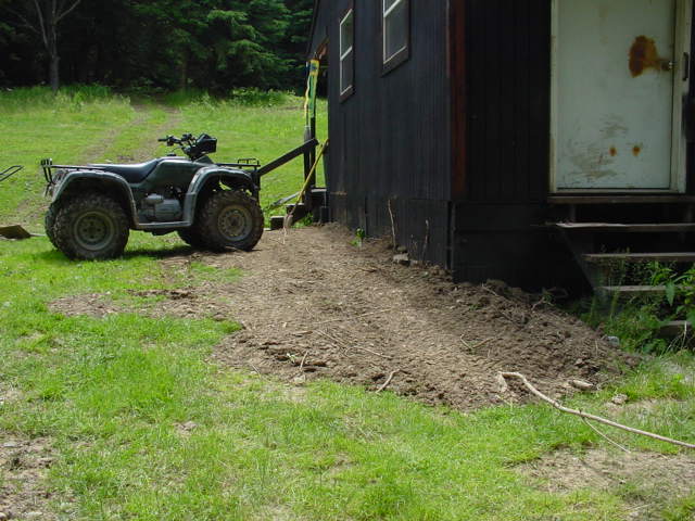

I have been using my box scraper, grader blade, middle buster etc trying to get my property @ my cabin in working order. Like they say practice makes perfect. After about 100 hours I'm still not perfect but getting better. Here's a link to my website to see the projects I've been doing.Look where it says tractor pics June 17 th 2004 and keep clicking the picture and it will go to the next one. I actually like using the grader blade. I back up with the blade down to help me level stuff. It seems the cutting edge doesn't get as aggressive when backing, with the blade in the normal position of forward scraping. The box scraper is the best for loosening up the soil and ripping the roots. Thats a real art to get the ground smooth.
/forums/images/graemlins/cool.gif
http://users.adelphia.net/~gizmo/
