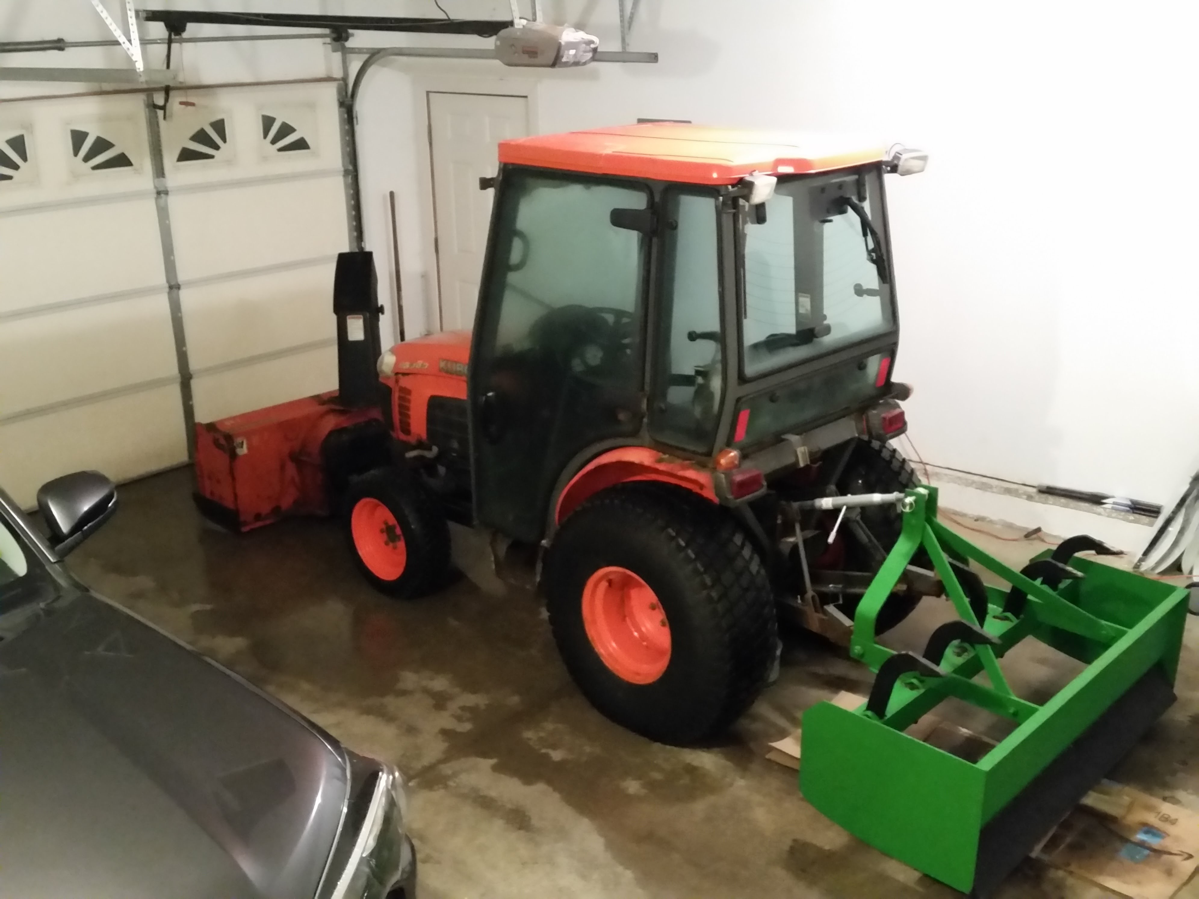

Now a L4060 had B2650
Am looking to by a box scraper I see every one using a 5 foot wide on the b2650. Is a 6 foot to big for a B2650 or not .If you get a 6 ft that is the same wait as a 5 foot is the 6 ft still too much for a b2650 .
Also looking at a 5.5 feet Walco .What do you have on your b2650 and how it working out . Thanks for info

I have a 5 foot box blade that came with my B3030 when I bought it. I have only used the box blade moving wet heavy snow slush, but I have had the box blade packed full and had no problem moving it. My rear tires are loaded. If your rear tires are loaded, you might be able to go to a 6 foot. How much work with a box blade do you plan to do where you feel a 6 foot would be more useful than a 5 foot? I would rather have enough power to use the 5 foot at max capacity than try to under use a 6 footer.
   / Box scraper for b2650 whit cab #3
I feel 60“ is the largest I would recommend. I have a 60” on my B2650 ROPs. Fully loaded with damp material it can almost stop the tractor. The manual recommends a 54”.

In my opinion, anything over 60 inches is going to anchor a B series. Not from power but traction.
I have a 66 inch behind my L2501 and there are times it will stop me. With a full box, I am scratching for traction. And my tires are filled.
If I recall, the small L weighs 1000 lbs more then a B.
Need Jeff to chime in on the weight to be sure.
I would suggest buying what Kubota recommends for your tractor.

I have a five footer on my B2650 and it pulls ok in my soils and I would not go any larger. Mostly, I use a landscape blade because I think it does a better job, it just takes more passes and cross passes. What do you want your box blade for, a specific project or just general use?
