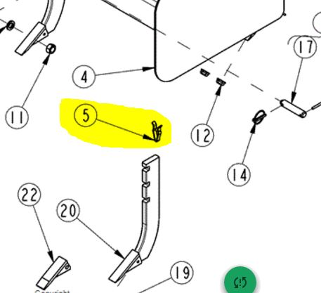

I have the box scrapper and ripper teeth/scarifier shanks shown in the attached pictures. I believe the scarifier shanks go with the box scraper but I am not sure.
I know that "keeper pins" are generally used to keep the teeth in place but for these teeth and box scrapper what holds the teeth in place?

Hi there,
This looks very much like the retainers on my Land Pride.
Check out item 5 of this parts list:
Error
the notches in the scarifier engage the front of the slots in the frame, then you squeeze the retainer in behind it with a pair of Channellocks.
I hope this helps!
   / Box Scapper and scarifier shank question #3
BTW that's Land Pride P/N 305-111D if the above link doesn't work.

Thank you all on your replies. I'm pretty sure the ones to use are the 305-111D's. I went out to Land Pride and looked at a couple operator manuals and they had pictures showing the clips in place.
Thanks again!
Gary
