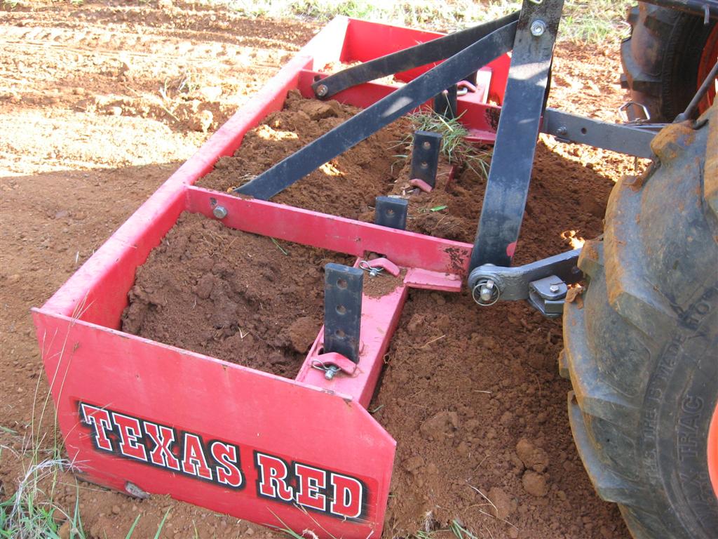

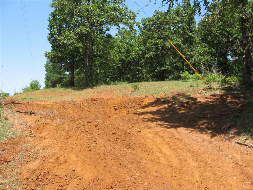

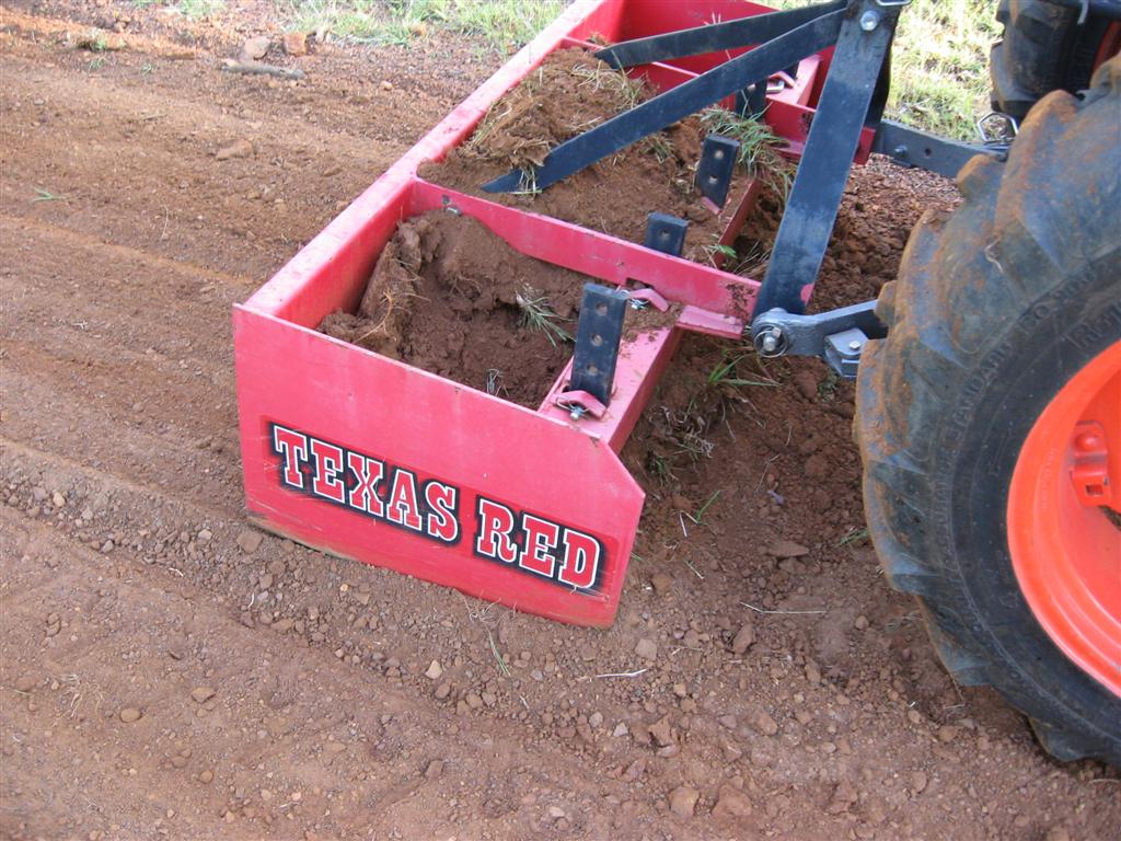

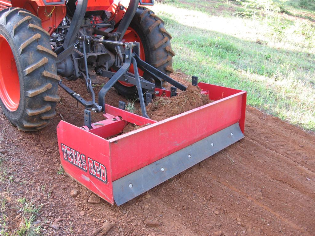

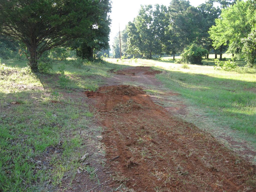

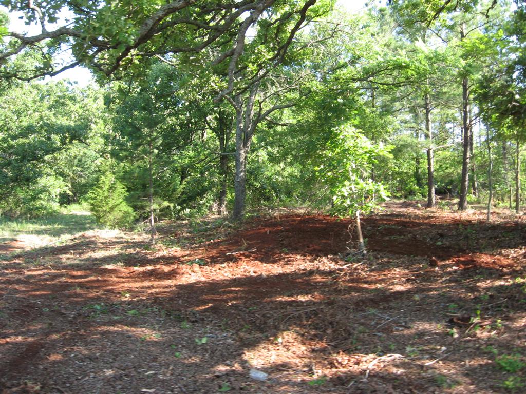

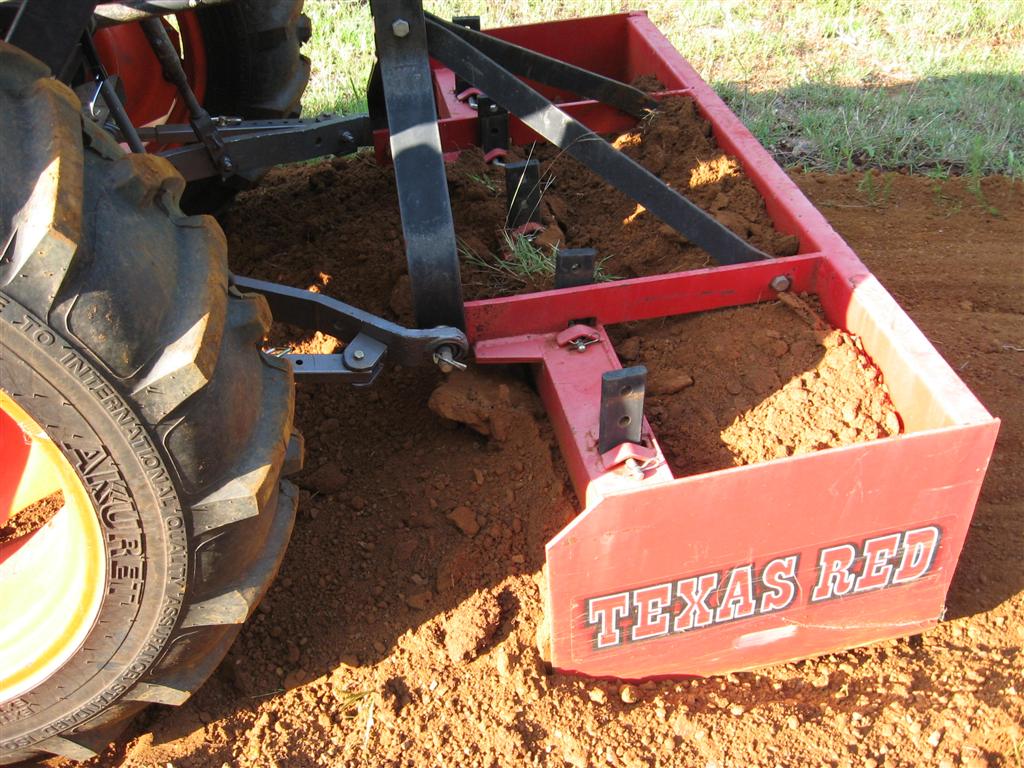

Question always comes up, BB or rear blade. Here are a few shots from this weekend.
BB will level out nicely but as you can see in a couple areas I needed to move the dirt from one location to another. In this case about 100' or so to some more washed out areas. I also filled some huge ruts in the road on the hill part. Forgot to get a before pic, some were over a foot deep.
But I can load up a BB that my L can't pull it. That is my $300 5' Beg Red BB there. I had the scrapers down just a bit, and for the finish stuff I really had the box set to far forward, to lazy to change out. We'll see what happens after the first rain.
The hardest thing about messing with a BB is knowing when to quit. All this playing took about 40-45 minutes. I could have spent 90 minutes just messing with it. I wanted to mainly fill the ruts, and divert the water off the hill. We'll see.
Could have not done this with a straight blade...
Enjoy the pics..

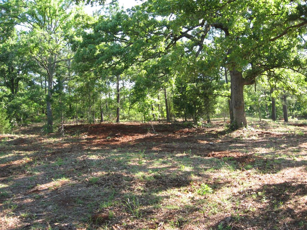

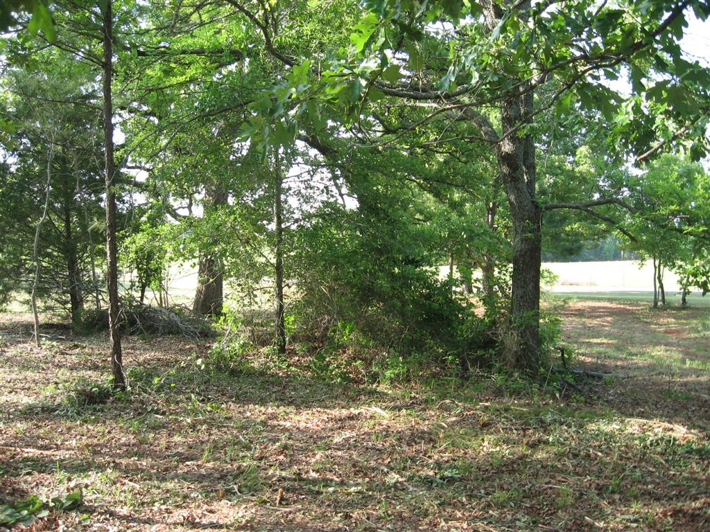

Here is a couple more of some BB work. I didn't get a good before shot here either. The clay mound in the middle was covered with small elms and junk. I couldn't get over it with the RC last time out. The BB would cut or pull the elms out of the ground, and other junk. I then leveled off the hill enough so I could mow. to level I just rolled over it and dropped the BB and took of what I could and dropped it quickly to flatten out the mound. Once I did get the BB cought on the hill (the steep side) and had to use the diff lock to get moving again. The last pic is sort of a looking down the hill pic from 2 weeks ago.
I dropped the junk in the same pile, then used the BB in reverse to shove it into the woods where I have no intention of clearing. It'll make a good rabbit home!

Great pictures Rob,
Looks like you had some fun seat time lately.
Also interesting that your boxblade has the name of your Texas red dirt on it.:)
   / Box Blading pics
You bet, for $300 it could have been painted pink.
That's east Texas red clay with native iron ore gravel mixed in. The best road material around and it's free!
